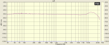

AP measurements
Here are some measurement on the AP analyser of the MPP.
Distortion is under the noise floor at 1 kHz and 1V output.
The noise shows a lot of 50Hz harmonics. We had a hum problem we could not quickly remove. Nevertheless you see that signal noise ratio is -80dB in the midrange improving to -90dB in the treble. Not bad, i am happy.
Also the transfer linearity is shown. Overload margin is ca.20dB at 1kHz for a 0.5mV input improving to ca.40dB at 20 kHz due to the way i implement the 75 usec time constant. This is no world record but the improved margin in the treble will make shure that there is no overload due to scratches and dirt on the record that are the major cause of overload in designs that have no satisfactory overload margin in the treble.
