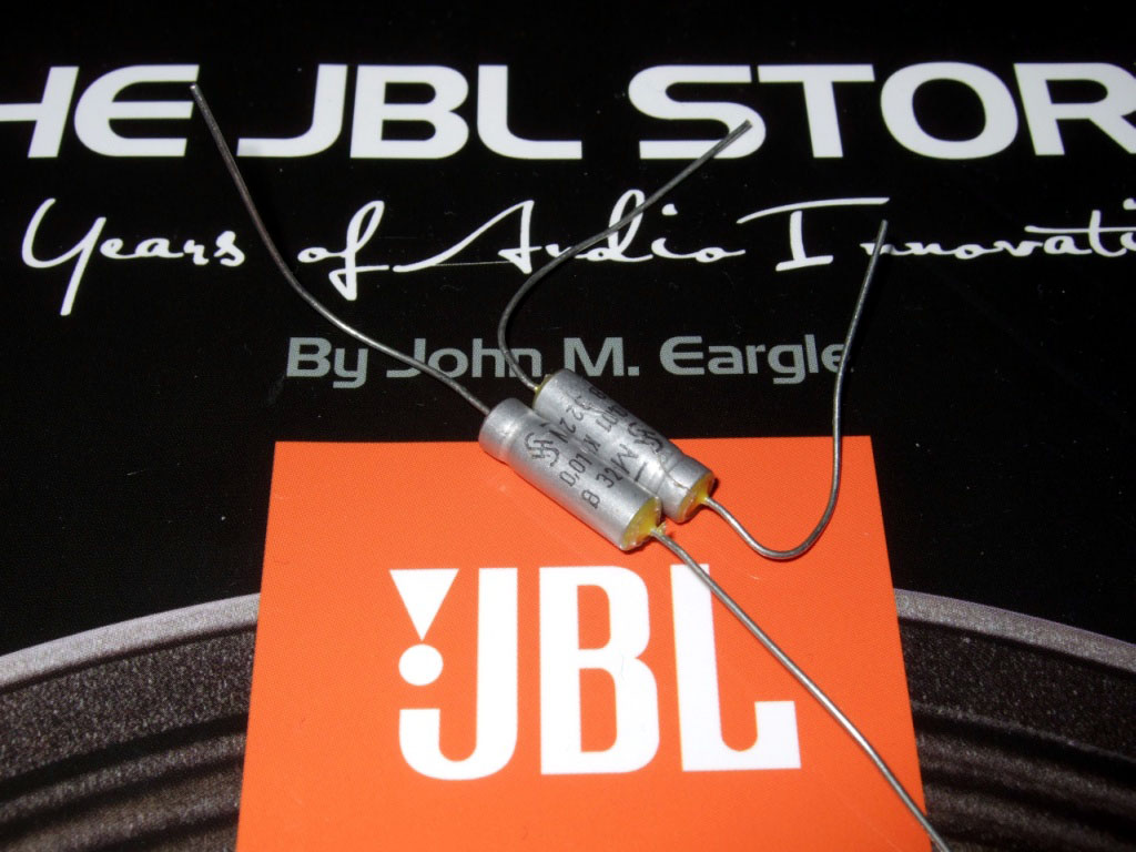

I did the 10nF shunt on input load experiment.
Report:
1. It surely changes things.
2. Negatively so with my phono and cart. Cuts a lot of instrumental presence and detail, and breaks coherence. No less HF per se.

1. Check with 1n-3.3n silver mica and PP also. Not in my hands right now, but not far. So to follow your 5.5R and 10n relation with my 14R generator.
2. Use them 10n at the ground side of the input sockets straight to chassis, so to help clensing some gremlins possible to be coming in riding on the cable shield and listen. Best there would be COG ceramics with sort legs.

Did #2. Beneficial. Less background hash, tone untouched.

I got that idea to ground very high frequencies at the input since the 10nF across the load worked against your results with my cart and phono and I thought they might be useful somewhere since I cut their leads enough, so I used them in the same notion we RF bypass a ground lift resistor. No special copper ground rod opportunity for me unfortunately. Ceramics at the input ring to chassis is an old tube practice in low level inputs. MKT in my case but my phono isn't that wideband anyway.🙂

yes you are right, you can put the cap where you use it. i do that on one of my pre-pres that has a floating supply and does not like a direct connection to the chassis.
whatever with a little patience and inspiration special grounding techniques can make a big difference i think it just needs a little empiric experimentation because it`s hard to predict although syn08 whould argue otherwise on the other hand my turtable setup should eat his vpi for breakfast ( oh, that was not very polite, sorry syn08)
