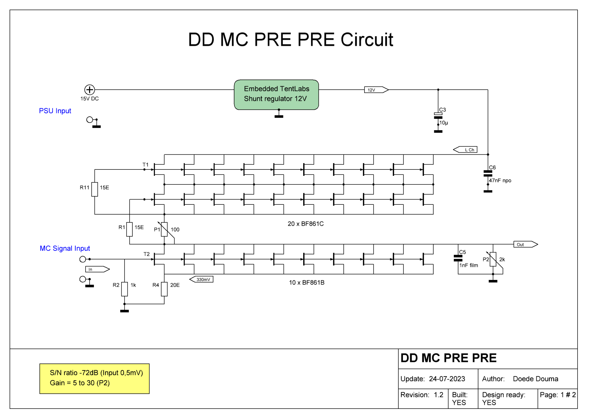

I found this circuit and made my own version.

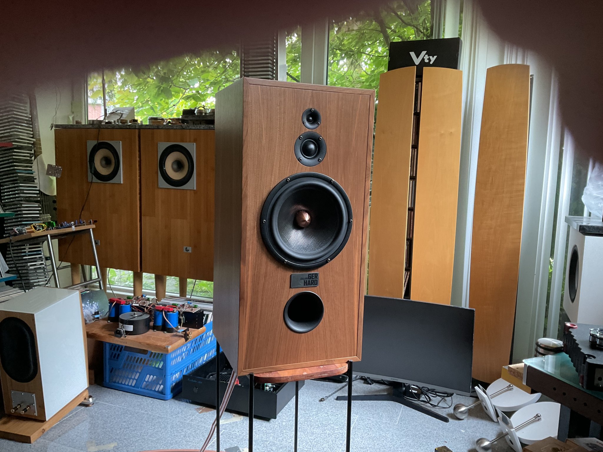

This is a monitor speaker. It is called the M44SL. The woofer is made by SEAS to my plans. It has a titanium voicecoil former and copper in the gap. The bigger tweeter is a Wavecor with Tetoron/Graphene membrane. The super tweeter has a 13mm membrane.
The tonal balance is neutral and somewhat brighter then typical English monitors based on BBC designed. Still there is very little fatigue because distortion is so low.
