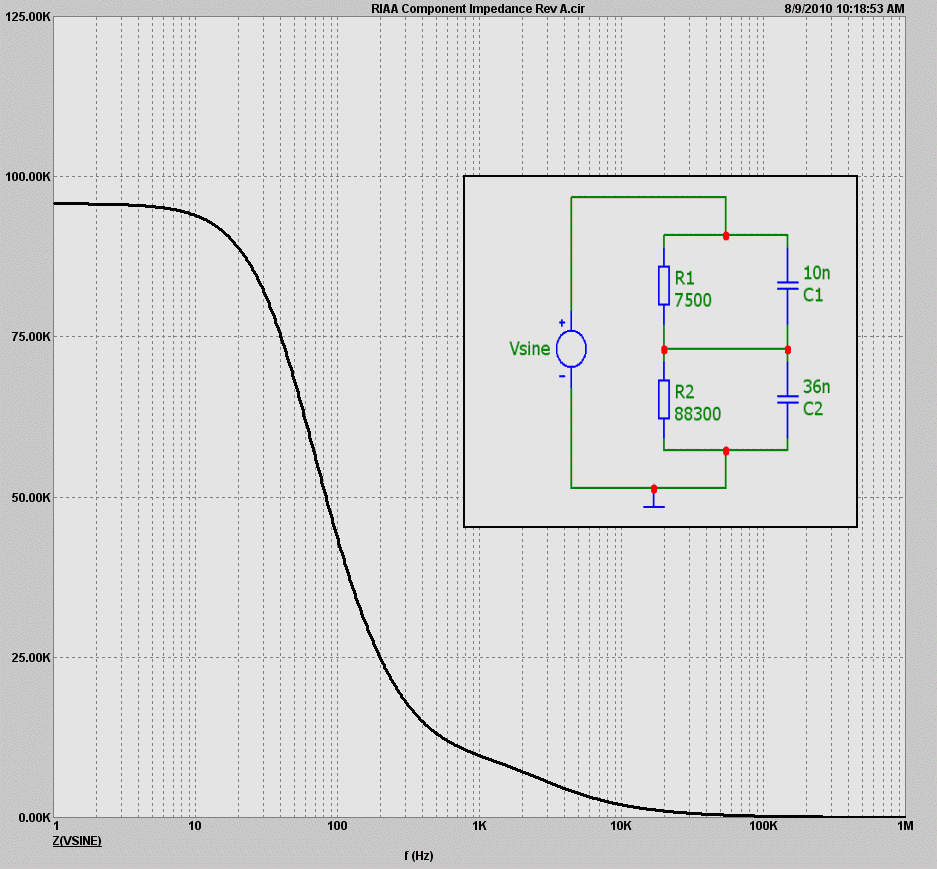

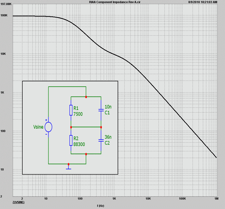

I was asked how much gain that circuit has. Well if i asume that the cascodes just put thruw the gain of the input stage and the the mirrors are high impedance enough we could simplyfy and say that the gain at 1kHz is Gm x RL. See Sigurd Ruschkovski´s simulation of the input impedance of the RIAA network used. It has around 9.8kOhm @ 1kHz and the Fets are running at slightly under Idss. That makes the equation 88mS x 9.8kOhm and that is 0.088 x 9800 = 862,4 . That is slightly under 60dB and this seems to be about right. To raise the gain the impedance of the RIAA network has to be raised
or the amount of Fets has to be doubled for example for 6dB more gain. The BC550C and BC560C are not very happy at 32mA idle so i whould use something more robust here. Be aware though that higher power trannies often have much less Hfe so the impedance of the mirror goes down. Now my choices get more clear i think.

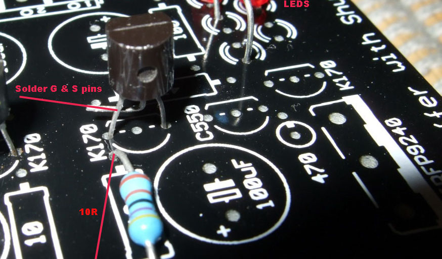

Can one board of Hynotize supply both channels ? Your answer was not totally clear about that. I have another empty board so i could try double Mono if one board is not enough. Could you post a circuit with all the changes i have to make ? Sorry, that gives you some work to do but i am teribly busy at the moment. My buffer is still not working and Martina comes soon and i have not finshed the complicated cabling. That is parallel to my profesional things i have to do to survive.
Step 1. See that picture I attach. Locate the K170 pictured near the 10R on the positive reg side (where IRFP9240s are associated). Cut mid leg board level, lift, solder as in photo. Don't change anything on the negative side.
Step 2. Use 33//33R 1W resistors where it says 68//68. That will run approximately 120mA per rail. Check the heat on Mosfets when feeding the phono, should still be comfortable, else use small sinks on each one. Don't power it up without the phono connected if not heatsinked. Keep them reg and phono intimate with short wiring.
That will be the fastest since you are busy. Just setting it right with no or minimum sinking.
You should get around +/- 16.5VDC on those caps then if trafo is winded precisely. If your caps are OK too, I leave you work. Good luck with that combo soundwise, hope it will prove synergistic. If your 5 leds rows are near for Vf and those near 10R located K170s near for idss, you will get a closely tracking +/- Vout too. If you have small clip on heatsinks or those small ones for LM317 with a screw hole that need no board fix, use them for long term peace of mind.

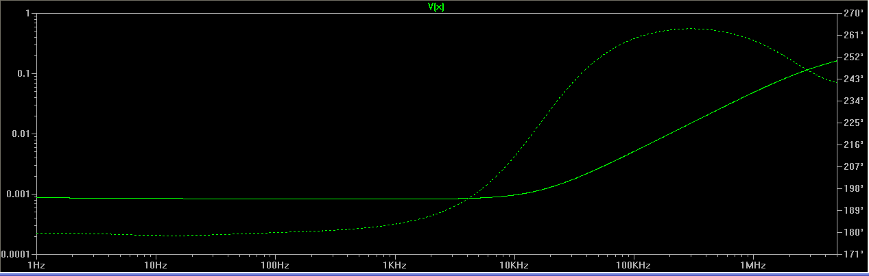

Although a Hypno board carries the most humble of this regs family, here is how yours with the settings and load you put, simulates in LT Spice for Zo. Use short thick wiring so you compromise it the least possible since there is no Kelvin connection ability in this board. It was made to be used for the DCB1 part on it within cm distance. Y axis is 1 Ohm top.
