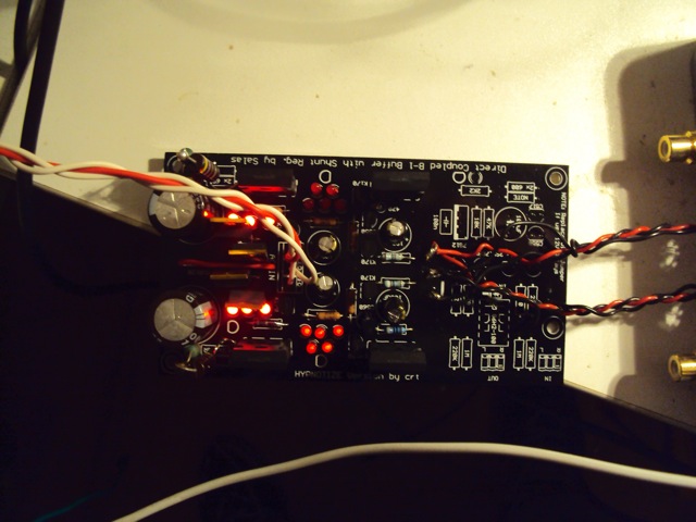

Actually they have around 16.2 Ohm and one side has a llittle tolerance. I will measure in 5 minuts. The Fets are quite warm but not hot after 15 min. I think 0.1V difference will not mess up my stage.
Its entirely up to the Vf of the Leds you used for Vrefs (5in row). If you want to match exactly it will be a drag now to select again, they are soldered.
1.678 minus and 1.601 plus.
103 & 98 mA per rail. You need 50mA per rail, cool split setting. Were those leds 1.7Vf spec?
The guy that sold me the boards at the Frickelfest for a rediculous low price gave me all the Led´s and Pannasonic 100uF caps for free so i do not know. Voltage got a little down now after time, maybe 0.1V. The Fets near to the input get a bit warmer then the ones at the ouput. I dicided to use my experimental stage instead of Martinas. It´s easier to modify and i do not destroy my long hours of work. The current draw it that stage is very similiar and i can work with shorter cabling. I have it ready in half an hour.
I measure slightly over 1V in both the negative and positive line over a 10 Ohm resistor so my estimate is spot on. I will insert the dummis then test and then take the shunt caps out.

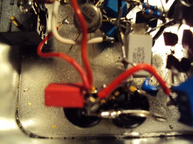

Here you see the shunt caps and how the Hypnotize is connected to the Phonostage.
So first thing is you mainly starved it. Thats 100mA draw per rail. The neg leds are dim since there is a something little left bcs that side was doing 103.5mA. Cut slack above consumption needs. You can use yet another 33R for instance if what you need now is really 100mA per rail and nothing else goes on.

i inserted the dummies, everything ok. i cut of the caps, no success. i put a scope on the lines. my resolution at home is only 5nsec and all i could see is a more or less straight line with some 2mV of indistinguished ripple. i measured AC over the lines with a very fast true RMS meter. 1.7mV on both channels. my meter can resolve frequencies to 1 MHz but the frequency counter shows nothing. when there is oszilation it must be over 40MHz. the phonostgae is one of my experimental stagess i can unfortunately not show here on this thread because it is nondisclosure work. many of my partners got very neurotic when they look at this thread. i have given away a lot of things that you normally do not see on a DIY forum but here i am crossing a fine line.
