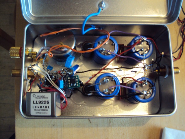

Before i build the Transformer-Inductive RIAA with the Josi i made an OPamp version as proove of concept. I chose the Lundahl LL9226 because it as 4 primary and 4 secondary windings so a lot of options are posibe. It has an amorfous cobalt core and after a discussion with Brian Sowter i am convinced that it does not have any technical advantage over a mu-metal core but a lot of people i respect tell me that amorfous core sounds more transparent. Anyway, a good Sowter whould do as well i think and i will compare a similar model from Sowter with mu-metal core in the future. I use the Lundahl with 1:10 gain with my Lyra Titan i. Then the Lundahl has an input DC impedance of slightly under 5 Ohm so will worsen the SN of the Lyra alone by only 3dB.
In noise voltage that means it goes up from 0.3nV/qHz to 0.4nV/qHz and that is excellent. For the Audio Note IO i whould use the 1:20 connection. Then the DC input impedance is slightly over 1 Ohm and that whould worsen the SN of the IO alone again by only 3dB. See a photo of my prototype. I will post the circuit later today. Sofar i do not use a zobel at the secondary, only a 47.5Kohm resistor. I may try something like 6.8kOhm and 200pF.

I am listening to the Transformer coupled RIAA and the sound is downright amasing. Very transparent and dynamic. Of cause hum and hiss are no issue here. I can hear no treble loss whatsoever. This Lundahl is the first transformer i heard that can compete with my electronic stages in terms of treble resolution and i had some very expensive ones here.
They all had an audible loss of transient behavious but not this time. I asume that the Lundahl must go over 100kHz in the 1:10 connection, a point where the cutter head is already 15dB down when i can trust the Neumann manual. It is not inexpensive at 207,-€ a pair i payed including shipping but it is worth the money. Other transformers cost even much more and are no better. At least i have not heard one. If the Sowter 8055 is any better i do not know but i will find it out. This listening experience was quite a shock after the Phonoman AC and i was seriously considering to build in a pole at 20kHz. When i looked again at the RIAA components i saw the desaster. I had connected two caps wrong so no wonder it sounded dark. Frequency response is the most important issue in High End design and when your Phonostage sounds sharp or dark it may not by the Opamps or choise of Components but simply a bended frequency response. I do not say that all components with flat response sound the same but it is a very important ingredient plus exact level matching when you compare the sound of two electronic stages. I am happy that i could trust my ears.
