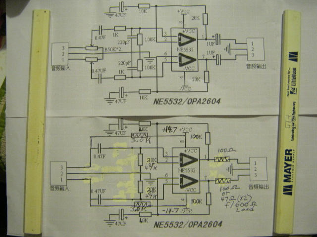

Post 3152. Pin 2 is ground, Pin 1 and Pin 3 are supplied with 3kOhm current limit resistors.
Both channels go into the positive sides of the opamps. After studying this i think my circuit will work.
Flavio is recommending to supply the cartridge from batteries for safety. See my modified circuit if you want to do that. Maybe over the weekend i find the time to modify the Gilmore EQ.
  • Strain Gauge Phono Simple Battery.TSC - TINA.pdf

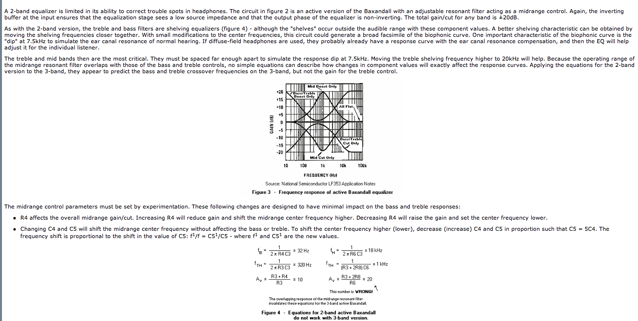

Yes, that equalizer will work with some modifications. Just shift the midrange EQ to 3kHz,
the bass EQ a little deeper and the treble EQ up to over 10kHz. As far as i can tell you should only change the values of the caps. So in the midrange you should use 1/3rd of the value that is given for example. Just put this circuit behind my input stage. You can take even out the inverter but then you have to revers your speakers.

In the active 3 way Baxandall resistors R1, R2 are much too high for my taste. They add a lot of noise. I think 10k is better.
When you do not change component values of the EQ stage you can mimic RIAA by fully advancing the bass EQ and fully pushing down the treble EQ, mid EQ in middle position.
A simple linear low noise amp in front of it would give you much of what the Tanzmusik can do. The first inverter stage could be redesigned as a Phono Clone and then you are done. A variable RIAA phono stage.
