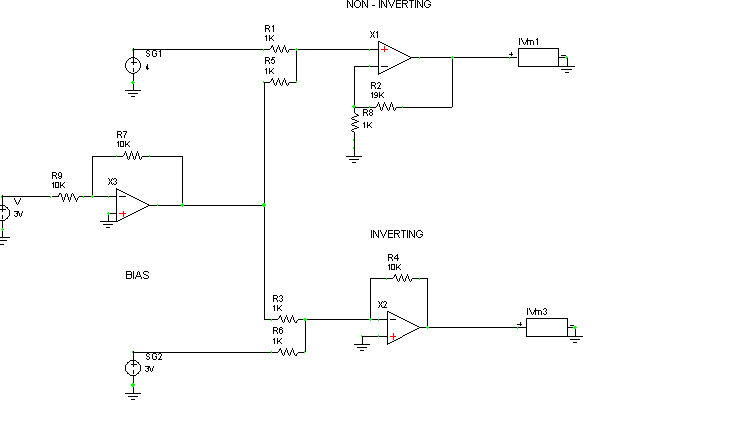

First you need a constant current source. That could be a J-Fet with source resistor or a current mirror for example. I assume that the cartridge has then to be AC coupled into the phono amplifier. The most easy way would be to use a good Opamp. If that works we could construct a discrete solution. Concerning the tone controls a strain gauge cartridge does not need much equalization because it has a 6dB/oct falling response by itself. That does not work 100% perfect so you can use your tone controls for fine tuning.

Do I need a delicate preamp, because of the relative high impedance 1000 ohm cart? The 3mV output is like a MM. Do you have a "simple amp" for this cart? I cannot make a choice. I like BJT s.
I want to use a good PSU like from LCaudio.
Yes, that should work and do not forget to reduce R6 to 800 Ohm. We need 4 V over the 1kOhm for 4mA. Interesting plot you send me. The cartridge has a presence drop and too much upper frequencies. I have not seen that before. In the deeper ranges that looks fine. The 1kOhm of the cartridge is not that uncommon and close to an MM. I have setup the Opamp stage so that not much noise is added. It has approximately a gain of 70 as you requested. I like to use BC560C in the mirror because they have high Hfe. Noise is more controlled by the emitter resistors but they are high enough so that the mirror does not inject much noise. You can use 3.3uF instead of 1uF. That will extend the bass somewhat but even a 1uF into 47kOhm goes to less then 20Hz.
I use the LC Audio PSU sometimes. It has only plus-minus 13V max. so you have to adjust R3, R6 proportionally. In Flavios stage i can not see how he generates the bias and where the cartridge is connected. In all the circuits i have searched on the web this part is left out as if it where a big secret only for the initiated. Maybe i have now broken the law.
Also Flavio generates a difference signal. Are the outputs of the cartridge out of phase or is that for Quadrophonia ?

I think I can reverse one channel of your SG schematic by changing from non-inv to inverting input, correct? If needed afterwards. Otherwise I should use separated supplies for the SG s, and reverse from there.

Did some web search about Left channel phasing, only left channel has DC reversal, AC signal goes to +inv or -non-inverting
Did some research, yes Flavio81 again, only Left channel is DC reversed, each AC signal goes to the +noninverting or -inverting input, (both amps)

Assume the stereo version is ment here
