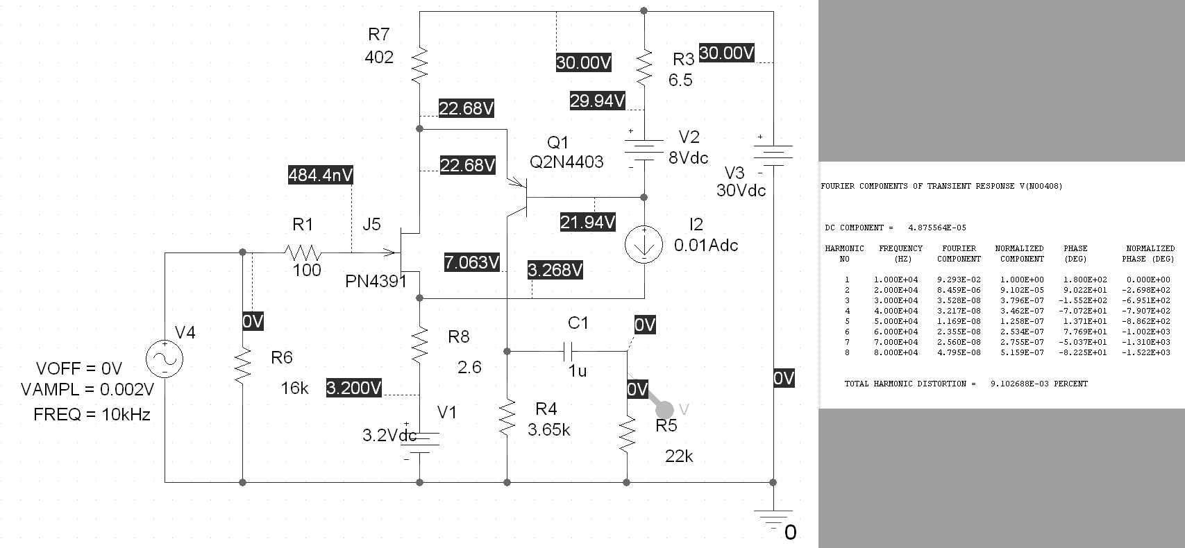

A circuit like this has been build before by a good friend of mine (Ronald) but in single supply from plus 24 volt to gnd.
This is an other kind of beast, working from plus to minus. I got to give it a try too. Thanks for your input

To be honest Jose`, that constant current source is not that good with one pair of Fets at the input. The resistors R3, R8 are only 0,65V / 0.008A = 81,25 Ohm. That is a bit too low for optimum noise suppression. With two red Leds instead of the second transistor it would be 2 x 1,4V - 0,65V = 2,15V / 0,008A = 268,75 Ohm. That is better and does not add noise from the current source. That Led current source has a somewhat lower output impedance though because you loose the feedback action of the two transistors.
Adding a Led, a transdiode or a diode into the emitters of T6, T8, you can raise the value of R3, R8 too. There are other ways. I think Elviee had a thread about constant current sources. He compared so many circuits that even i lost oversight. As far as i remember, a
simple Fet with resistor was hard to beat in output resistance. If this is the best solution for this circuit concerning noise injection i can not tell. I never tried it.

Joachim,
It's clear, I want to do things that are not quite favorable to this circuit.
That CCS is one of them and the other thought I had was to split R11 in two R's and connect a servo to that point.
I need to wait a bit until I finish the other circuit and then I'll go experimenting with this one.

Let´s see what i can do. The zener is only a place holder for a device that clamps the voltage. If that voltage is fixed the sources of the Fets drive the bases of the cascode transistor and the drains drive the emitters. This "double drive" is key for improved performance.
I have worked a bit on the latest circuit. It has now a very low noise current source with a bias servo. After a lot of Fet buffers here is a high impedance BJT diamond buffer. I think a conventional diamond would not have a high enough input impedance to be usable with the rather high impedance RIIA. I am still contemplating how to set up the driven folded cascode. One way would be a TL341 plus a constant current source.

Hi Joachim,
It's getting better and better.
I like the servo in this circuit and also the output stage.
It reminds me of the LISA II Headphone amp configuration. Only the LISA has two CCS in each chain (plus and minus).
