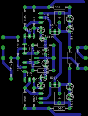

I did quick layout for BJT-FET linestage. I should have the PCB in ~2 weeks to test it in my DAC. Not yet decided if the GND will be a plane or just a wire...as well as missing few caps for V+/- decoupling.

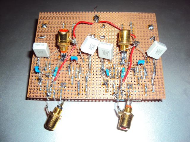

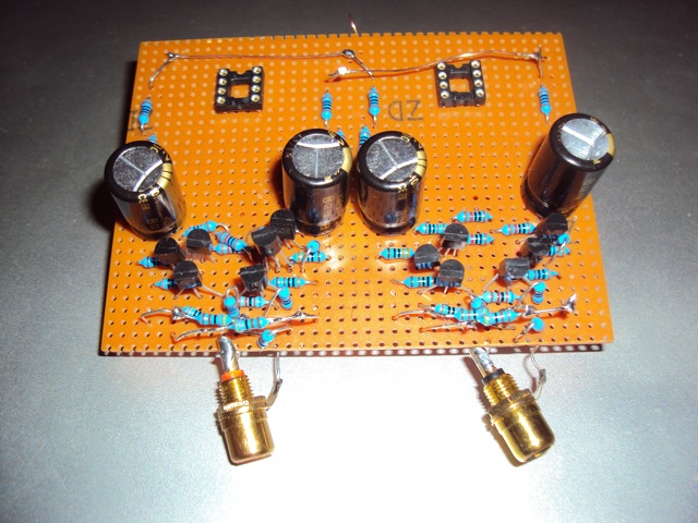

I build the simple full BJT line stage before i left to Vienna. It worked right away. Offset may be an issue so i prepared the Vero Board for servo. The JFet-BJT version could have too much gain but that can be helped.
I am too lousy at bread-boarding -> the circuits usually work but when I look at them I got scared. JG makes really neat prototypes.
