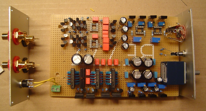

here is my starless build..... everything on one PCB. Upper left corner are the two "starless" channels, upper right corner is the headphone amp. Lower left is the input rectifier and filters, bottom row are the four current sources and shunt regulators.
52 TO92's in total, plus 12 power discretes and four opamps... not sure I ever put that many discretes in a circuit.....
And, I can report the first functionality - the power LED already lights up ;-) more later as I didnt have enough time to hook it all up and try it out.....
That looks pretty awesome !
One of the best Vero Board builds i have seen, common mode chokes and all.
Well! You're not one to take the easy way out 😉
