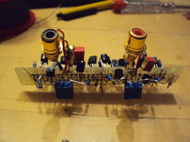

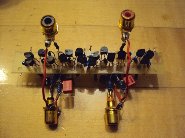

Ricardo, this is nice as well but i really prefer a well made PCB. For the Opus Magnum i use G200 high temperature material from Isola. There is even better stuff from Rogers that goes into the GHz range but soldering can be a problem. It contains ceramics. Teflon boards are nearly impossible to stuff when you do not have professional tools and lots of experience. I can not hear a degration in sound when i go to PCB and when i am usually able to tune the circuit back to what i like.. For prototyping i went away from "dead bug" to Veroboard because it is much easier to debug and also because i get some hints how the PCB layout will be.

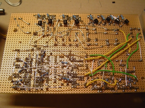

Honestly, if I have the time to layout a PCB I prefer it any time over hand-soldering.... check attached picture for the underside of my starless build... it probably took me longer to handsolder than to layout a proper PCB.

Yeh, thats a labor of love, for one that killed his parents, as we say here.

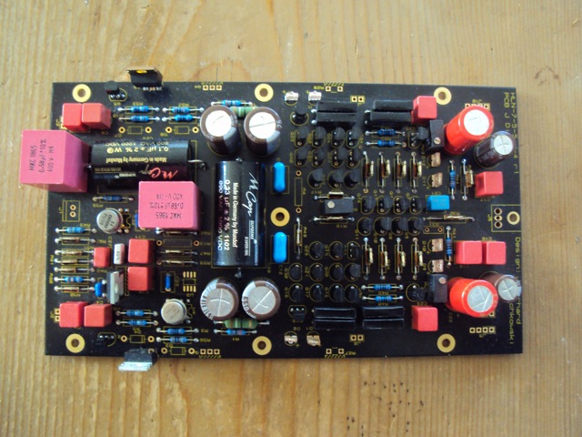

I usually order black material with yellow letters, galvanic gold, vias, G200.

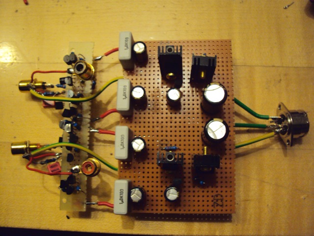

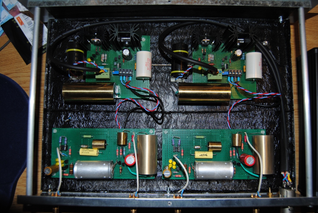

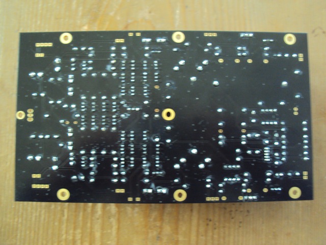

Here is my latest build. I can not make it work although i already debugged it many times.
I was so angry that i destroyed the first input stage until in found out that i fitted LM337
current sources instead of LM317 ? Still it does not work although i measured each and every part. That rarely happens, but it happens.

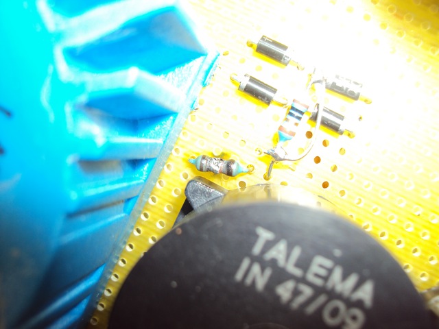

This was the problem : a burned resistor in the pre regulator in an external box. Instead of 10 Ohm it had 850 Ohm. That was the reason i could measure the correct plus - minus 12 V after the regulator when the circuit was not connected. With the circuit the plus voltage went down to less the 2V. I thought the circuit is faulty ! This was a real classic that cost me several days to figure out.
