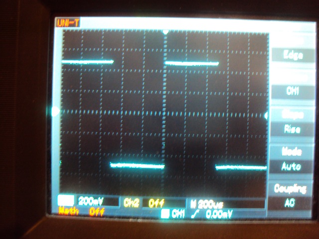

I have now optimised the BJT-MOS phonostage. I established an AC and DC feedback path so i do not split the DC resistor any more. RIAA precission is now + - 0.2dB or better from 200 to 20Khz. - 3dB is at 280kHz and there is still a small lift in the bass with around plus 1dB at 20Hz. I like that so i keep it in. The 1kHz squarewave looks pretty decent. For something so simple i think the performance is very good. This circuit is also nice for experimenting with pre RIAA EQ because the caps that set the EQ carry very little DC voltage over them so clicks and pops when switching should not be a problem. HF balance is trimable anyway. The trimmer could be substituted with a potmeter plus a scale. There are 6 x 10nF anyway so i could imagine a lot of combinations. The caps can be connected in several ways. I have shown two versions. Has anybody an idea what works better or are the connections similar in sound and performance ? What could be improved? Well, the input transistors can be doubled or even quadrupled. I have seen a phonostage from Accuphase that even used 16 pc in parallel. The really low Rbe` ones could be used if you have them. The Led bias to the cascodes could be filtered as i usually always do. Do not expect a miracle. The difference is small and you have two elcaps more that have their own issues. I deliberately did not use current mirrors and current sources. Simplicity was the goal. OK, this circuit will react stronger on the PSU then circuits with more in circuit regulation. That can be a blessing or a curse, depending how you look at it. The elcaps in the signal chain after the cascode can be substituted with foils. Wima makes some really small 10uF MKTs that work well. You need at least 20uF so that the bass will not drop.
