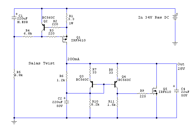

Is stabilizing the cascode's base voltage enough to give the full PSRR? What lurks on R2, R6 from the rails, is not affecting any more?
Well, the cascode has some stabilizing purpose because the voltage at the Fets is constant. R2, R6 can be substituted with current sources. Yes, if the PSU has a flaw, the resistors can not supress this. It will simply downmodulate. Popa has shown in Linear Audio Volume 1 that a current source improves PSSR ( humm ) but does not reduce the noise ( hiss ). How a cascode can be made that is referenced to ground and has no seperate voltage reference i have shown in my FPS in Linear Audio Volume 0 cleaning the baby and not throwing it out of the water the same time. This little workaround did not stir any interest though as far as i can tell from the comunication i got. My PSU that i have not shown so far solves that problem to a certain degree too. I could go on and on. This is all managable with ever increasing complexity. The question is what we want this time. It started out with minimum complexity plus no use of obsolete components and now we are back into state of the art, high tech solutions plus some NOS thrown in for good measure. If an fine with that as long as do not bore the contributors and readers.
I think now that the circuit is fine. Not too expensive, not too complex and stiil performs well at least in simulation. This micropower references are not expensive at all despite the exotic name. The 10uF to ground can be made from 2 x 4.7uF Wima MKT-2. They are inexpensive too and measured under 10mOhm ESR at 100kHz. I build the 12V battery supply version and was happy with the measurement so it works in praxis and the latest changes will make it only better. Lets look at an equally simple and good PSU. I think that could be fun.

You may like what juma liked for his BF862 preamp. juma's BF862 pre. You also see how it mirrors there.
I attach the non Zener one.
