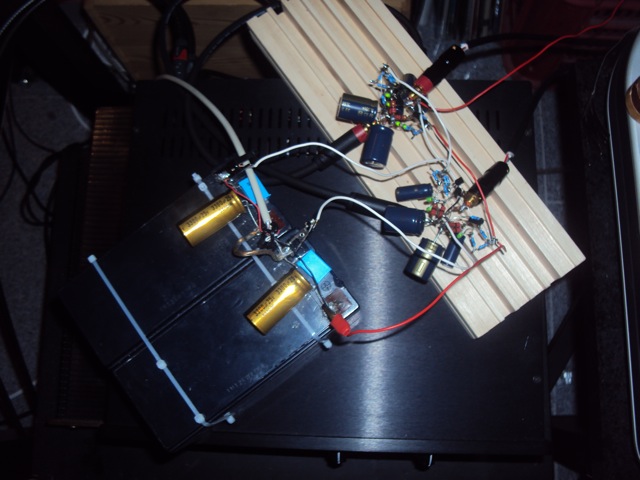

The Simple Cascode Pre-Pre is playing. I am very pleased with the result considering the low complexity. Noise is decent low. At typical volumes i can not hear it at the listening place. I use the MM input of the JG-Self preamp. Poweramps are modified Lorycraft Zenith 601 monoblocks. I use them more often now then my LA Audio Tube Amps. SN is better, so is resolution of details. More power is on tab so it sounds more dynamic too. The Pre-Pre itself has a slightly mellow character that reminds me certainly of the Essex equalizer. Still there is a lot of transparency and space. I also have a discrete second stage on my bench so a fully discrete simple phonostage will be made.

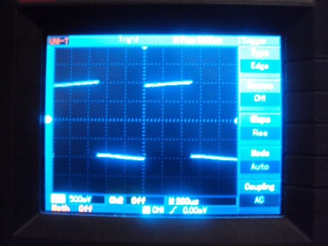

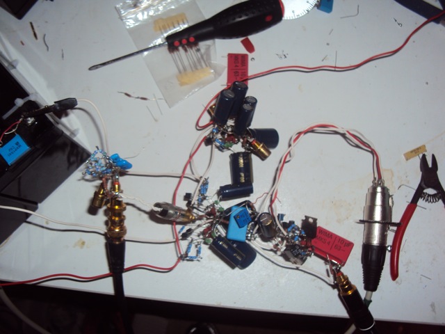

The simple BJT-Cascode-MOS phonostage is up and running. First i build the second stage with plus-minus 12V supply to test it with batteries. Later i will do a plus-minus 24V version. The resistors that set bias have to be scaled acordingly then. The MOSFets idle on around 45mA. The circuit needs some time to start up and the idle current is growing over the next few minuts until it reaches equilibrium. The plus-minus 24V version will need cooling of the MOSFets. Performance is very good despite the simplicity. Frequency response is 900kHz -3dB with a gain of 33dB at 1kHz. The circuit is stable without miller caps i think because i used gate stoppers. Then i added the input stage. I found another solution for the 75usec part. It is now a resistor in series and a cap to ground building a passive eqalizer. That saves 1 cap compared to the first solution. I also was afraid that noise could come into the circuit when i reference the caps against the PSU. I use a 100nF PHE450 from Rifa. It is a 5% component so i use a trimmer for HF adjustment. With the values shown i got plus-minus 0.15dB from 400Hz to 20kHz. The bass at 20Hz is a bit up by 1.5dB so i have to trim the shunt feedback components or enjoy a rather full sound. Gain is 66dB total so this is a bit too much for my Titan i. To adjust that i could raise the 2kHz series resistor but that gives more noise. The other option whould be to half the feedback resistors and double the feedback cap. I think i go that way. I tryed to put the output cap into the feedback loop but that did not work. The input stage needs some bias to flow. I then had the idea to split the 1MOhm resistor in two 2MOhms. One connected behind the cap. If that works i could also put the 91kOhm resistor and the 3.3nf cap behind the output cap. This project went smooth although i did not even put it on a groundplane PCB because i had rum out of PCBs.

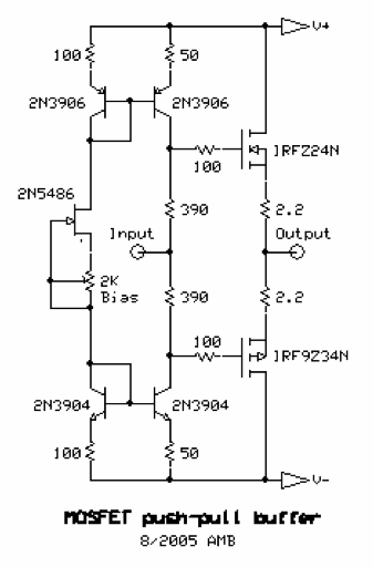

I have being building Diomond buffers of considerable sofistication but the sound was never as elegant or transparent then the JFet Hawksford. I had succes with JFet-BJT buffers and i have published a Szikley design here that sounds rather fine. High Pinsh Off Voltage JFets are needed and they are less expensive and more abundant then the 2SK170/2SJ74 pair so i should be happy. Nevetheless i was looking for a circuit that uses only cheep BJTs and i think i found something i should try. It is a parallel symmetric variant of the current mirrored Schlotzaur buffer. D.Self has shown a single ended version on page 80 of his book "Small Signal Audio Design". The origins of the original circuit are somewhat obscure but i know that another frenshman that calls himself Forr here claims to have invented the current mirror trick. My contribution is only the parallel symmetry so the already very low distortion should go even down in second harmonic. Do you see what i see ? Yes it looks very similiar to the simple BJT-Mos phono so the current mirrors could enhance that circuit too. I also found another buffer i like. Looking for simplicity recently and starting to understand MOSFets i found the Millet AMB MOS Diamond buffer. I like that the signal only flows through one pair of transistors. It does not come much simpler then this when performance is on your mind.
