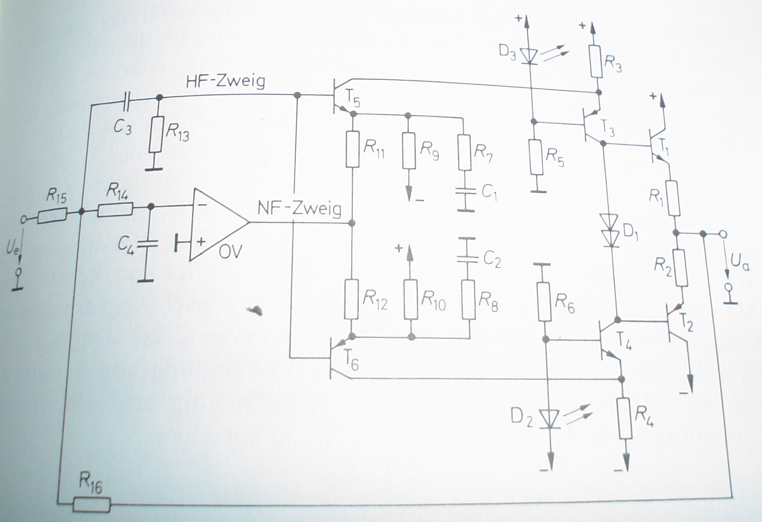

I have made a basic circuit for my new headphone amp. My old headphone amp was published here. It is basically an input buffer, an inverting Opamp and a diamond buffer at the output. I published it here some time ago. I sounds good but i miss something. It could sound more dramatic and with more slam although i run it in class A with more the 50mA standing current. Actually my AKG K701 is not an easy load at all. I also miss the last bit in treble resolution. It came already clear to me that the diomond buffer can be aproved on. First i made a Fet-Bipolar buffer and then the Fet-Hawksford-Cascode buffer and both sounded better then the diamond buffer. I think with the Hawksford buffer i reached my nirvana so far. ( is there any intermediate nirvana ? ).
What i trying now is a circuit i found in Tietze-Schenk 6. edition, page 508. Thanks to AS audio to send me this historic sample. It is called " Breitband-Leistungsverstärker". In english that translates into "Wideband-Poweramplifier". The idea is a work of genius i thing and very advanced for the time of publishing in 1983. There is an low frequency path and there is a high frequency path. The low frequency path goes over an Opamp and the high frequency path goes over a discrete folded cacode amplifier. At the output is a parallel symmetric emitter follower and the gain is controled with the Opamp in shunt feedback. The disadvantage is a quite low input impedance if you want the lowest noise so when your driving CD player or vinyl playback system can not drive say 2kOhm an input buffer is needed. That could of cause be the Hawksford. I will publish the fundamental circuit in some hours. It is still an alpha so i did not build it so far and component values are not all dimensioned and may change in value.
Here is the concept of the BLV ( Breitband-Leistungs-Verstärker). Let´s see out of what black hole somebody comes that has invented it and has all this done before. 🙂
Feedbeside amplifier? 😉
US patent 4,132,958
