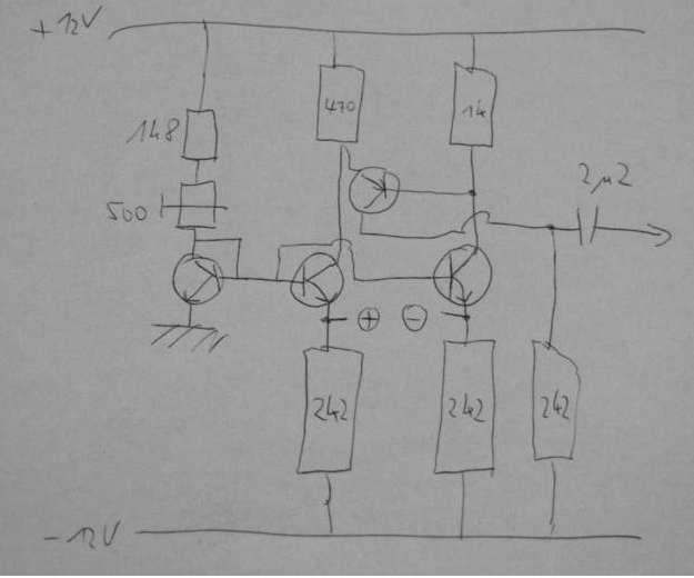

Some time ago HiFi Daddy published a little circuit that i found fascinating. It is a balanced version of the famous Hiarga Le Pre-Pre with an added output transistor. immediately i had some ideas how i could improve it ( hopefully ). One thing is to add an RC filter after the transdiode. That should lower noise by 3dB. The other idea is to cascode the output transistor because in the original design it amplifies the positive terminal in common base and the negative terminal in common emitter. That should result in different bandwidth for the positive and negative side. See the original circuit and my redesign ( not dimensioned yet ).

I worked a little bit on the HiFi Daddy symetrical Pre-Pre. This is my first try so when you find flaws or improvements, please tell me.
Hi Joachim,
Thanks for your proposal. I found interesting aspects in your proposed circuit, but I also found details going into a direction not what I am aiming for:
(1) the mirroring might result in drifting idle current currents, while Vbe drifts (thermal distortion, Early voltage)
I know from your moving coil article in the Jan Didden book, that you prefer to have simple circuits mirrored. From my experience bass tightness and PRAT are negatively affected by drifting operating points, so I strictly exclude mirrored circuits from my design principles.
(2) the collector voltages of the input transistors are still different, with one transistor feeding the emitter, the other feeding the base of the second stage transistor. So through Early voltage, even with matched transistors like MAT or THAT there are is about 5..6mV Vbe difference between plus und minus inputs, but in your variant this would cancel out through mirroring, just translating into a current difference.
(3) with a second stage transistor driven from low impedances, I cannot see any benefit having a cascode in the output. In the 90ies, when I tried out cascodes, I learned they create new problems, and even when handled with care they are a mixed bag, soundwise.
In the meantime, I have put some other bipolars (THAT 300, MAT02) in the original circuit. I will post details later in my original thread. I could spend weeks testing transistors, but I have the feeling that I have to develop the circuit sooner or later, also.
kind regards,
Hartmut
