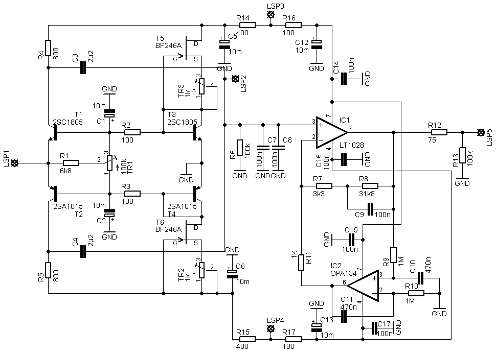

Hi Joachim
It looks very simple.... but the schematic needs revision... The letters appear on the second page.

Hi Ricardo !
Yes, somehow the schematic appeared on the second page. I will look how to avoid that and post it again.

The schematic is ok but the lettering is condensed in the second page.

I pushed the lettering to the second page because i can not remove it totally from the screen with the program i use. This circuit is not dimensioned yet, so some of the lettering will resurface ones that is done.

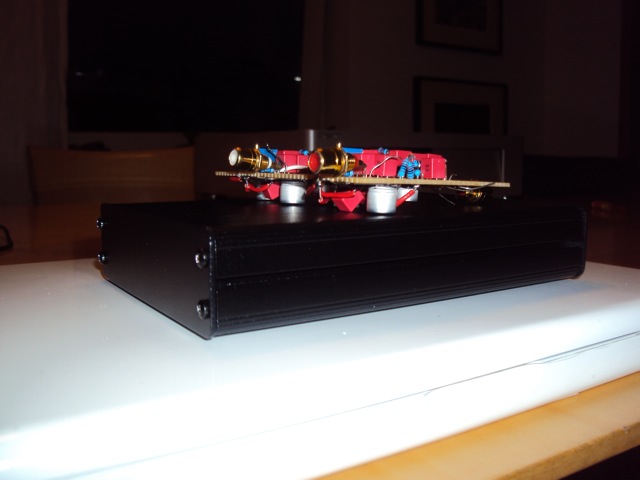

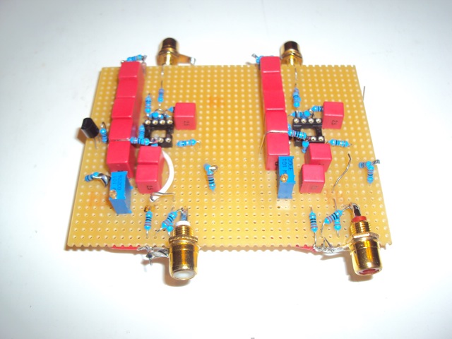

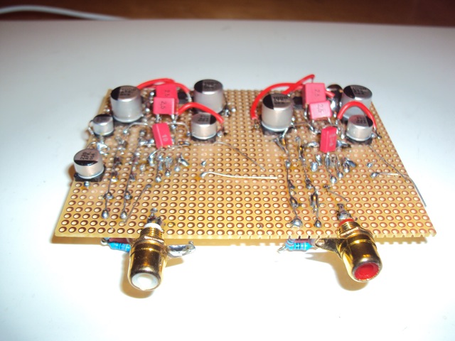

Some time ago i presented a little phonostage called Pocket Phono. It uses an ELV case and PCB and is based on a single stage LME49990 design. When i am on the road it is convenient to have a phonostage around and this design works resonably well. Recently i had a desire to do somewhat better and i found a nice little cabinet that could carry the circuit. There is only a little more then 25mm height inside so i needed to come up with a very compact way to build the circuit. I succeded with a mixture of SMD, through hole and 3D air construction. It is a quite sofisticated 3 stage design with a bipolar MC pre-pre and a two stage MM solution.
