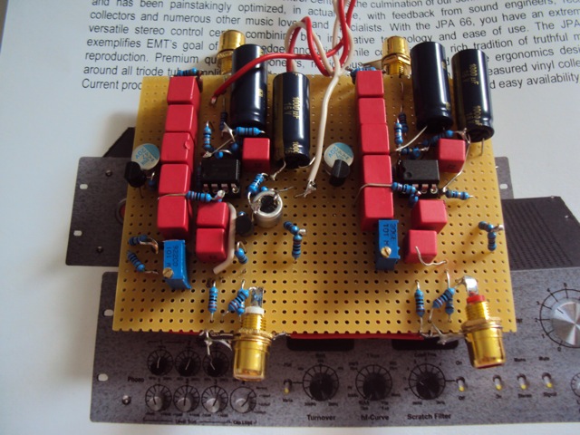

How did you modify the Soundcard ?
OPA1612s are risponsible for the results. See the "before/after" details in excelsheet.
Does the Hagerman implement the Neumann "pole" and is this the reason for the rising response towards 20kHz ?
I don't know. May be I left a related jumpers in wrong position. Or 100R output impedance of souncard instead of expected 50R could couse it?

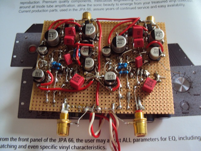

Mzperx, you choose to not disclose your circuit, neather on the phono, nor on the soundcard modification. That´s fine for me but i can not comment any more detailed that way.
Joachim, I'm sorry but I didn't plan to put the whole schematic here.
Regarding the soundcard modification as I already wrote that the significant improvement was achieved by changing of the opamps to OPA1612. In noise respects virgin E-MU1212m is good as is, but the distortion can be reduced well.
You can find further details here:
http://www.diyaudio.com/forums/digital-line-level/107643-e-mu-1212m-sound-card-thread.html
