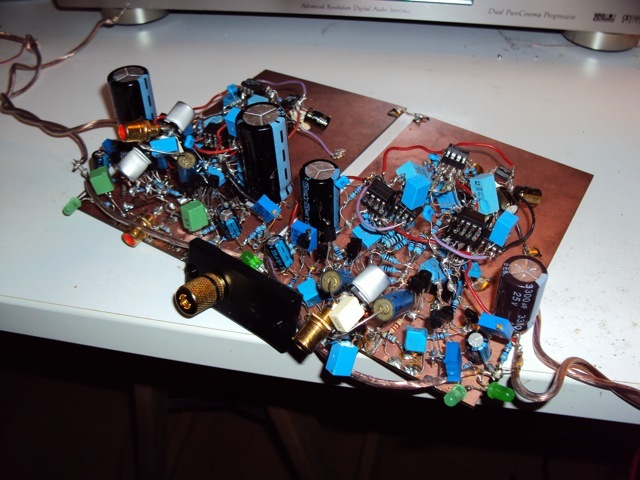

Sure, the first circuit has the Nobrainer input structure. It has advantages and disadvantages. It is a transimpedance circuit and works only well with a cartridge that does not have too much inductance. In that case we would experience a treble loss because the rather low input impedance forms a low pass with the coil inductance. In theory that requires a low output MC with a low amount of windings on the coil former. In praxis even a DL103 works rather well. One reason may be that many MC carts have a treble lift that can amount to plus 6dB at 20kHz and more and this circuit tames that a bit. The other reason may be that many of us over 40 are stone deff over 16kHz. The Nobrainer solves the major problem of a transimpedance circuit in the form of a DC offset into the cart by a local feedback loop around the input trimmer. It has to be adjusted though with the cart connected. The feedback loop also lovers distortion by making the P and N trannis more similiar in behaviour.It is very low noise and does not need particular special BJts because the base current is shunted to ground. That also cancels shot and flicker noise. That stage is dead quiet with 4 cent trannis. Another advantage of the transimpedance circuit is the damping of the cantilever and the use of the output current
of the cartridge so you could argue that more information flows into the circuit and less is shunted to ground like in a high impedance input with a conventional loading resistor. The Nobrainer has also the option to adjust the input impedance to more or less the same value as the carts impedance so making a power transfer circuit. Some people argue that a power transfer circuit is the best compromise between transimpedance and transconductance. I could also argue that the cartridge impedance is part of a shunt feedback stage, so the cartridge is actually in a feedback loop that controls distortion. Another odd option is to inject DC into the cart at will so offsetting the position of the coil in the gap and canceling in theory second harmonic that comes from asymmetry of the total system. So you see there is more to it that meets the eye and you may understand why i waisted nearly one year only to research transimpedance. The cascode circuit has good points as well but you have to wait for my next installment.

Ok, i have a little bit more time. The stage after the Nobrainer input is new because i wanted to make an MM input happen. It is the classical D.Self Precission RIAA with a twist.
I lowered the gain of the first stage by 6dB to lower distortion and double speed and i substituted the buffer with a gain stage of 6dB for less common mode distortion. It works rather well but it is one Opamp more in the chain as the simple Nobrainer. The actual stage that Sam will build for FF2011 is a bit different again. The input is the cascode version as far as i can tell and the RIAA stage is the conventional Self without the gain drop and the output buffer is a discrete class a floating cascode Fet buffer.
Yes, for the DL103 3.5mA plus minimum offset is fine. For a Lyra ( DC imp. = 5.5 Ohm ) you could try up to 10mA. That would rather overdamp the Denon.
Is the FF2011 an audible update ? I do not know but it is functionally more flexible. Usually transimpedance has a higher "PRAT" factor ( power-rhythm-attack ) and the cascode sounds more "elegant" and "sweet" provided you use the same parts, construction methods, PSU, etc.). You can make a transimpedance stage sound tired though with the wrong choice of components and the other way around so it all depends how well you know your "child". OK?

I made a PSU that sound just as good as Accumulators and even more dynamic. When i am in the mood i may bring it to FF2011. It is a very low noise 4 stage design. The last stage passive with common mode coils and RC filtering. The Nobrainer works well on plus - minus 12V so why not using Accus ? The ones i use are from Sintron and dirt cheep. They are special types for medical and caravan use. I think they are called pbq 7.12.

OK,
best resistors : DALE 1/2 watt mill spec RS65E they are UGE terrible for compact layout
Elcaps ELNA Silmic 2 as good as foil
caps : REL Cap film and foil Styren or Teflon alternative "cheep" Mundorf Tin Foil
Diodes : Cree or Ixis Silicium Carbide and so it goes you can spend a fortune on a relatively average topology and make it sound amasing is that what you want ?
