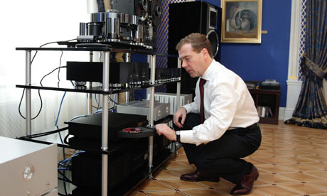

That photo is from when Putin visited, so he could be cuing up a CD for ''civilized'' background listening. Notice his 100dB wolf in sheep's clothing refrigerator cabinets with pro units and compression drivers non the less. He is a Rock fan. He even has an open reel to reel and a collection of original tapes, rare vinyl, etc. Having a medium range Naim CDP when he was Gazprom chairman rather tells digital is a secondary source to him.
Maybe the most ''powerful'' vinyl loving audiophile today is Russia's president. This picture has been discussed before by Dimitri. Avid Acutus Reference SP turntable, made in Huntingdon, Cambridgeshire.
........and white shirt made by Turnbull & Asser of Jermyn Street, London.
