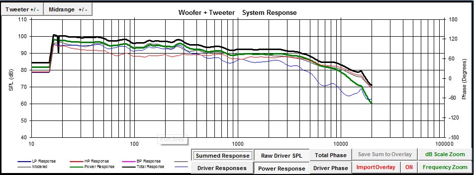

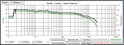

Interesting the comment about sound power. I just got around to playing with the measurements I did a week or two back (the ones that have very unrealistic low frequency in the measurements).
I put them into PCD (after extracting minimum phase from the exported frd's)
The summed result seems to follow pretty closely the overlay of the actual mmm measurement with both woofers and MTM's playing. Only it is about 5db higher.
The interesting thing is that the predicted power response fairly closely matches the overlay curve.
Attached are a couple of screen grabs. First has black simulated summed response, red simulated power response. Grey actual mmm measurement of both the MTM and Woofer playing simultaneously.

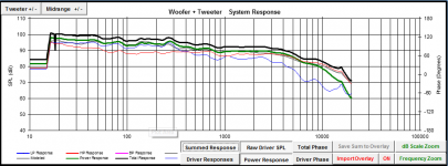

Second is the same, but with raw MTM (thin red) and Woofer (blue) measurements.
I Will need to try some new measurements to try and get some more realistic plots (in the bass region), but it is showing at least some promise for doing simulations of my 200 - 300 Hz crossover

The averaging compared to single point measurements is very good, but I'm wondering if perhaps too good! The curves look way to flat to me and I'm skeptical about the result. There is no way my MTM's with two 5" woofers should be flat down to 20 Hz no matter how much room gain there is!!
Interesting! The MTM should show its natural rolloff. I have no idea why this did not happen. I do see a little room gain using RTA Vs Sweeps with my SWs, but it amounts to only a slight rise starting ~100Hz and increasing to about 2-3 dB at 20Hz. It can be seen the chart I showed comparing the averaging methods (Post 78).

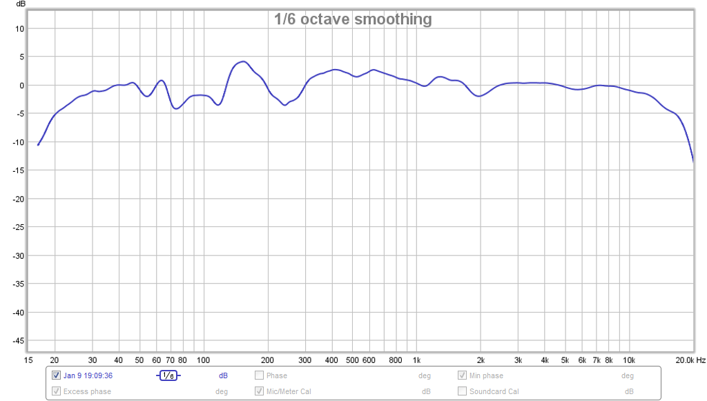

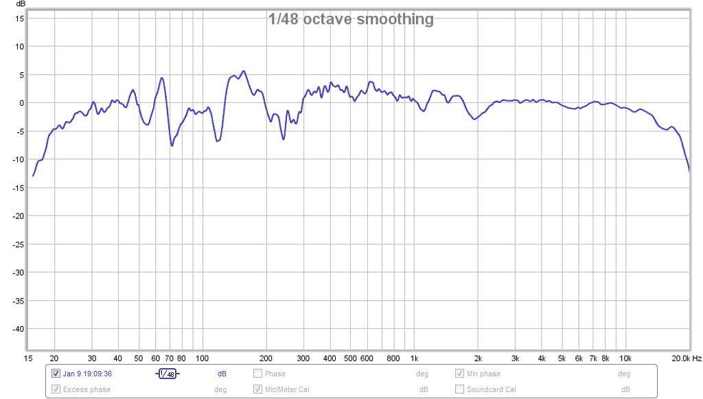

I've gotten to the bottom of it. The issue was a combination of moving the mic to quickly, and microphonic (long) RCA lead from my mic preamp to the sound card.
Attached is a far more realistic curve Note that this is with 10" woofer crossed in at 270Hz not just the MTM
Tony.
I'm not sure what causes the boost between 1K and 200Hz, it isn't there in the quasi anechoic measurements.
If the mic and speakers were in the same locations for both the MMM and the quasi anechoic measurement then I would not expect that type of difference between the 2 measurements. The consistent experience my room is that the deviation between the 2 measurements would be more irregular. The difference would become small if multiple fixed position measurements were taken from the same area that was used for the MMM measurement and averaged together. Such a smooth broad boost in that range suggests that that may not happen in your room.
If the mic or speakers locations were different then the room effects will have a completely different impact and no comparison between the 2 measurements should be made.
No the quasi anechoic were taken outside with closest boundary (other than the ground) at least 2M away. So that's why I am thinking, in room I'm probably getting re-inforcement from the wall behind the speakers (at the least) and perhaps I have overdone the bafflestep compensation (for this room) as the speakers are essentially flat when away from any boundaries.
Tony.
