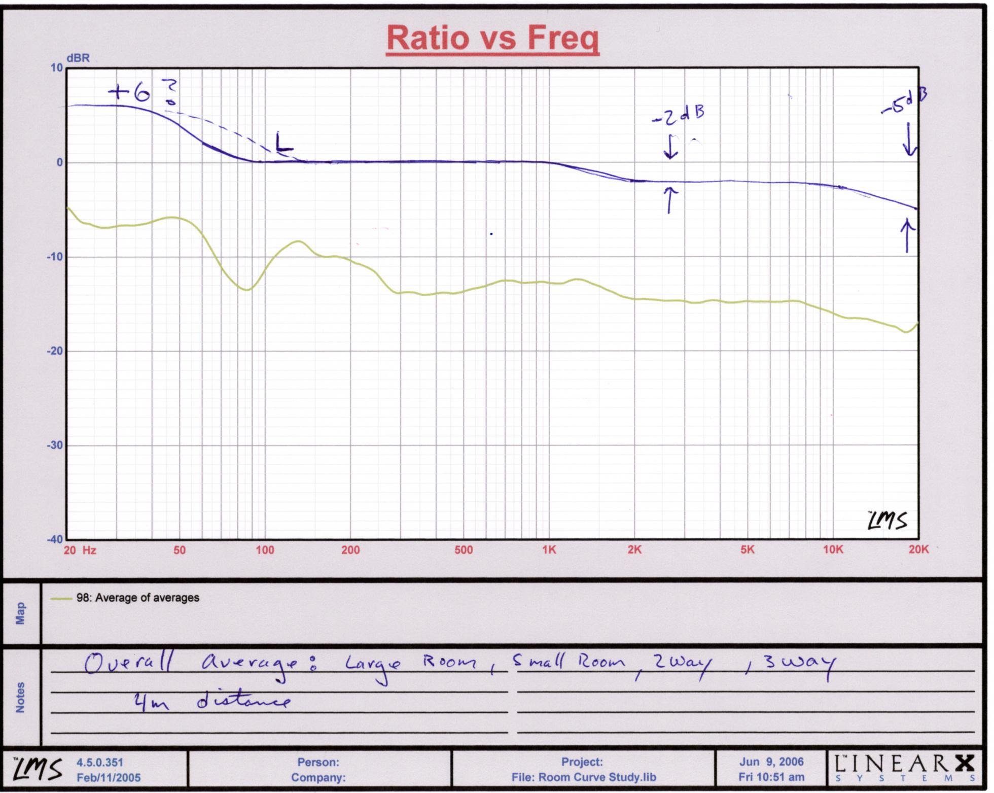

I actually have a measurement that I took a number of years ago. This is specifically the room gain of 2 rooms and 2 types of speakers (all 4 combinations averaged) as I measured at PSB a few years back. We were looking into using Audessy and I was searching for a sensible room curve.
What I did was to measure a speaker in a listening position at 1/2 meter from the system baffle at a spot between woofer and tweeter. From that position I moved in a straight line towards the listening position while taking more measurements at 1, 2 and 3 or 4 meters (depending on the room size). All the later curves are divided by the 1/2 meter curve, leaving only the difference curve. Assuming the 1/2m curve is largely anechoic, the subsequent curves show the difference due to moving away in the room. (speaker near field normalized out)
I've averaged the 4 curves together. You can think of them as generalized room gain curves with some compensation for the average power response of the 2 systems.
You can see that the movement from near to far resulted in about a 2dB shelving down of response from the low treble, with about 5dB total loss at extreme HF frequencies. There is also a significant LF room gain that may or may not be desirable.
These only apply to the particular rooms, but I think they are typical of the response change from near field to far field.
The green curve is the actual calculated average and the blue ink drawing is my approximation to it.

What I did was to measure a speaker in a listening position at 1/2 meter from the system baffle at a spot between woofer and tweeter. From that position...
Nice to see data of that sort.
But for each distance (which is also a time difference) shouldn't there be a correction for room reflections present at that moment in time and within the measurement window? And would that make your final curve all but flat?
(Just my personal soap-box, but I wish "room gain" would be used only for the mythical boost, as Linkwitz points out, in bass below lowest mode in tighly sealed concrete bunkers and well-sealed cars. Otherwise, lots of acoustic factors in rooms favouring bass but not properly called "room gain.")
