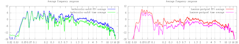

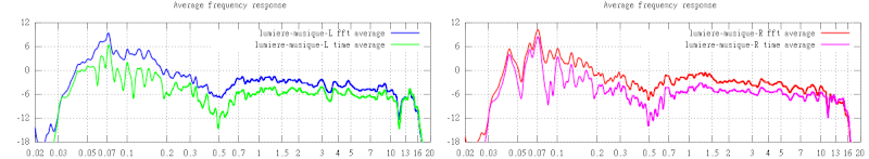

I normally use time averaging only for phase purposes but if I look at amplitude responses, I would not say there is high frequency loss. The main difference between amplitude averaging and time averaging isI have tried time synchronous averages when the timing could not be well maintained and the HF loss is considerable.
- a not smooth response in mid frequencies for time averaging
- less level in mid/high frequencies in time averaging because in low frequencies, the sync averages are totally coherent so add directly and in high frequencies, they are totally independant.
This is also what jtalden showed.
See here some comparisons between amplitude and time averaged measurements in studios, mixing rooms, living rooms, before any EQ applied... : note that in the first image top left, measuring points are only separated by about 10cm distance
Curious. I said that time averaging of the impulse responses would show a different result and low and behold it does. Which is better or right I never commented on only that they would be different because of the different aspects of the direct (MOSTLY coherent) and reverberant fields (MOSTLY incoherent).
Now Dave can lecture us all once again on why "it's all wrong".
A little bit of revisionist history here?
Only different? Clearly you were claiming that you could isolate the direct sound from the reverberent.
Anyhow, I am happy to "lecture you again" on how it is all wrong.
Time averaging will give a curve wholly dependent on the time coherence of the system from spot to spot. You will have a phase dependent sum, so any phase shift due to observation point will cause cancellation. As a multiway system has multiple acoustic centers, any appreciable change of mic position has to cause some relative phase shift between parts of the frequency band (you understand this, I assume?). A wide enough mic area to start averaging out LF aberrations and room reflections will give an unpredictably erroneous response curve.
Both the curves of jtalden and jlo show midrange variation compared to the MMM average. I assume that they are getting the HF end in phase alignment (1/2 the energy visible in the impulse is in the top Octave, so that is what you Tend to align), so the phase shift ends up at the top of the woofer's range.
Since the only goal here is to get a response curve accurate enough to base equalization on, why pursue something so unpredictable? If you are interested in the direct response then measure it with gating or windowing.
Anyhow, you don't need to argue with me. Show us some curves where you have time averaged over an appreciable area.
Thus endeth the lecture.

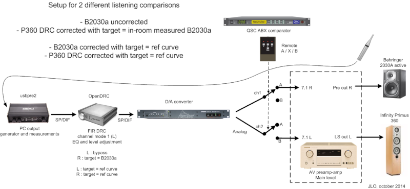

So I have following proposal. We know that :
- absolute quality is hard to evaluate
- comparison listening is difficult because it is very subjective to tell what is best, there are so many criterias and subjectivity is so unreliable
- comparison listening is easier if you just have to tell "same" or "not the same"
So I thought of following test setup, in mono :
- one loudspeaker is reference A (in the sense of an "anchor", not in the sense of highest quality)
- another loudspeaker is B, different brand or model
Place both loudspeaker quite near from another.
Measure both loudspeakers with different methods and prepare two comparisons :
- Equalize only loudspeaker B with various methods to get the same response as loudspeaker A uncorrected.
- Equalize both loudspeaker A and B with various methods to same target curve.
Now in both cases, compare A and B : the best measurement+EQ method would be the one for which A and B now sound the more similar, this could be checked with an ABX test. I know this criteria is very difficult (and maybe impossible for loudspeakers) but let's consider it is feasible.
I'm preparing such a test, here is my setup :
I choose two loudspeakers I had on hand, the reference is the B2030a because its bass extension is less than p360 (would be more difficult to EQ the B2030a to have the bass of the p360 with risks of distortion,...)
Any comments on the validity, problems or improvements of this test ?
Well, I've been EQing speaker A to sound like speaker B in room X since I was a little kid (don't really know why), and I still do it fairly often, and now I have test equipment so in more recent times I could see what I was doing.
I've never done it with the goal of coming up with an EQ recipe, but guessing/estimating from memory of doing it a bunch of different times with all sorts of different speakers, I think it has always turned out pretty much the same. For the closest subjective in-room match, you EQ on-listener-axis anechoic response to match, then EQ power response to match up to some lower midrange level, then sort of split the difference between power response and on-axis anechoic response from there on up.
It's entirely feasible to get a close subjective match with even pretty different speakers as long as they aren't too terribly behaved and you're not running out of output. "Close" as in "yeah that sounds like the same frequency balance", not "I can't tell the difference at all", so I don't think ABX is reasonable; you'll just get a passed ABX for all attempts unless you're using very similar speakers to start with. You need to ABC, "which is closer to A?", ACB "which is closer to A?", etc.
I know there are no amazing insights there, but I guess my point is that with a human that has some basic knowledge of how speakers work at the reins, you can use any number of measurement methods to do pretty much the same thing and there's no real problem. It's only when you try to come up with a universal step-by-step method that you have a problem. Is that now the goal of this thread? It seems like the threads discussing Acourate, Dirac, and so on have been down that road pretty thoroughly :shrug:. I mean, the book isn't closed, but this feels kind of like starting it over?
