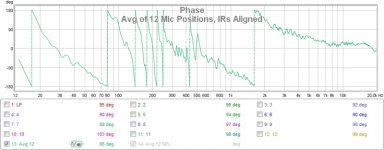

Dissimilar SPL Averaging Method:

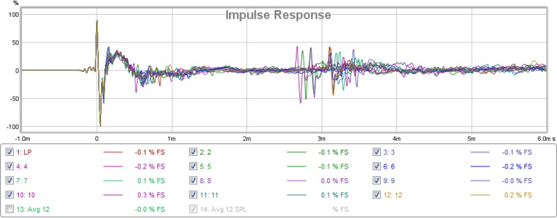

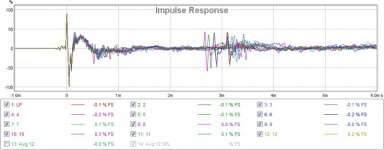

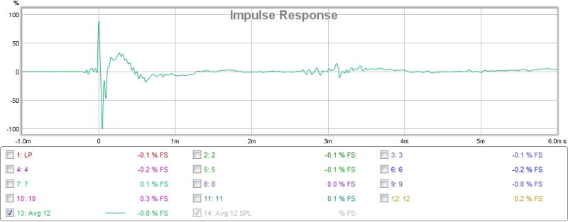

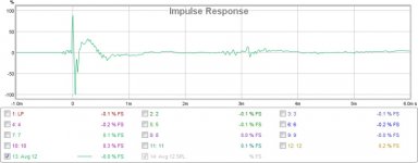

4. Complex average of 12 stationary mic locations when the IRs are manually aligned as shown below. (maybe 15min.)

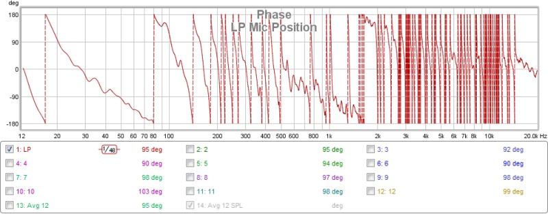

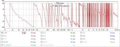

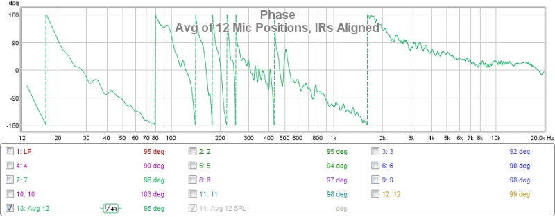

As jlo mentioned in Post 239, I also find that Method 4 is helpful in some cases to pullout the direct sound phase in the MF to HF that can otherwise be hard to determine when there are numerous strong reflections. Of course windowing and smoothing can also help. I often use this method to better delineate the direct sound phase for use in rePhase.exe to establish a phase correction IR filter. See Below:

Thanks for your link to the measurements of post 78.
Your 4th version, the averages of the time alligned impulses, shows exactly what I had been saying. Of the 4 curves it is the odd man out with a clearly altered response in the midrange. It looks like the impulse alignment gives good response in the treble while there was enough midrange phase shift to give partial cancelation there.
I don't think more averages is the answer. The farther you move from the nominal center listening point the more your relative phase shifts will mount and the more unreliable the measurement becomes. It just doesn't work to time average incoherent impulses.
David
Yes. I think we are in agreement on that point.
Aligning IRs and "complex averaging" at the listening position does not work. That was my finding in Post 78. It is clear the phase differences from the room reflections at different mic positions create cancelation around the strong reflection points. You can easily see the radically different room influenced phase responses and the complex averaging reflects this in the SPL chart. "Simple SPL averaging", no matter the method, seem to work well at the listening position. The more averages for a given window the better the repeatability.

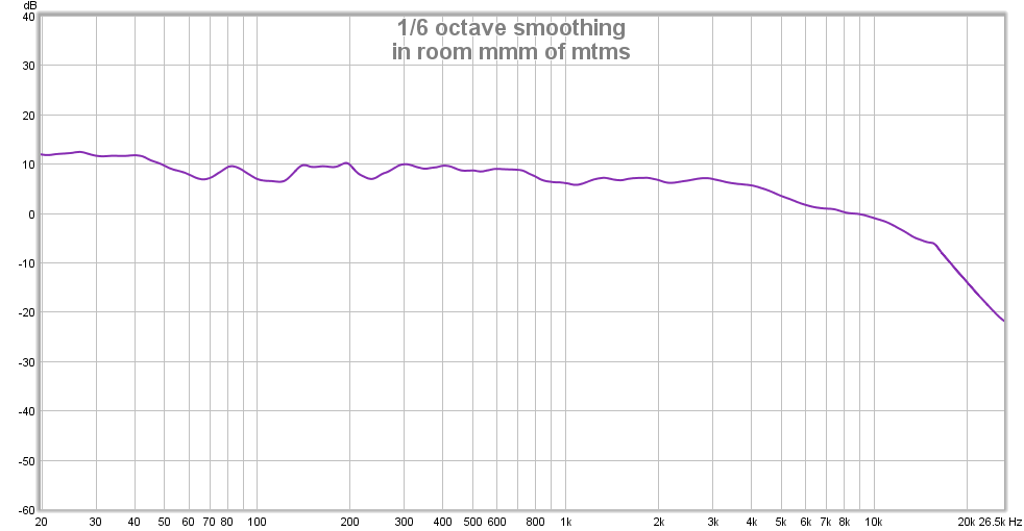

I've just done a bunch of mmm measurements in my room, as the basis for trying to extract minimum phase and do some crossover modeling (around 200 - 300 hz).
The averaging compared to single point measurements is very good, but I'm wondering if perhaps too good! The curves look way to flat to me and I'm skeptical about the result. There is no way my MTM's with two 5" woofers should be flat down to 20 Hz no matter how much room gain there is!!

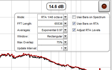

I used rew, periodic pink noise and 1/48th RTA. setting sas per the first attachment. This seemed to work well, without big changes in the averaging in a short time (like when stopping the measurement).

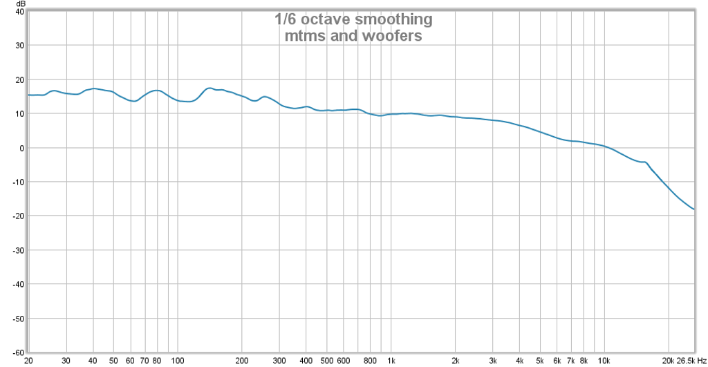

Second attachment is both MTM's running. I did a spiral meassurement round and round spiraling up to a point and then back down again. Is this too suspect to use?

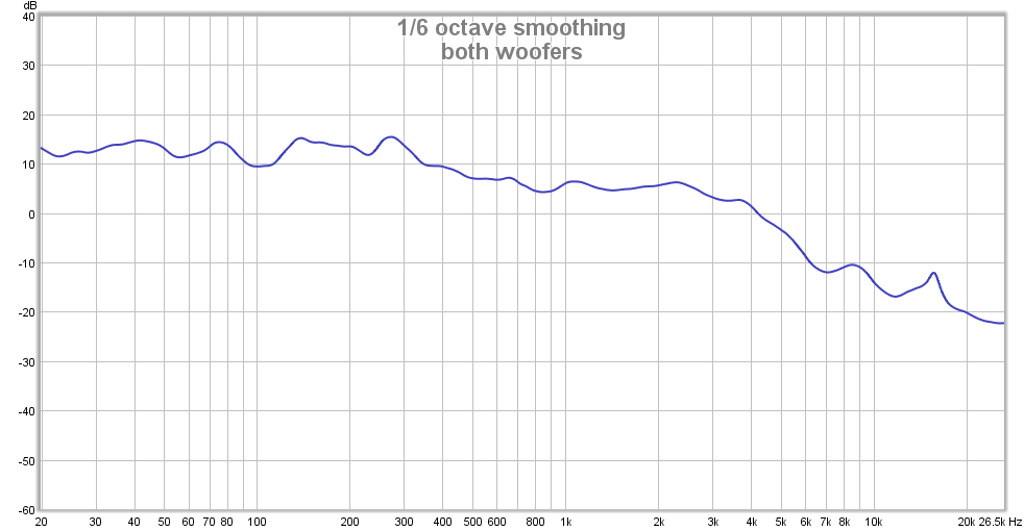

Third attachment is the measurement of both 10" woofers for comparison to the MTM's which are running full range.
4th attachment is both of the 10" woofers running by themselves, and 4th attachment is with the woofers and mtms running in parallel No crossover between them.
I'm just a bit surprised by the MTM only curve as I really do feel like they lack decent bass, but the curve would tend to indicate otherwise (unless I don't understand what the curve "should" look like
edit: btw graphs are 1/6oct smoothed.

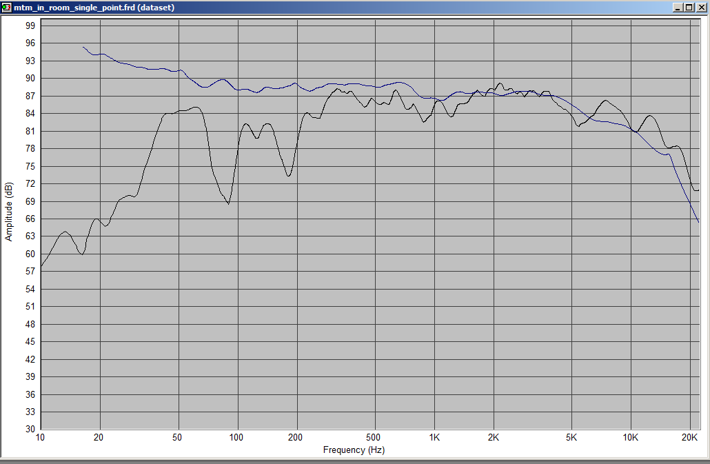

Attached is a comparison of the mmm measurement I did on the weekend (blue) with an single point measurement I did at the listening position in the same room previously. I should have done one of these when I did the mmm measurements but didn't think to do it. I think I am going to have to do some more tests and do both single point and mmm to work out whether these results are valid or completely fanciful 😉
Tony.
