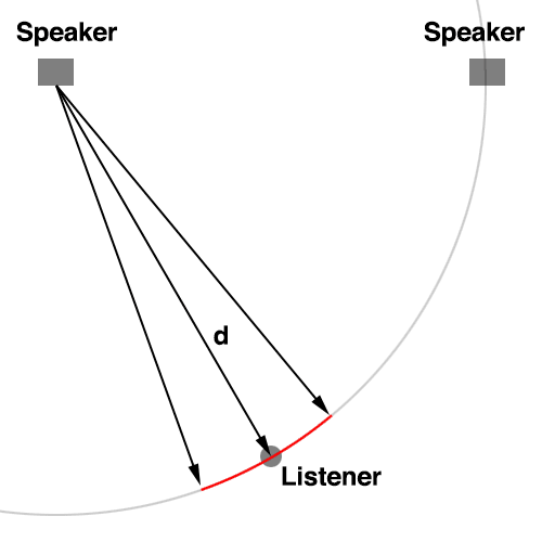

Hi Earl
Just checking for understanding, if we measure along the red line (which is 10 degrees to the left and the right in this example) the direct field in the measurement is enhanced? If yes, by how much?
attachment.php
One could also synch the impulse responses at individual points before averaging.
You mean measure at random spatial points and zero out the impulse response delays before averaging?

By how much? I have no idea. Clearly it depends on the number of averages.
Yes zero out any time differences before averaging.
I would think that you would want to turn the speaker so that it points to the measuring area because most speakers are their smoothest spatially towards the listening axis.

Thanks Earl, this is very interesting, I appreciate the idea.
The following methods give me same results :
- with log sine sweeps, get the impulses, do FFT and an average the spectrums
- with log sine sweeps, get the impulses, average the aligned impulses (must do a bit of process and get rid of min/max values at each sample) and do FFT
- with MMM : record the noise, do an FFT of the whole recording and filter at -3dB/oct
In no case, my sweep plane is kept constantly normal to the axis of the speaker but I really have to think about your idea.
If this gives the same result as non-aligned impulses then my idea doesn't work. Not sure what "must do a bit of process and get rid of min/max values at each sample" means.
If the impulse are aligned but the reflections are random you should get a different result than if the impulses and the reflections are random. Not sure why you didn't. Maybe you processed away the differences?
No it only works with aligned impulses. So your idea is still valid.
In fact, normally I only used the standard way : log sine sweep, FFT of each IR and then average of spectrums.
But as I also wanted to get an average phase (because spectrum averaging or MMM do not give phase), I tried following : log sine sweep, recover each IR, align IRs, average IRs and do an FFT from the average IR.
But as I wanted to smooth out a bit the IR average, I "cleaned" by removing at each sample the max and min values (ie at sample nr 1234, get rid of the global max and min of all N IR and average by N-2) . It is certainly not an elegant solution but it gave me a smoother phase response, easier to analyze.

I really don't think this works at all. You are trying to make something analogous to time averaging and defining the direct sound as synchronous and the reverberant field as random noise.
In practice your system will not remain time coherent at multiple angles, even if you keep a constant distance from system to mic. The acoustic center of the speaker is not a compact point, so coherence will drift. If you stay on a horizontal plane (assuming the elements are vertically displaced) you will still have problems as the high frequency phase shift as you move off axis will add delay. The woofer and tweeter may have different effective depths so you can't keep a constant distance from both.
I have tried time synchronous averages when the timing could not be well maintained and the HF loss is considerable.
We also have to assume that the reverberant field is random (unrelated from point to point) It may be at high frequencies, but I'm not so sure about low frequencies. The SNR gain of time averaging is 3dB for every 2 to the n samples increase. How many samples can you take before the HF coherence between measurements is lost? What Direct to Reflected improvement would come from that?
Anyhow, the Direct to Reflected energy mix is not about signal vs. noise, rather early vs. late of a repeating waveform (the impulse response of a room is repeatable, late energy is not noise). This is an inappropriate application of time averaging.
Before you start squawking about how wrong I am, how about a trial measurement?
