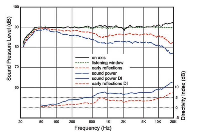

Here is an example for the JBL M2 loudspeaker.
This one even has a rising on-axis UHF response.

JBL/Toole typically EQ the "listening window" response, that is averaged anechoic (gated) response in the 30°/10° window.
That seems to be a reasonable approach as it minimizes diffraction effects but still focus on the direct field only.
First, I don't see why the JBL approach "minimizes diffraction effects".
I don't have a strong objection to the JBL approach, but I have some issues with how it was derived. They went out to customers and measured the customers in-situ very early reflections. Then they used this data to create their "listening window". The question that I have is: Why are we to assume that a finite set of their customers have the best possible room setups? If they were all equally bad setups then we will have standardized on a measurement that incorporates these bad aspects.

Toole, Olive,... showed that
  • PIR predicted in-room calculated response
  • ER Early reflections
  • real in-room measurements at listener place
are all generally very near one from another.
The real MMM difference, is that, instead of giving precisely the awaited ER or PIR equivalent curve, MMM gives a response between ER and LW listening window. As if the ratio between direct/reverberant is, in many cases, a bit more weighted toward direct field than theory would indicate. I don't know why.
