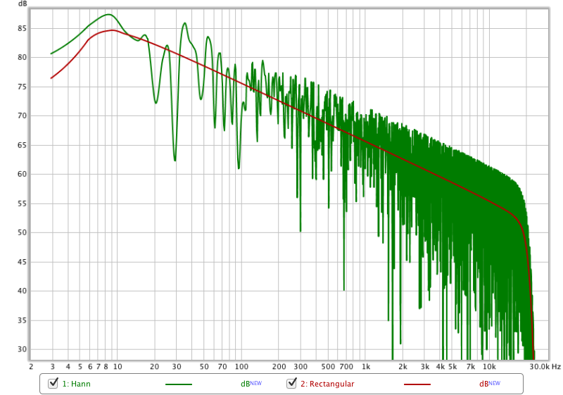

Your image shows a Hann window for the RTA, a rectangular window should be used with noise sources. Pink periodic noise works much better than pink random noise at the low end (need a lot of averaging time at LF for pink random noise as it is only pink after a sufficiently long averaging time elapses, whereas PN is synthesised to be precisely pink within each period).We use REW in RTA mode, Forever averaging. Play pink noise or pulsating pink noise with one or more speakers at the time, start RTA recording and move the mic slowly, 3-dimensionally around your head at your "sweet spot". The radius of movement should be 0.5m (2 feet). Continue recording for say 15 seconds. Then after stopping you can toggle for varius smoothing to see how the response looks.

John, why is a rectangular window better suited for pink noise?

Windowing is required for periodic signals whose period is not an exact integer fraction of the measurement span. For periodic noise (with an appropriately matched RTA length) the signal is always exactly periodic within the span, for random noise signals there is no period and windowing alters the spectral balance.John, why is a rectangular window better suited for pink noise?
No, it would be pretty much the ideal excitation. A 16k PN sequence at 48 kHz provides covers the whole span to 24 kHz every 340 ms or so, contributing broad spectral coverage for the positions the mic is moved through. Worst would probably be a typical measurement sweep, unless the mic was moved at a glacial pace or the sweep was very short.Isn't periodic noise counterproductive with the spatial averaging method discussed here?
All data sampling is windowed, the question is why is a rectangular window better for random noise than say any other window. I don't see how it "alters the spectral balance". IMO a rectangular window is not the best for random signals. Matched periodic noise is the better choice, agreed, but that wasn't the question.

Try applying a non-uniform window to a loopback measurement of periodic noise.All data sampling is windowed, the question is why is a rectangular window better for random noise than say any other window. I don't see how it "alters the spectral balance". IMO a rectangular window is not the best for random signals.
And it will do what? Or is that a secret?
In theory it shouldn't do anything, right?

It wasn't a quiz, it was a suggestion of something you could do if you felt any inclination to collect some data to use as a basis for your opinion.
My opinion is based on the theory, which I know pretty well.
Those results are not what you said would happen though. There is no "spectral shift" only a variance due to the random nature of the signal and a finite number of averages, probably one from the look of it. With enough averages the two will converge to the same result. And I suspect that the green curve is not just a rectangular window, but a periodic noise source as well. Because a non-periodic noise will still have uncertainty even with a rectangular window. The two windows should converge at about the same rate for a broadband signal.
It is a periodic noise signal, I specifically said "Try applying a non-uniform window to a loopback measurement of periodic noise". You seem to start from an assumption that everyone is an idiot and if something doesn't look right to you, it's wrong, which is probably why exchanges with you quickly become fractious. If you were to moderate those assumptions, or drop them altogether, you and the world would probably get along a lot better.My opinion is based on the theory, which I know pretty well.
That result will not converge with averaging. Periodic noise is not some random collection of sample values, it is a specific, periodic sequence of values chosen to produce a specific spectrum (usually by starting with the spectrum and transforming it back to the time domain). Applying a window to that sample set produces a different sequence with a different spectral balance, which is what I said (spectral shift is your phrase). In the simplest case of taking an FFT of successive blocks of the input data whose length matches the FFT and sequence length the result is exactly the same for every block since the data is exactly the same for every block - that is the point of periodic noise. There are many possible different results depending on the point in the sequence at which capture started, but the result won't change until capture is stopped and started again from some other point. If the FFT is updated at a shorter interval (e.g. a 64k sequence might chunk the input into 8k blocks and update the FFT for each new block, giving 87.5% overlap with the previous block) there will be correspondingly more spectra, one for each unique sample set that results from applying the window at the different positions (8 positions for that example) but they will still not come anywhere close to averaging to the desired spectrum. I hope that is sufficiently clear, but I won't be commenting further in this topic regardless.
