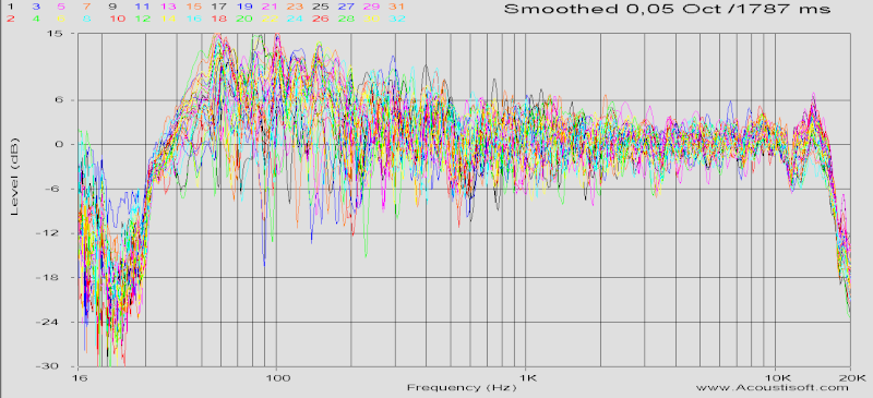

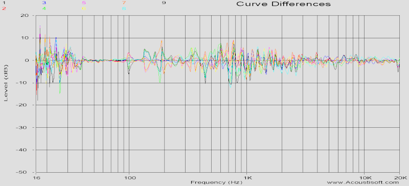

Dear David, as I am the author, I will reply because there may be a misunderstanding.
Here is picture 2 of my MMM presentation, various measurements 10cm separated, we are far from +-4dB on 1 octave wide...
Picture 5 (it is not the same speakers and not the same room, measurements made over a 3x2x1m volume) shows variations very near from Schroeder's calculation which give a 95% confidence range of about +-6.1dB at 1000Hz with RT of 0.2s.
So are we speaking of same measurements ? :confused:

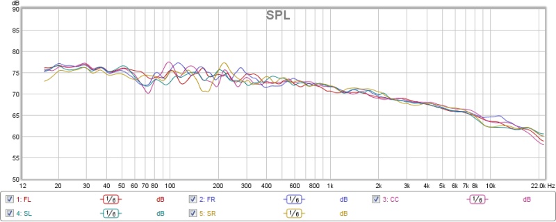

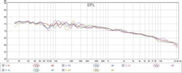

Just another comment in support.
I have tried 50" gated measurement for EQ and some other methods of EQ. MMM is clearly the best for my situation. I really only have experience with one setup however so it may well not be representative of the general situation. Pink noise from all 5 speakers is audibly almost identical and there is very little difference around my listening area.
My TWs (SEAS DXT) use diffraction to distribute the sound widely. The uniformity across that width is not as uniform as a driver that does not use diffraction however. This may explain my MMM preference? I will be trying a more conventional dome for comparison at some point. My concern there is that I would then expect to have all the positional sensitivity that all others seem to experience with domes. I now enjoy a pretty solid imaging and sound balance around a large listening area.
Reading the ill effects of early diffraction has always been somewhat a puzzle to me. We add diffraction to room treatments to scatter HF to help avoid strong cancelations. When this same effect is less delayed from the direct sound (diffraction at the speaker or the cabinet edges) then we say it is bad.
The primary impact to my sound quality seems to be related to source material vs house curve. When some voices sound harsh, instruments sound dull, lacking air or lacking bass, then there is usually a correction possible with EQ/House Curve for that source. This is to point out the MMM is repeatable and if we don't lock ourselves into the irrational thought that a particular house curve must be used then I am finding it possible to get very good results using this method.
After about 30 adjustments to establish my currently preferred house curve, it works very well for my preferences, in my room, on my favored material. It is clearly still a compromise. It is far from jlo's recommended target curve for my setup and falls well below all others I have seen recommended. I can only assume the DXT's "broad scatter" may be the reason.
My point here is that there is a difference between the EQ that results from using different methods of measuring the response. We can hear differences in EQ so they will not sound alike. We then say that EQ method X works better than method Y because on that material, in that room it sounded better to the listener(s). What would have been the judgment had we used different material or a different house curve? It seems to me that the reverse conclusion could have been possible.
So far I chosen to use the method that is quick, easy and highly repeatable and with little sensitivity to setup. The house curve is then established accordingly. This doesn't solve any of the problems with EQ in general. It just makes it easier to measure and make adjustments over time.
My current 5.1 measurements using MMM:

I would agree that very wide directivity HF sources will sound brighter in most rooms, but you preference curve is a little more pronounced than mine.
