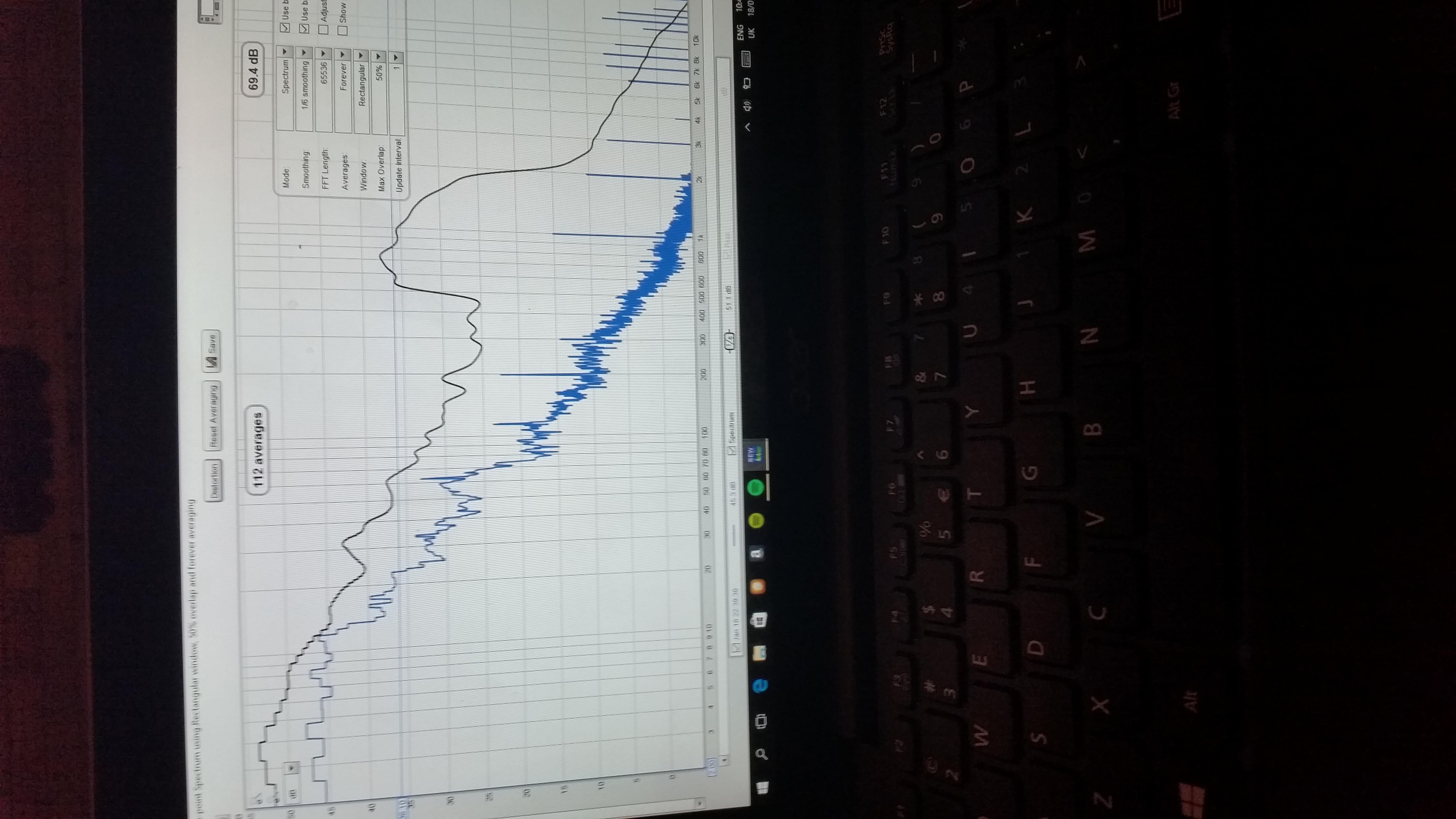

OK now what am I doing wrong? All I am measurement is some noise floor. RTA is running, set to spectrum and forever averaging. Using REW. Looks nothing like the standard fixed mic measurement I took a few minutes before...
@ 1201. Do you use 1/48th final, or do you smooth it afterwards? I generally use 1/12th or 1/6th.
Hi, I just use 1/48.
