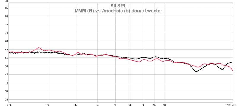

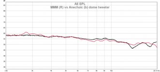

at high frequencies, mmm is the closest thing I know to mimicing the actual anechoic speaker response.
here is the anechoic response of a tweeter vs the mmm at the mlp - no smoothing or windowing for either measurement
btw, still using mmm from sub frequencies to 20khz and still loving it. although I dont eq above 10khz
I believe you are imprecise in saying no smoothing or windowing.here is the anechoic response of a tweeter vs the mmm at the mlp - no smoothing or windowing for either measurement
My criticism of it is that it is too unstable (or unwieldy if you take the time or do enough passes to average well) for the sort of iterative (and re-iterative and re-re-iterative) adjustments to follow the measurements.
B.
I believe you have no idea what you are talking about
