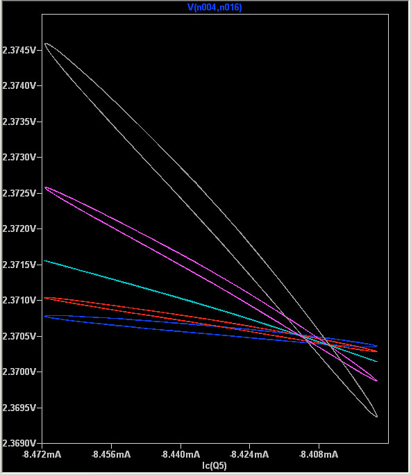

So here's a stepped plot of the bias spread as a function of VAS current. From top to bottom 112R, 56R, 28R, 14R, 7R.
attachment.php
Cordell and Hawksford are trying to make this flat. But flat doesn't seem to be the only issue -- some values cause more time variance. I presume that's between signal rise and signal fall and is due to the fact that the VAS transistor can switch on much faster than off?
28R is indeed the optimal value for flattening the time variance. The width of the ovals (and the optimal R value) are also highly dependant on the Cdom value (presumably because it's the Cob that most affects the turn-off lag?).
So is the ovality indeed separation in rise and fall? And if so, can we conclude that minimising bias spread as a function of rise/fall is more important than minimising it as a function of VAS current?

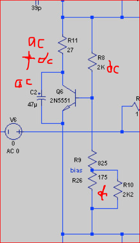

NAP140 from post 106
What I see in your circuit is a low shunt path to bypass a.c. around Q6 so the ac signal does not influence the dc connection to Q6 base. The a.c. current through R11 via C2 will ride on the d.c. current passed from Q6 collector and drop low level of d.c. voltage. In effect the voltages are being mixed within the resistor so the two signal sources are summed before arriving at the driver transistor base.
Referring to post 1 the original value for C2 equivalent part number was 22uF and this was increased to 220uF which reportedly resulted in a subjective change in the quality of the low end response. The depth of the bass was perceived to increase but this thought to be less tight in character.
Later when C2 was removed the amplifier became unstable. R11 then formed a collector load and this should have been replaced by a wire link.

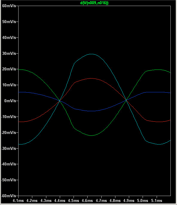

Based on mjona's info I plotted the rate of change of the voltage spread across the bias spreader transistor. The outside two traces are the closest E24 values (24 & 27), while the inside two are E48 values (24.9 & 26.1).
attachment.php
These would argue for a 25ohm optimal, with 24 a slightly better choice than 27 out of the E24 series. The plots diverge fairly quickly after that; 27 (while not being dead-on optimal) is still better than 22 or 33.
Wondering if these were two different ways of measuring the same phenomenon I ran the V=f(I) plots again with the values from above. They do not agree: 28ohms is still the optimal for minimising the time-variance in the the V=f(I) plots.
So, was 27 chosen as a compromise between these two optimisations? Or was Vereker going for one or the other and getting it dead-on just doesn't matter that much?

The slope is the resistance of the circuit....
Half of that resistance (Rcb) is dynamic and in the opposite direction of a "normal" resistor, no? So you can make it flat by making Rcb track more-or-less to R.
The wrinkle of course being that then I need to measure it from where Hawksford and Cordell would drive the upper driver from, rather than from where JV did. But when I do that, it goes flat at 16ohms, which still doesn't meet their predictions. ;)

R11 in your Vbe passes separate currents merged firstly between the lower divider resistor and the emitter- base current.
Subsequently the collector current is added into that mix.
The total mix will pass through R11 which happens to be in the position of loading the collector of the Vbe.
The a.c. signal is diverted around the collector to emitter junction so you are just considering d.c. around a common emitter structure albeit small in scale.
This type of circuit inverts the signal so the voltage drop across R11 will register as negative in phase. The divider network provides a suitable nfb connection from the collector to the base.
