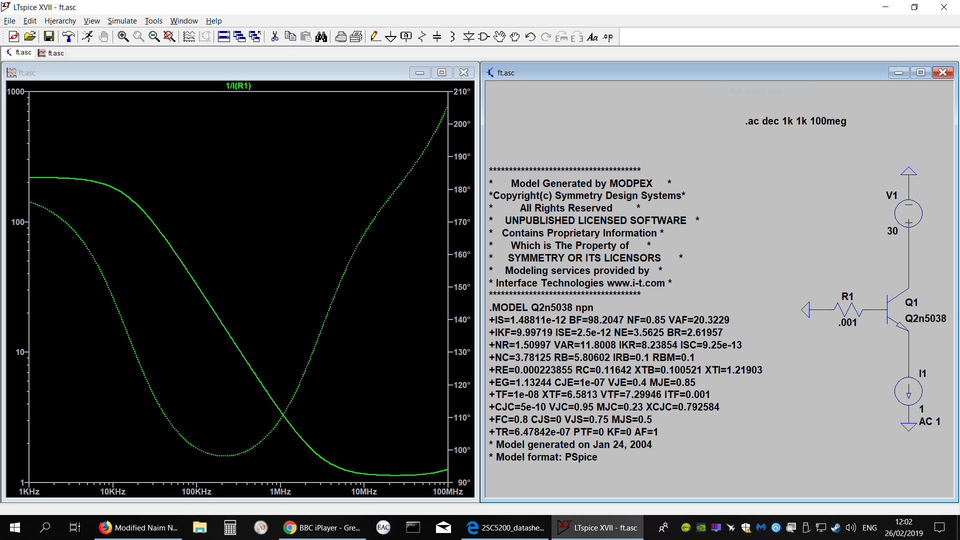

2N3058 PSpice model: current gain vs frequency at 1A emitter current and 30V Vcb.

I'm thinking the rumours of 2N5038 having an ft of 60MHz are exaggerated. It may even be a typo that keeps getting copied. I see no mention of ft in the On-Semi datasheet. 6MHz is more believable.
If you extrapolate the gain slope in my previous post until it crosses the gain=1 axis you get about 5 or 6MHz ft.

I think 25 MHz is not too good to be true. I was expecting something like 28 MHz. I think the datasheet is believable. With Ic=2A, 5 MHz signal has hfe=12. It means with typical first order roll off, at hfe=1 or at 0 dB the bandwidth is 60M. But that's at 2A where many other transistors are measured at 0.5A. This is a high current transistor and when hfe is not linear we will find very low hfe at very low current.
With fT=25M the gain with 5M test signal will be around 5x. This is with lower current than 2A. This is still slower than MJW4281.
2N5038
With Vce=10V, Ic=2A I get a gain of 1.7 at 5Mhz using the PSpice model.
If I crank up the current to 12A I get a dc gain of 37 (agrees with the datasheet: above the min of 20) and an ft between 10 and 20MHz.
Things get a lot worse as Ic drops to Naim bias current levels: about 200kHz at 30mA and 30V.
I think you're right. Within that 2N5038 model, TF=1E-8 or 10E-9. Cordell's shows TF=2.7E-9 for MJW4281. Thats 4 times faster. So if MJW4281 is 30M, 4 times slower is around 7.5M, similar to your calculation.
TF is maximum value from 1/(2*pi*fT), in pico second.
If the estimates are correct, then it's in the same ballpark as some of the
factory NAP output transistors (BDY58 10MHz, BUV20 8Mhz).
Plus it is in a metal case and available. A funny thing though I have a simulation using Cordell .models for this amplifier including the MJL3281.
I am aware there are doubts about the accuracy of MODPEX .models and I am not reading too much into the observations I made when 2N5038 is substituted for MJL3281.
The fT specification for MJL3281 is 30 MHz - although this measure peaks somewhere between 50 and 60 MHz at 3A.
Anyway the swap results in a 12dB increase in gain at 1Hz and the unity gain point is reached at double the frequency as for MJL3281.
On the other hand the - 3dB frequency point falls to about half than that for MJL3281 so the compensation would have to be changed and this does not make for a straight forward substitution.

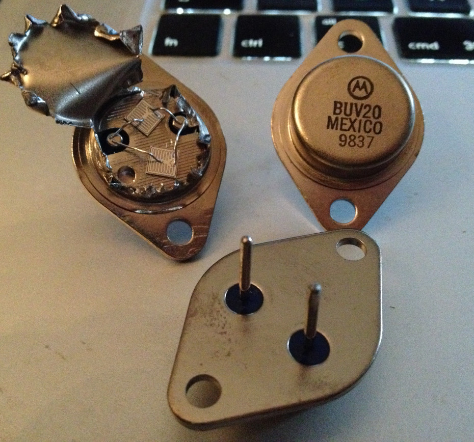

Seeing all this makes me wonder about BUV20 used in the NCC200 module the IC rating is high and the fT looks fine on paper but there is no .model for this. There is no output limiter in the module and that could be the first reason above all for selecting it.
The BUV20 is also the clear winner at keeping itself cool (0.7ºC/W, vs. 1.0ºC/W for the BDY58 and 1.25ºC/W for the 2N5038).
Although that's no doubt predicated on the BUV20's two dies sharing the load, which might be questionable at a peak Ic of ~8A. Judging from the knee in the SOA curve I'm guessing they're 50:50 above 10.5A, so we're not far off.
(FWIW, in my sims dropping the R in the feedback RC to 1K keeps the 2N5038 from oscillating.)

I could not see any mention of two dies in any of the datasheets. There was a term multiepitaxial transistor. See US5034337A - Method of making an integrated circuit that combines multi-epitaxial power transistors with logic/analog devices
- Google Patents
