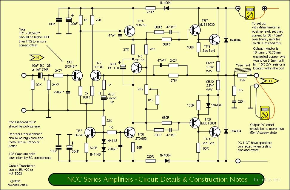

Fig1. NAP-140 Clone Schematic

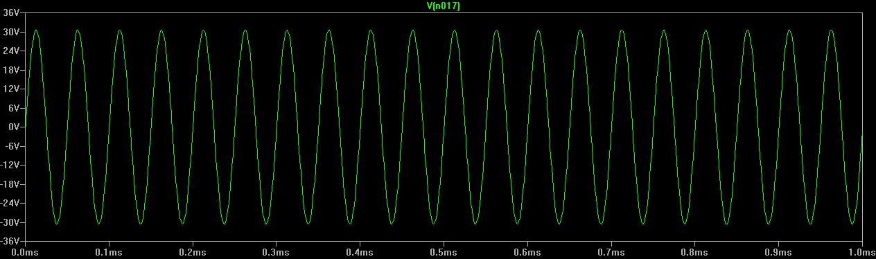

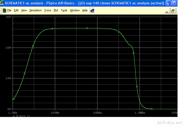

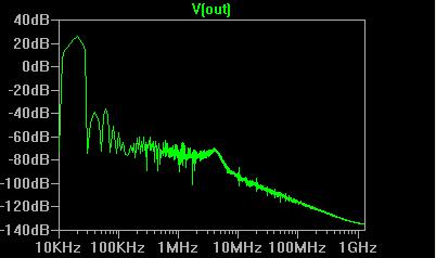

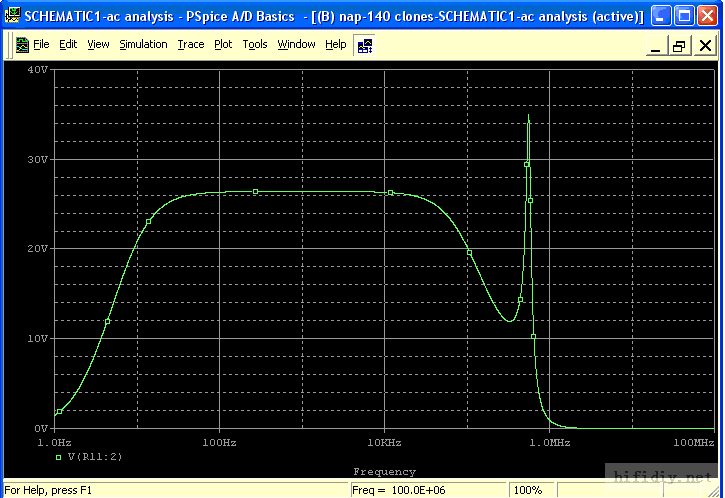

Fig2. NAP-140 Clone Simulation(occilating at high freq. around 100kHz)

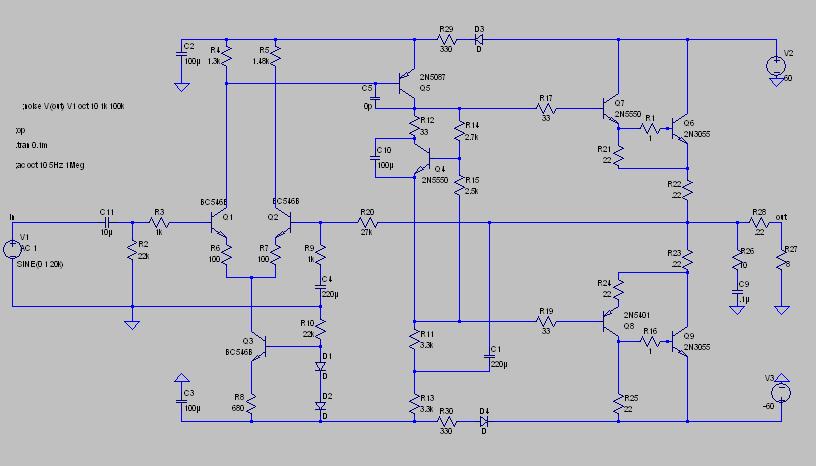

Fig3. Improved Schematic

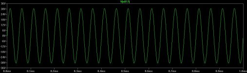

Fig4. Simulation for the Improved Design
My questions are
1) Is there any logic and theoritical explaination for the simulation result? Why the amp occilates at around 500k-800kHz?
2) What is the 68uF capacitor across TR5 for? What happen if I increase or reduce the capacitance?

---The schematic of figure 3 will not operate properly its way too simplified and there is obviously beyond other mistakes very wrong choice of parts

I wouldn't believe 100% simulated results, but in general, this amp oscillates when the used transistors are not suitable (not fast enough) and when the circuit is not properly compensated with the correct Miller capacitor around TR4.
It forces transistor TR5 in controlling only the DC component (in this case creating some constant voltage between collector-emitter), because the AC audio signal is bypassed through the capacitor. By the way, in your modified version this capacitor is 0.1uF and must be around 100uF.

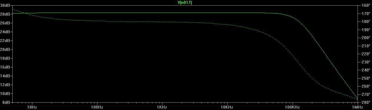

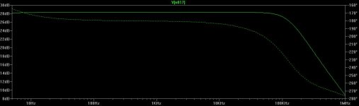

The "Improved" NAP-140 Schematic
LTspice Simulation - AC sweep for the "Improved" NAP-140
From LTspice simulation result, that modified circuit does have very attractive performance
With regard to the cap around TR4, mine is a 56p. I see most of the design using 39p-68p. By the way, in my construction, I use Hitachi 2SB649 for the TR4. Could there be a better choice? My measurement show that the static current through TR4 is 7-8mA, which produces 300-400mW. Normal To-92 transistors could not sustain and work stably under that condition. So did my first and second construction, both a 2SA1145 and a BC556C with heat sink have been used for TR4, both blowned away.
The cap value is arbitrary and is selected by estimating the stability of the circuit. Smaller is better, because it will give you more open loop gain at high frequencies, hence less high freq. distortion. However, too small will cause oscillation. The cap value is very dependent on the current in the differential pair. If you set it for more current, you can increase the cap, and vice versa, without affecting the end result. See D. Self book for details. If you use degeneration resistors, you'll have to increase the current or reduce the capacitor to keep the same open loop gain and stability margins.
IMO, the original circuit without the degeneration resistors is correctly designed in this regard. And the current is just enough to drive Tr4, which is enough driven itself to drive the drivers at their specified currents.
It's deceptively simple schematic, but anything has a meaning, it's not over-engineered, but the designer definitely knew its craft. I think it was additionally fine tuned during lab tests (for example the R/C groups in the driver bases). Of course all that with their choice of transistors.
Tr4 is a critical one. I don't know which one is the best choice. I use ZTX792A. Generally, the right choice is highest possible bandwidth with the highest possible gain, plus enough current/power capability, which is usually self excluding. The role of the drivers is also very important, considering the fact that Tr4 drives them and is loaded by them. Same considerations are valid for them as well. My choice is MJE243/253.

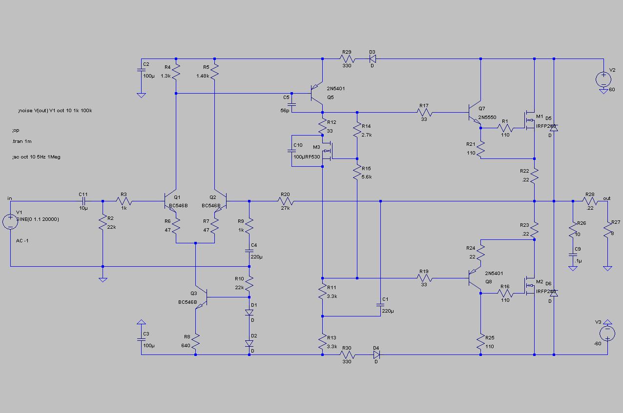

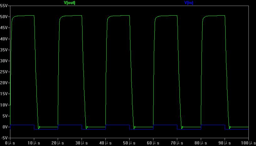

Some more modification & simulation
Prior to my third time to take the amp apart, I have done some simulation work. As Ruwe pointed out that there might be some occilation due to inappropriate cap/TR4. So I tried to build a Spice model with solely bjt.
The revised schematic

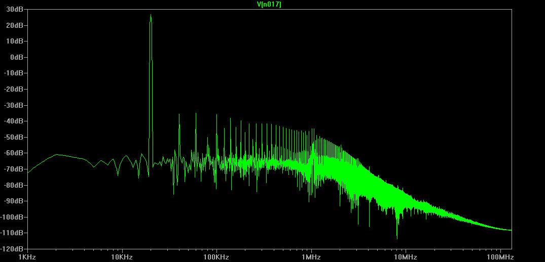

Simulation 50K Square Wave
Simulation 20K Sine Ware & FFT
I have tried different combination of Q5 and C5. The result show that different Q5 does not make much difference as long as it is a high Ft small signal device. Meanwhile, the C5 introduce distortion at high freq. The higher the capacitance, the bigger the distortion. From the above simulation graph, we see that C5 is best as removed, given the output pair is low Ft transistor such as 2N3055.
By the way, I have very limited bjt/mosfet models in my LTspice library. Does anybody know where to get more models? Thanks a lot.
removed C5 from on channel (refer to the above schematic). The sound becomes cristally clear. I can hear much more fine tunes of very high notes. Sadly, later, I found that the head sink becomes very hot. Cannot touch it with bear hand. Power off, Cool down, and power on again, the quiscent current seems not stable. It could jump from a few mA to hendreds of mA in few second, which seemed to be triggered by the input signal.
your are on a very wrong road my friend ....
miller caps provide stability and determine the usable frequency expand for a transistor...removing the capacitor will let free the circuit to oscillate....ideally you could locate the source of oscillation and eliminate it ... but this will only happen in a an ideal world with ideal transistors ,loads and so on
this can also be pcb related issue ...
then again removing it or lowering the value is a thing that can only be verified by instruments and someone that knows also how to use them
obviously simulators will also not tell you much about your pcb or load or cables and so on
I later on tried 4.7pF for C5, but that seemed worse than having C5 off circuit. It sometime gave audiable resonance noise from the speaker. According to the simulation, the C5 is a bottle neck that slow the amp down, ie. lead to low slew rate. Any idea how to modify the circuit and make it faster? The Naim design seems good for the turn table era, but not so good for the modern digital music sources. This is only my own opinion...
I think you could try the two-transistor correction Douglas Self applies to stages like that on the Naim.
Basically you would have to add a transistor and cut some pcb tracks, but it shouldn't be too hard.
Be noted that this doesn't eliminate the Cdom capacitor, which as Sakis said provide stability.
Perhaps you could try this mod on the simulation first and see what you get.
