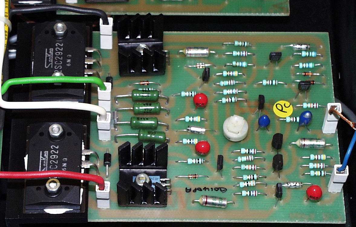

Because rail voltages are lower at +/-34V, there are also minor changes to current source resistors and the small signal transistor types used in the NAP140. Over 30 years in production, there were forced changes to several of the semis. There were obviously different cosmetics and PCBs too. I have seen only a sketch (a reverse-engineered schematic) of the real 110/140 model designs. The usual design we see called the NAP140 that is plastered all over the net and modified by Avondale, is actually the 250 model - sans regulated power supply. This is the same as NAP135 and I believe it's also close to the NAP180, a model for safe max. power from an unregulated +/- 40V supply.
Given the high Cob of 30pF for the VAS transistor, this needs to be factored into the value of the Miller compensation cap. It isn't just what it appears to be at all - in fact it varies with the signal as does the output capacitance of the transistor. That's all a part of the distinctive sound quality that you hear. If you were looking for a perfect textbook design with ultra low distortion though, I'm afraid Naim designs aren't for you and simulations might give some strange results that don't agree with expectations.

Gareth, I'm not saying you're wrong nor that it matters greatly, but I have original values like 62R V 68R VAS emitter resistors in my almost original 140 model. Strangely, this also showed up in some NAP140 Ebay clone kit documentation some years back. They have a relatively high VAS bias current and I think the purpose of closer spec parts was to ensure consistent performance from model to model, which would have been of concern to the designer.
I have also referred to your pic previously here. Note that your pic of a NAP110 and the best image of a 140 at Acoustica.org.uk, show completely refurbed PCBs from Europe, I guess, from the sites where they originated. Your attached pic of the 110 model shows a part rebuilt amplifier with Hungarian(??) NOS output semis, odd wirewound resistors and plastic mounting pads for the small transistors. In fact, almost all components appear to have been replaced, even the small heatsinks. This isn't necessarily bad but it casts doubt on what the the refurbisher intended. i.e. whether they set out to upgrade the design, followed an available schematic instead, used common E6 replacement values or fitted direct replacement values etc.

I think I have a few more photos on my computer. One does have to be careful to cross check different sources in case you get something that's been modified. When I get interested in an amplifier I scour the internet for photos. Sometimes they turn up in strange places such as foreign on-line sales websites but they don't stay available for ever. I have collected enough information to reverse engineer a couple of Shindo units and a Leben which I may clone one day as I like the look of them ! The Shindo amps are particularly interesting because he often changed the designs of a model over the years and you can see how they evolved.
Here's a photo I found on the web of a NAP140 board.
