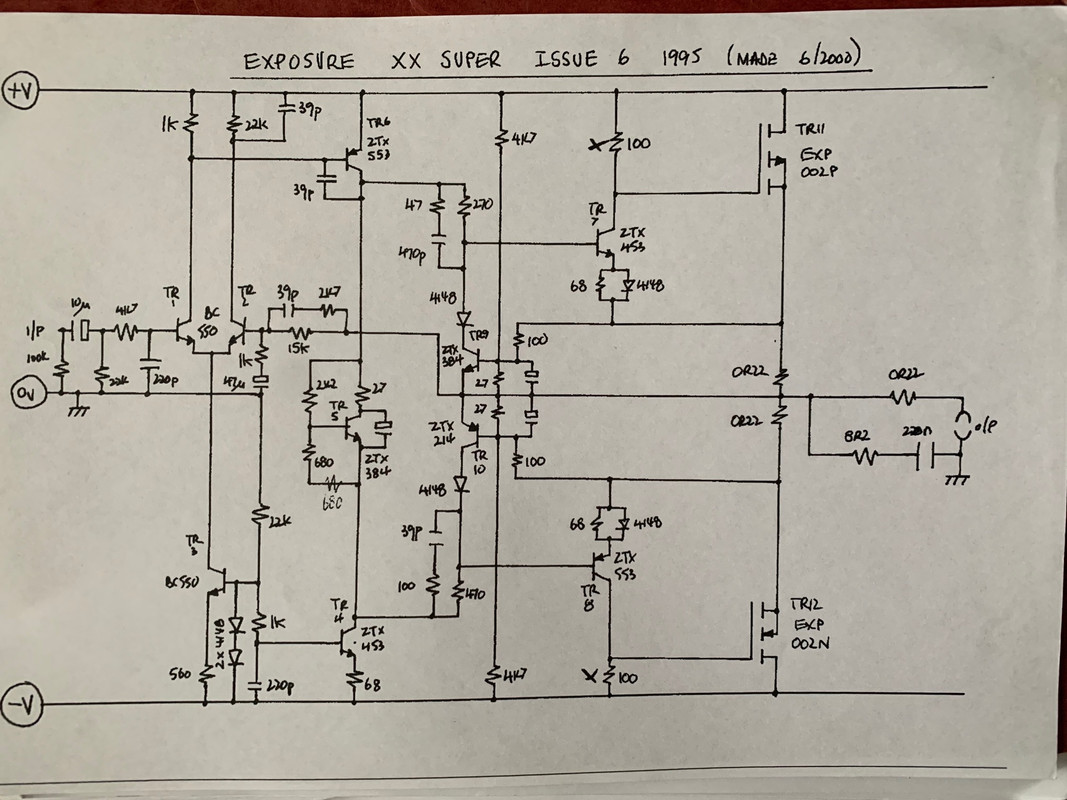

Modified Naim NAP140 Schematic
I cannot vouch for the authenticity of this, but if it's correct, it's what I would call the old Naim front end:

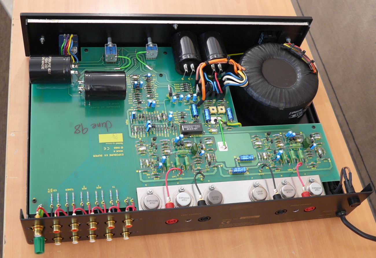

I don't know where I go the schematic from and the Super XX has 6 output devices from what I can see... so tread with caution.
The 6 output device are labelled N P N on one channel and P N P on the other. They do appear to be FETs but I've no idea what the extra 2 are doing, unless to regulate the supply?
In the later Exposure 2000 series models, the power transistors are TO220 hexfet types and given the tiny PCB, very thin chassis for heat dissipation and modest transformer, they are not powerhouses and the sound is nothing to get excited about. In the pair I used for bi-amp experimenting, there was something of a sheen on the sound, to my way of thinking.
I understand these were Malaysian products as production had moved there after a change of ownership. The later 2000S series reverted to BJTs (Sankens actually) and these models were better received. It wouldn't be the first time that Sanken's BJTs, particularly the LAPT types, have trashed mosfets, perhaps in this case, due to design and quality control issues. A bit more verbage here: Exposure 2010S integrated amplifier | Stereophile.com

The subjective effect he mentions is IMO mostly/partly due to the 22K collector resistor. But Expo chooses to "defeat" this effect at HF by adding a 39pF cap in parallel.
I must give this a try sometimes... to try to get the warmth of the 22K effect without too much of the the wall-of-sound effect.

The current through the 100 ohm of driver transistor won't be close to 10 mA i presume, giving little voltage for Vgs. Latfet is suitable there. The Naim circuit will give good distortion spectrum (monotonic), good bass and the nature of the latfet itself will give HF better than Naim.

However, even if the topology suggests that quasi output stages should have something in common with fully CFP types, since it is a hybrid, I don't think it does because the sound is strongly influenced at low levels by the very different crossover behaviour. We can't predict the distortion products exactly but generally, asymmetric topologies will have a higher proportion of even order harmonics than either CFP or EF type.
