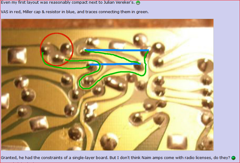

Indeed. I'm even soldering leads on a surface-mount naked staked film cap to get the right look of the Zobel capacitor.
Of course I'm doing my own two-layer boards, so contradictions abound. 🙄
BTW: that brings me to another question: has anyone found a trimpot that resembles the original ones Naim used?
I am wondering if you are aware that JV engaged a software expert to design the program he used for the pcb layout - he specifically wanted to be able to contour shapes using curves and graduations in trace widths.
At the time Naim had also come up with a computer model of the circuit which mapped everything.
There are a couple of points to make about JV's pcb - first heat in the Vas transistor will travel through the leads to large coppers area under the pcb.
Second there are no sharp edges that you might find in regular pcb layouts where bleeding of the signal can happen at angular points where straight lines cross.
There is also a problem with stray capacitance causing a decline in gain with increasing frequency - so there is more to JV's layout than as might appear at a glance.

I regarded it as credible at the time which was later when Naim had become automated.
Anyway, the traces for the Vas transistor run in parallel on a tenuous route around a fairly tight loop and there was a degree of care in the way this was done.
Aspects like this should not be passed over without thinking about them - certainly not if everything matters.
...Anyway, the traces for the Vas transistor run in parallel on a tenuous route around a fairly tight loop and there was a degree of care in the way this was done. ...
Agreed, although he was also working under the constraints of a single-layer board without resorting to any jumpers on the top.

I read somewhere the rumour that his girlfriend at the time designed the PCB. So I don't know. But I think it was single-sided without masking to keep it cheap as chips. Layout is important but I am more inclined to believe he used his common sense, which he had an abundance of, rather than software tools.Aspects like this should not be passed over without thinking about them - certainly not if everything matters.

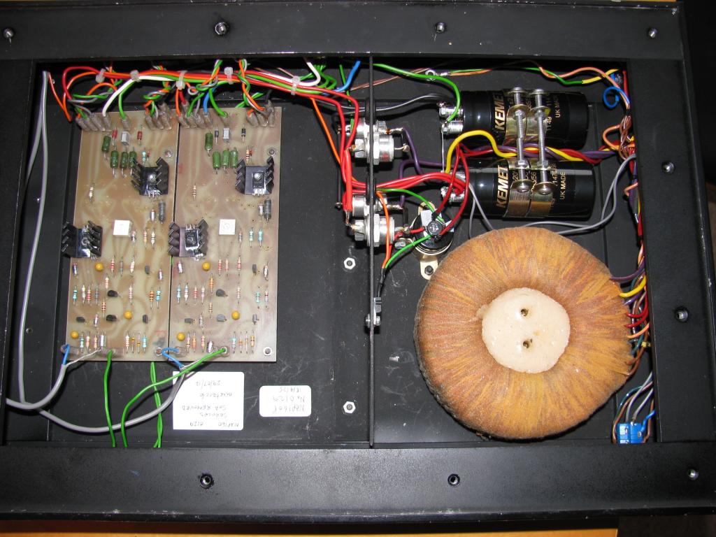

- Modified Naim NAP140 Schematic
