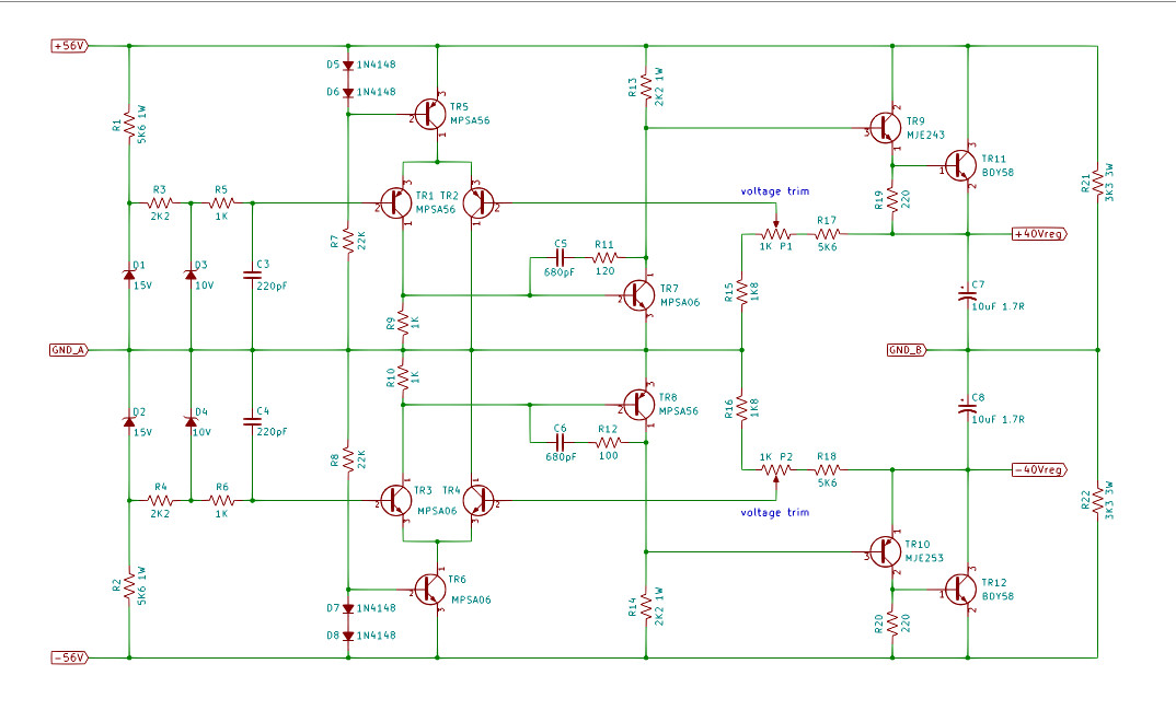

If you're looking to use something like the Naim regulator, it doesn't cost anything to invert the LTP and VAS so their references aren't the dirty power rails.
This schematic also adds a simple CCS for the LTP, but most of the performance gain over the original is due to inverting the LTP and VAS:

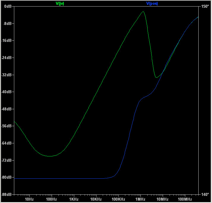

Here are the attenuation curves (original in green, above schematic in blue):

FWIW I did simulate it, and it agreed with Hawkford's equation (9.6 ohms ideal)
What was the VAS current? What was Rbc? Rbe? Junction temperature?
In the end I decided not to change it under the presumption that the out-of-balance compensation networks for the upper and lower drivers might need adjusting, and JV did those by ear.
The references for the ltps are identical, the dirty rails, and it is okay. The vas could be better with your circuit. But i'm not convinced. For me the regulator is not about as much as regulating the supply voltage. How about other performances such as output impedance?

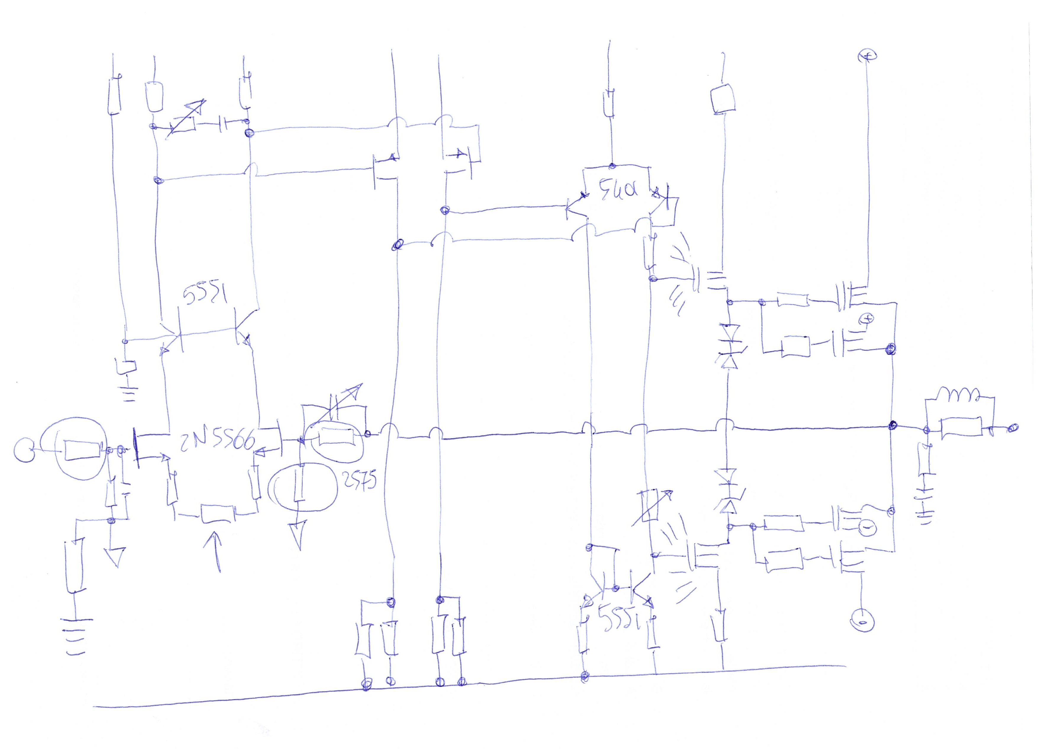

Clearly, as I could, I would stabilize this scheme, but it is not clonable
Why do you want to clone that amplifier? Yes, the input JFET has no equivalent, but there are many ways to do the first stage with different part. The second stage is strange as the JFET Vds is very high. Doesn't have to be fet tho. Harder part imo is the complementary fet drivers. Nothing equals the J313 Toshiba parts which is hard to find. What amp is that? Spectral?
I would like to clone it because it sounds very good.
there are no caps on the signal and it is coupled in DC with a very stable offset
The problem is precisely 2n 5566 to which I can not find a substitute
Tried to replace with a dual transistor, but I lose a lot.
The emitter follower with a j fet P-channel , Toshiba J 109, is very good for the amp
The scheme is Spectral revised by Norma Audio
if you have suggestions for the first stage, I am grateful
the original drivers were Hitachi 2SK 216 and complement 2SJ 79, no more products, but can be replaced.
My problem is the Dual j fet input and input stage
Sloppy wording on my part. The LTP is inverted only because that's the easiest way to drive the inverted VAS.
Output impedance is also improved, again more-so in the upper frequencies. At 1KHz it goes from 1.5mOhms to 0.2mOhms; at 10KHz 10mOhms to 0.6mOhms.
A somewhat eye-watering price, but: 2N5566 Integrated Circuits | Quest Components
I believe Johan Bernstrøm still have a few of these left.
And according to your latest drawing you planned a cascoded inputstage so the 25pF shouldn`t do much harm.
