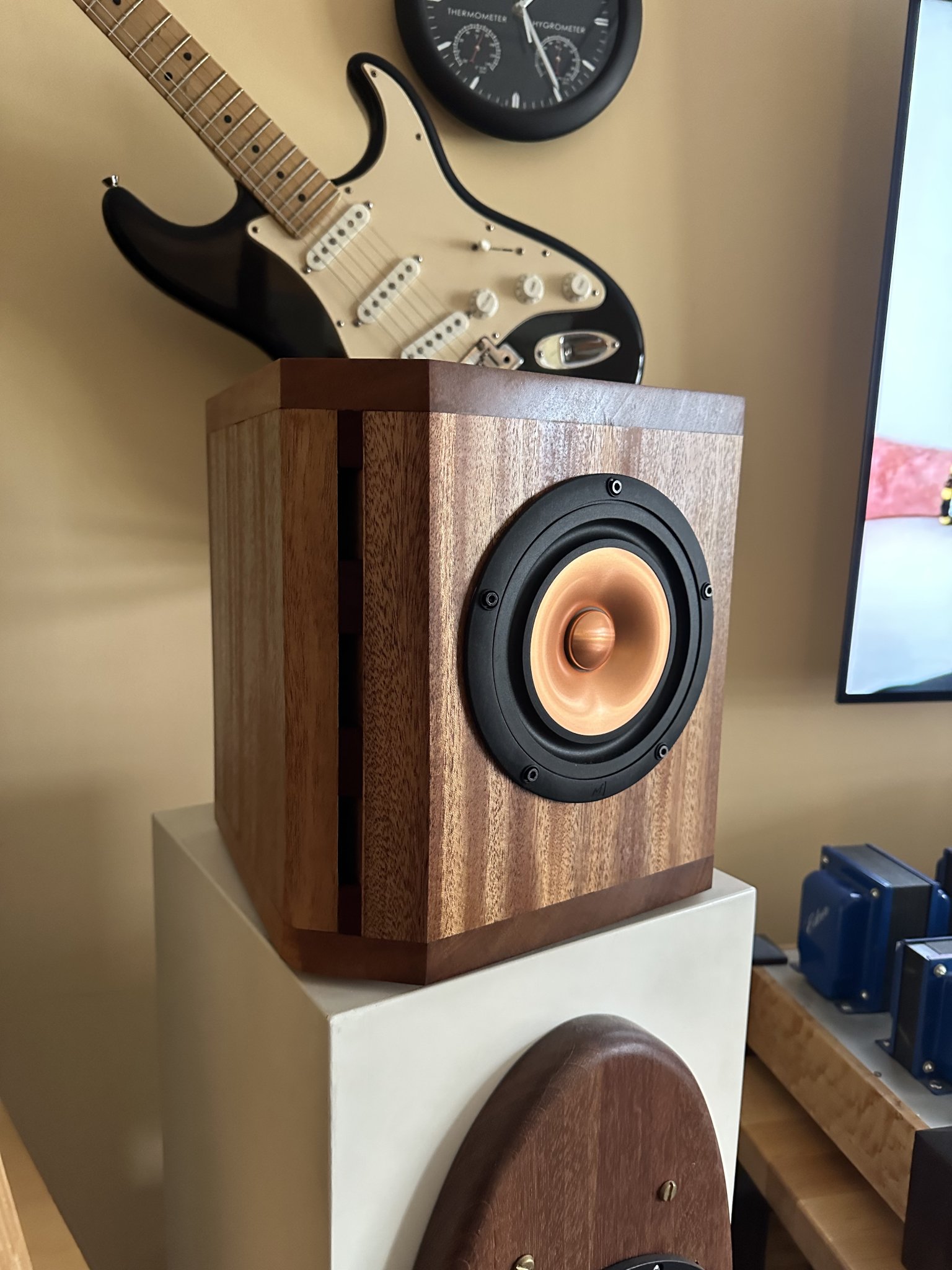

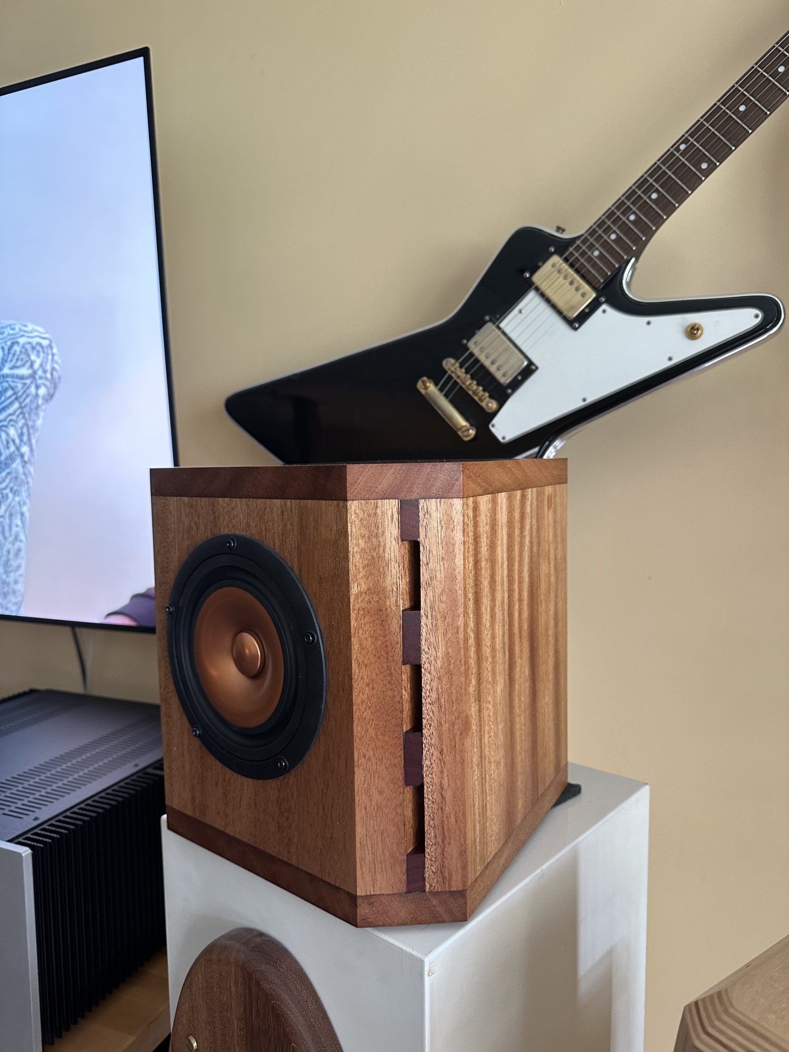

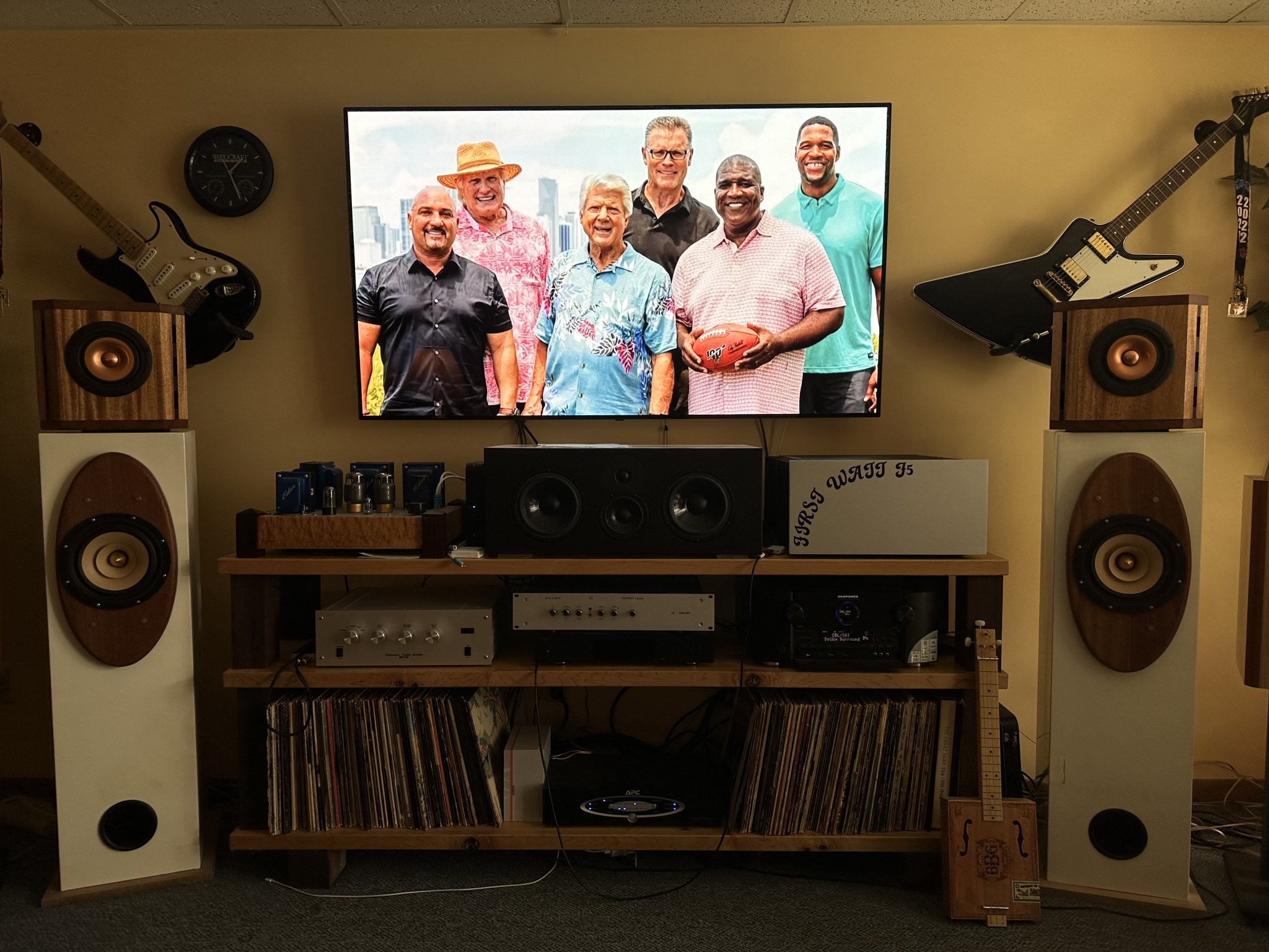

Nice spoeakers :^)
I like the guitars on the wall. Something i would like to do. So far i only have Doug's Gibson off the Doug & the Slugs album (he even played it on stage)

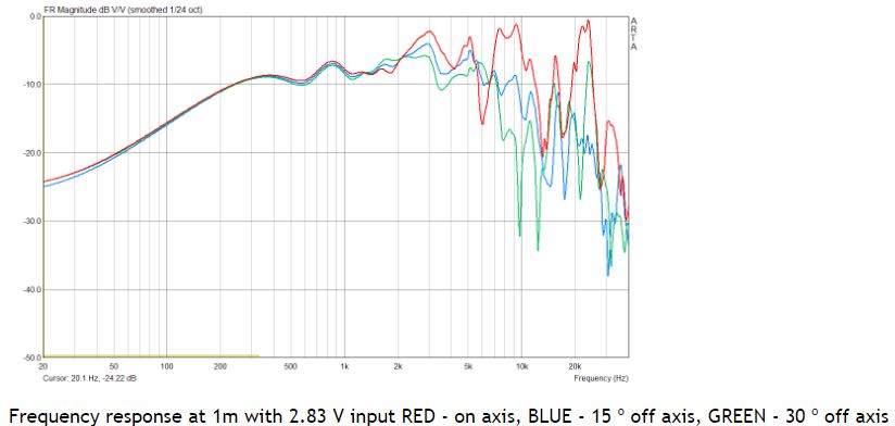

Here is some measurements of the MA Alpair 10P-A from rutcho:
https://rutcho.com/speaker_drivers/alpair_10p_a/alpair_10p_a.html
Should I be worried about beaming? Looks to me like a tweeter is going to be necessary to tame the top end. The woden design silbury looks cool, but a lot of work with little guarantee that it will sound better than a multi-way design.

If you look up the frequency response of various high end multi-way loudspeakers, you will see that they are not that flat either. Set then up in your listening room and the frequency response changes again. The graph from rutcho is not of a finished speaker design, it is raw driver response. The ultimate question is what the final balance is like and if you like that sound. I have a living room that has too many reflections for many loudspeakers, the beaming of large (8"+) fullrange drivers has been a benefit to me. In my home office, with a much better damped acoustic, it wouldn't work for me.Here is some measurements of the MA Alpair 10P-A from rutcho:
