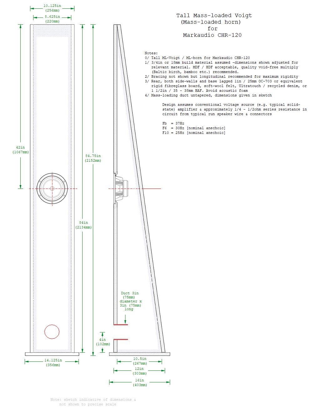

...and because nobody asked for it (well, nobody here anyway) -a tall CHR-120 ML-Voigt / ML-horn for those who like them, and prefer a driver located above an average seated listening axis:

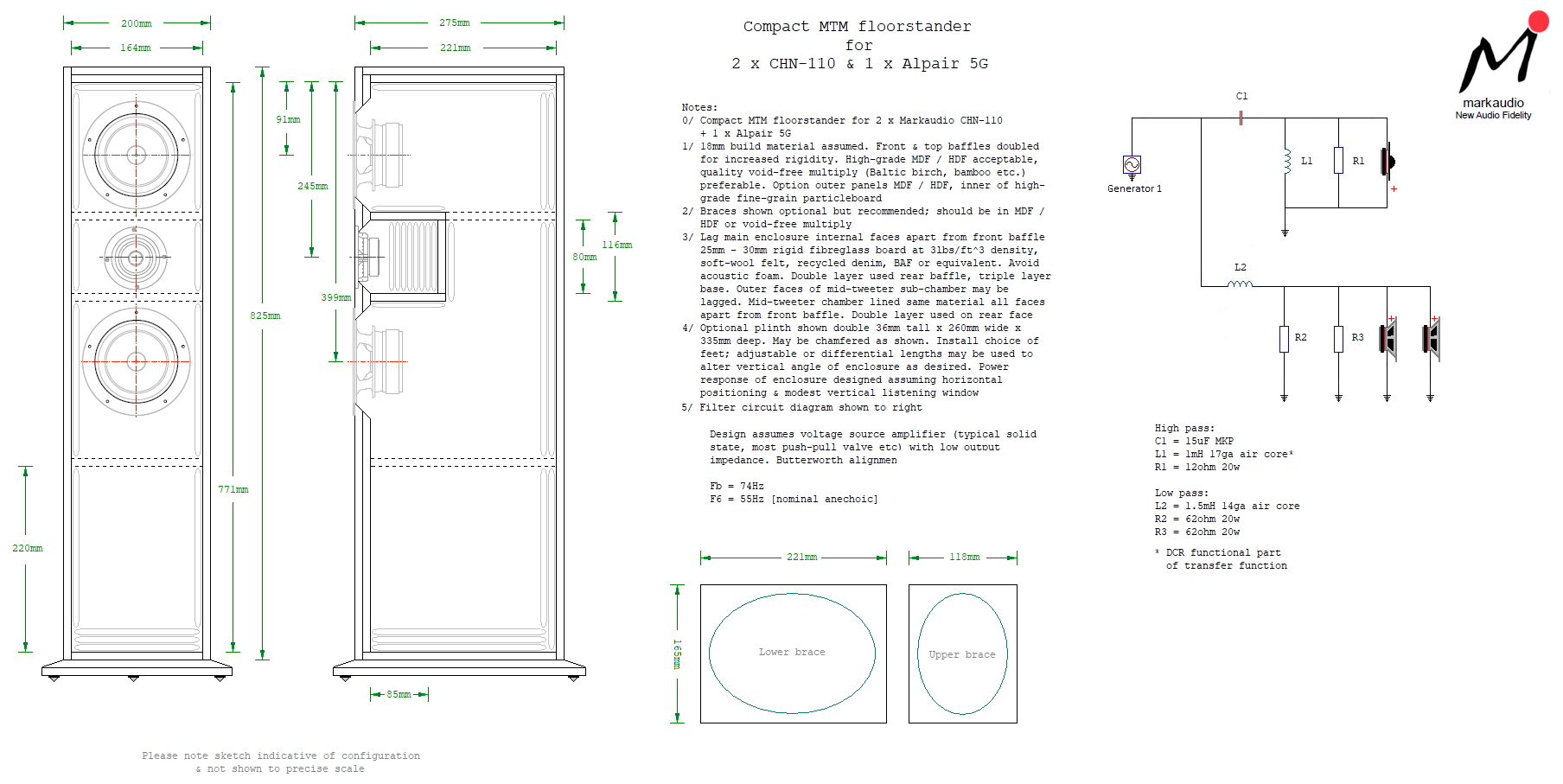

...and as a sneak preview, with the new glass cone Alpair 5G:
Compact MTM floorstander. External dimensions were inspired by an old Linn design, although the construction, internals, drivers, loading & filter are all completely different. Latter is another '60s - '70s JBL inspired type, designed for a reasonable front hemisphere power-response & vertical window since this would otherwise be rather short for an MTM. I like the proportions (although don't take my rotten sketches too literally -they're just indicative of the dimensions, not shown to scale -other than the driver drawings, which are by Dave, and therefore excellent! 😉 ).

Another interesting design, Scott, and the crossover certainly looks less complicated than I remember from the Linns; of course part of their strategy was to isolate the passband sections to accommodate multiple amps in either passive or fully active mode.

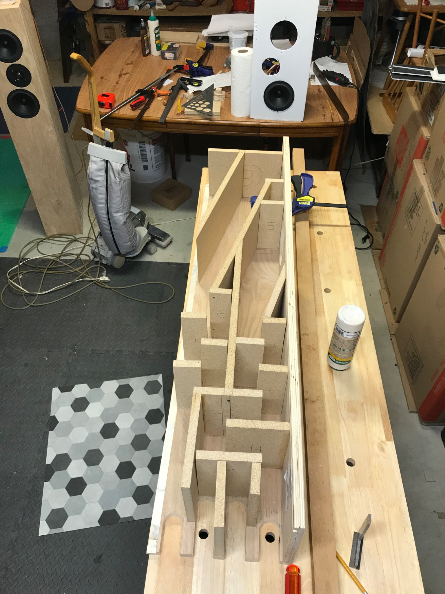

Found some Ariel drivers a few years back on eBay I had read a lot about them so decided to take the challenge and built a pair even though the drivers had been sitting around 20+ years sound good I always thought something just slightly off

With anything in particular?
I've been going over the different variations, & it reminded me of something I was looking at a few years back. The independent pipes came about because in earlier versions, Lynn was trying to combine two dissimilar length pipes about halfway down the box into a single, and was getting some destructive interference as a result. The independent lines was a solution to that; works fine in itself of course, although no opportunity for offsets etc., but arguably a simpler solution to the issue would have been to remove two internal panels from the existing v3 encosure so the drivers shared a common upper chamber like a Bailey / Radford / Daline & fed a single pipe / line / labyrinth. Problem solved. Still, it ended up as it ended up & it worked decently, so not much point speculating on 'what ifs'. 😉

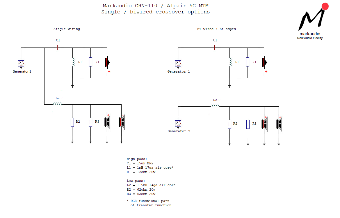

Right, I keyed off the Keilidh's external dimensions, as I quite like them, although having pulled about four pairs apart, the internal dimensions & construction are completely different.
Re the filter -no big deal there, as far as passive filtering goes, the isolation of the HP / LP legs is more a case of how it's drawn or physically wired / printed on a circuit board than anything fundamental to the design. For biwiring, just assume the branch off before C1 is the 2nd pair of leads. Or you can just split it per attached.
The A5G is being crowd-funded in Japan (that was a new one on me too); hopefully will shortly be available. I try to keep all the filters for these fairly simple, partly because I tend to think the driver types suit them, just as they did back in the '40s - '70s, but also because Markaudio don't like things to get too complicated in case it frightens potential buyers, which from a commercial POV is understandable.
