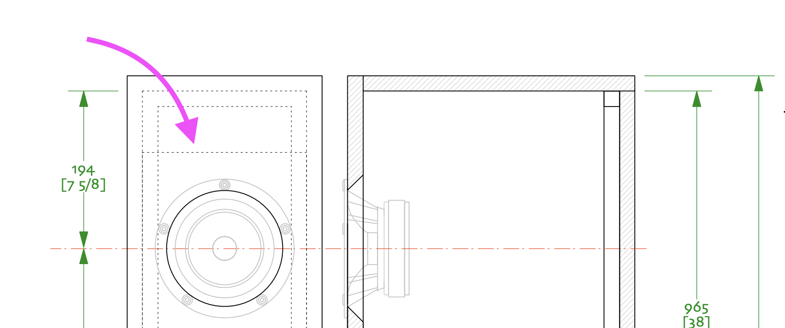

Hi, noob here with my first build.! I’ve got a pair of 10p’s and I’m leaning toward the Titania enclosure based on some advice given by a friend. My question is; could I use 25mm MDF rather than the 18mm as long as I’m following the internal measurements on the plans? I’ve managed to score a small truck load of 25mm sheets and was hoping to make use of it..!

It’s long been my understanding that as long as critical internal dimensions/volumes are retain, the thickness of construction materials can be varied.

It's noted right on the drawing. Don't mix vent diameters and lengths.Additionally if I decide to use a specific one must that size be used for all 3 ?

Jeff, thanks for posting that drawing; like I said, Scott has authorized too many designs for a decrepit old fart like me to keep track of. I’m not inclined to do all the maths, but those aren’t tiny boxes, and done in 25mm MDF would definitely be a workout to fabricate and move about.
Hi Jeff, I did notice that but the same appears on single port designs too, in saying that I would use a uniform size. I’m still curious if the options provided each have different characteristics?It's noted right on the drawing. Don't mix vent diameters and lengths.

Not especially, they're primarily there to give people options if they can't obtain a duct in a particular diameter.

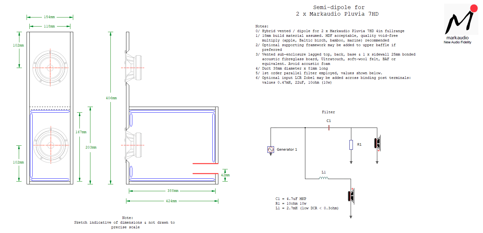

And now, at precisely nobody's request 😉 but simply because a recent thread inspired me to actually finish something I'd started about 18 months back: a mini Basszilla (or slightly larger Nova-Brio-type-thing if you prefer) for a pair of Pluvia 7HD. Since it needs a handle, I've stuck 'Cirrus' in there for no other reason than I was looking at some Cirrus clouds through the window this afternoon.
Crossover is a 1st order parallel; you may or may not need the input Zobel depending on how 'manly' your amplifier is; because of the electrical separation between the corners of the HP & LP, impedance does peak up at the XO point, so the option is there, and of course you can play with t'filter as desired. In case anybody wonders -I did look at a series filter, but the parallel network gives easier (more) control over the individual units.
