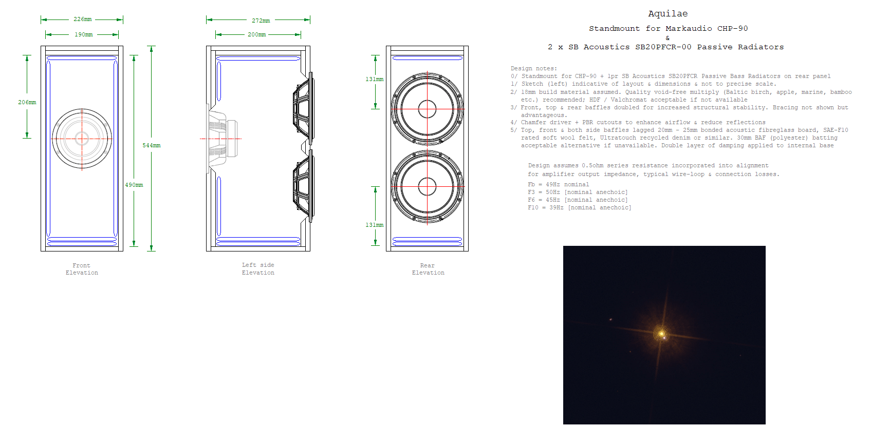

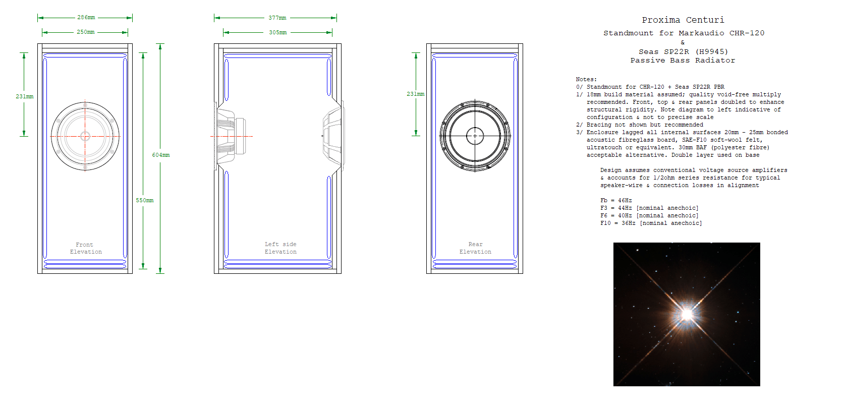

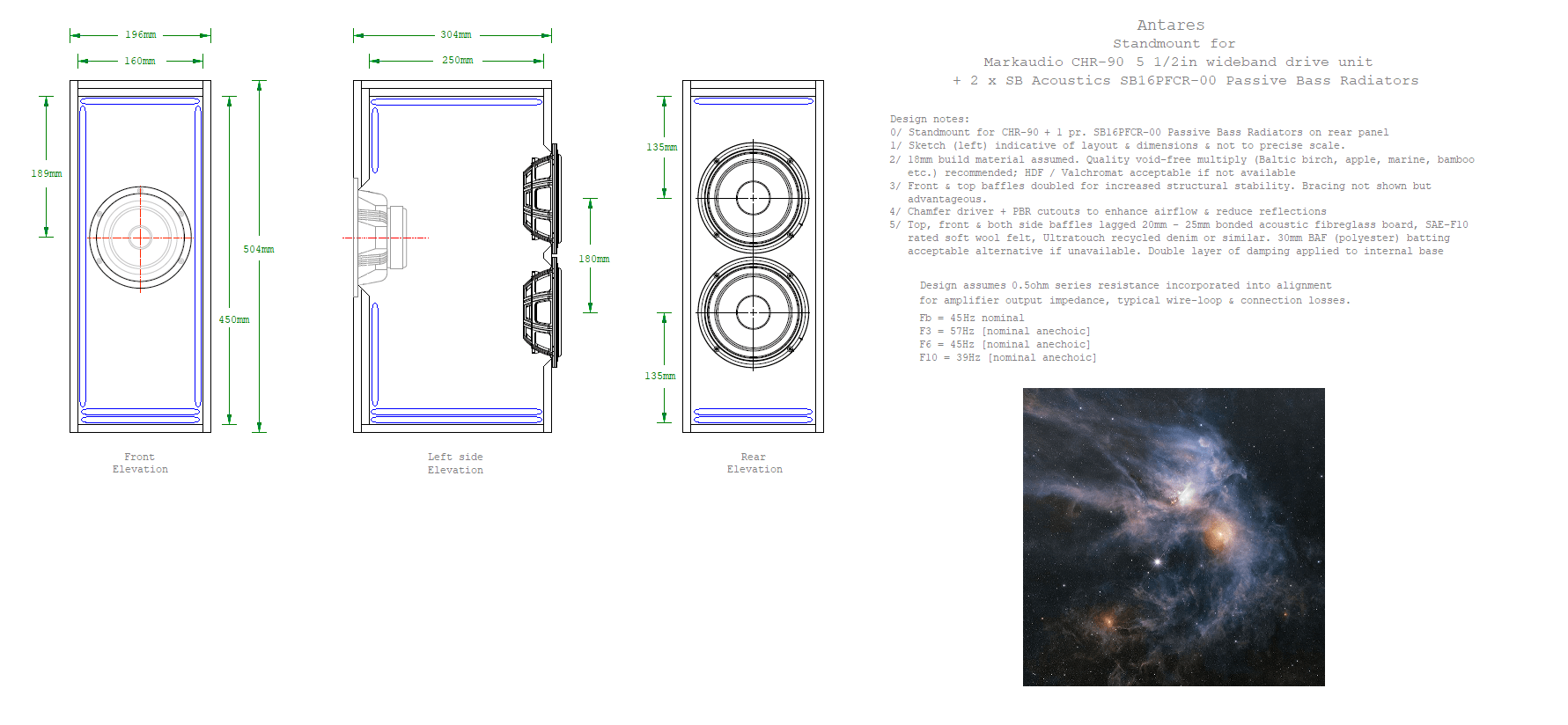

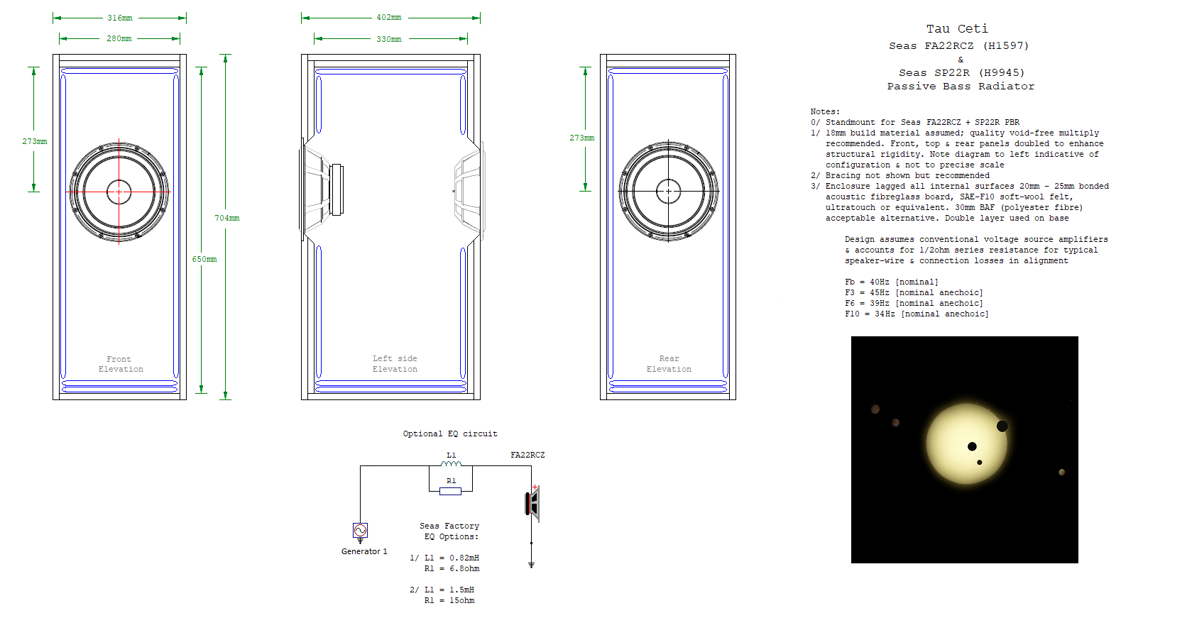

And since I'm on a theme, a variation of the same design, but using the Seas SP22R (aka H9945) & with slightly different tuning.
Reactions: 1 user

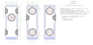

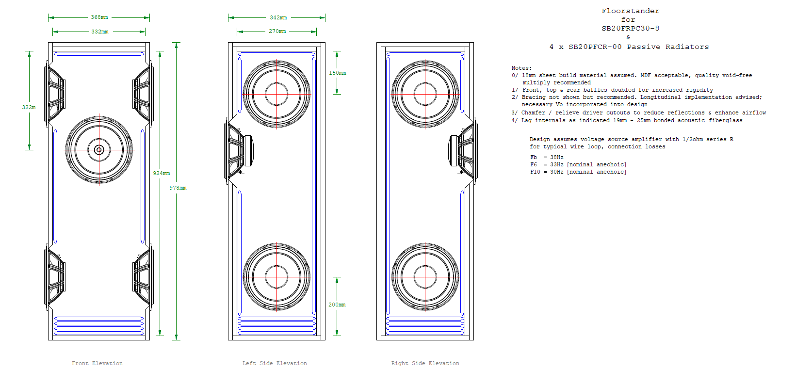

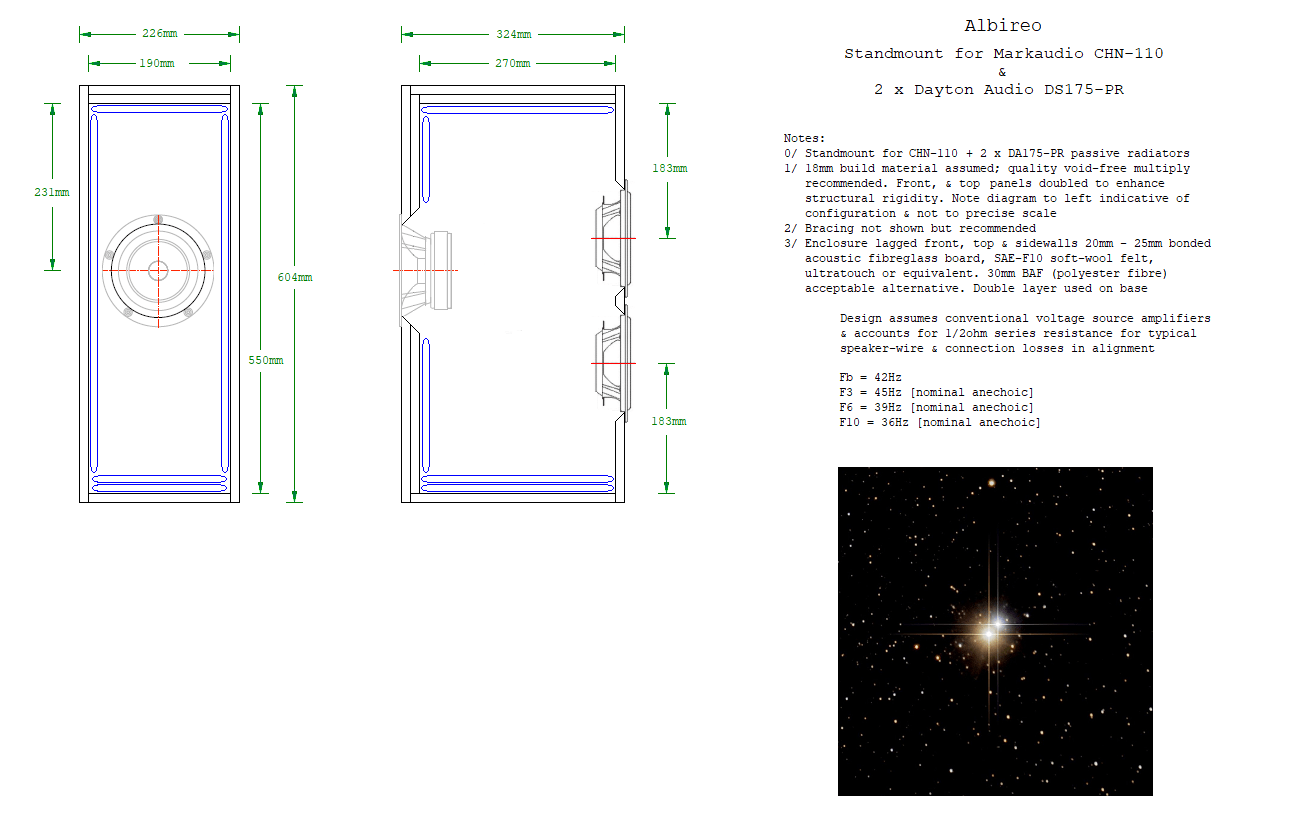

Short version is assuming they're used properly, they don't (same as vents). A longer version is that a PBR enclosure is basically the mechanical equivalent of a notched electrical high pass filter; below the knee of the transfer function it unloads initially 5th order, then bounces back up a little, exact details depending on the design, & transitions to a 2nd order. So compared to an equivalent vented box, they have slightly higher group delay -assuming a vented box is practical. Passive radiators really come into their own when you have a driver that requires an acoustically small volume with a low tuning frequency; conventional vents can be problematic in those cases as you're fighting for a balance between avoiding excessive duct length (potential for audible self-harmonics) or an excessively small cross-section (causing excessive air velocity & flow-noise). In most other scenarios, you're really using them 'just because', although there can be some potential to adapt polars more than you may be able to with regular vents, or slightly alter room interaction.
  • Thank You
Reactions: 2 users

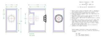

Basically exactly as I've previously described. ;) Summarizing, the primary value of an isobaric enclosure is to allow a low tuning in a reduced cabinet size -they may offer a small reduction in distortion although this is arguably six of one, half a dozen of the other as there are conflicting factors at work. Passive radiators are essentially just a vent substitute, so their main value is in acoustically small cabinets with a low tuning when conventional ducts may be problematic in either excessive length (resulting in audible self-harmonics), or an excessively small cross section (increasing the chance of flow-noise etc. due to the greater velocity). Neither of those are a problem with the original isobaric version (I wouldn't have released it otherwise), or any of the regular vented boxes I've done for the MA units; as noted they're really 'just because' -valid but not technically necessary, though given the positioning they may interact with the room a little differently, and the alignments are a little different also as there's less freedom to make adjustments. Some people just like passive radiator designs / the idea of them in general, so I'm simply giving them a few options as there aren't too many around. More or less the same applies to the Seas box: the SB is a little different in that it needed four for a reasonable alignment & box size, so since I had the numbers & plenty of clearance, I went for the distributed lateral push-push layout.
Reactions: 1 user

Last one for now as I had a few of these in the works over the last few weeks, & since I've only a handful of minutes access to my desktop at the moment, took the opportunity of finishing this one off. Slightly different this time, combination of isobaric & PBR
