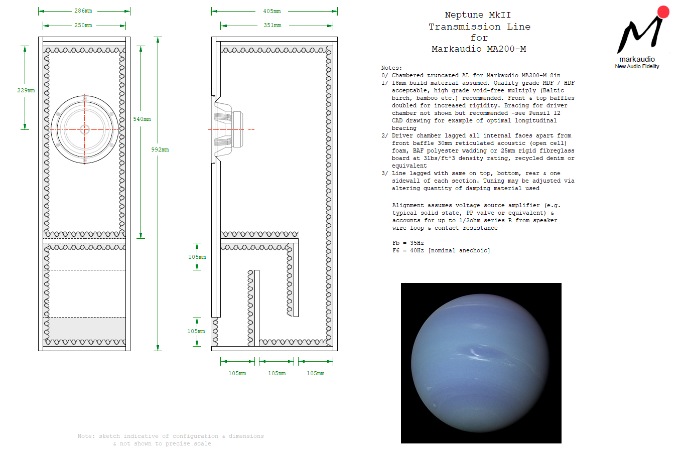

While we're on the subject (well, not really, but it's my dumping ground thread 😉 ) I was asked for a Neptune series design for MA200. Since Neptune itself was created for the now-defunct Alpair 12PW, I've recycled the name into MkII format, or the nominal series naming structure wouldn't make much sense. Bailey / Augspurger style damped LF alignment, no more than 1dB passband ripple at F3 & F5, so very much in line with those '60s - early '70s designs. Dry as a martini.
Fb = system tuning frequency.
F3 = 3rd harmonic, F5 = 5th harmonic
F6 = -6dB LF frequency
They're designed to completely different LF alignments; not everybody wants the same thing for various reasons, so the object is to provide a reasonable range of enclosures to cater to as as many of those requirements as practical.

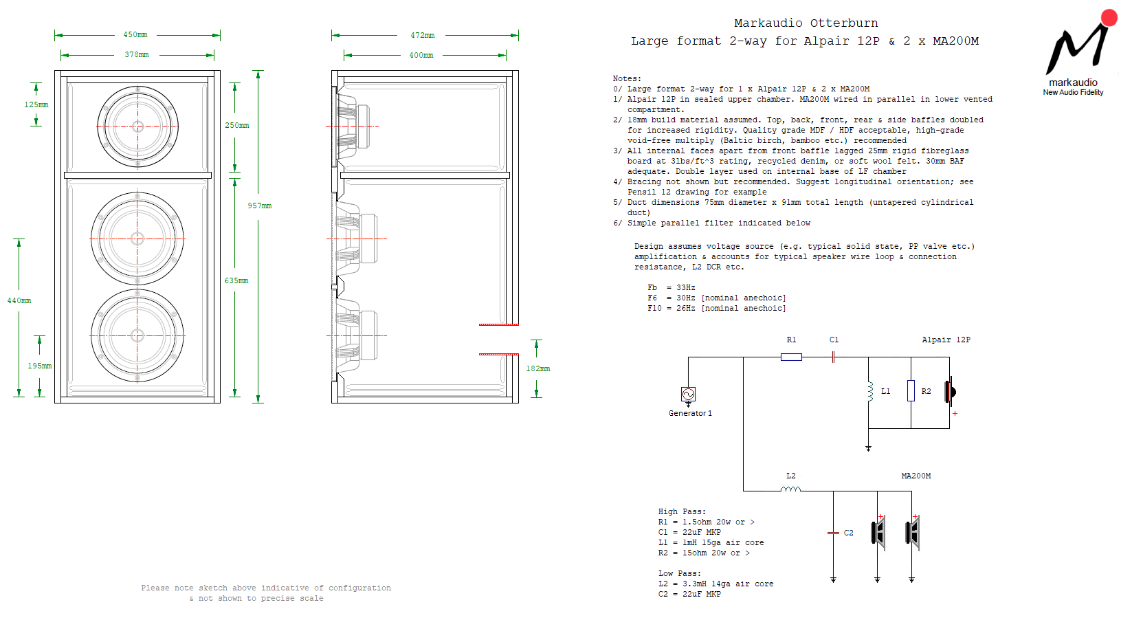

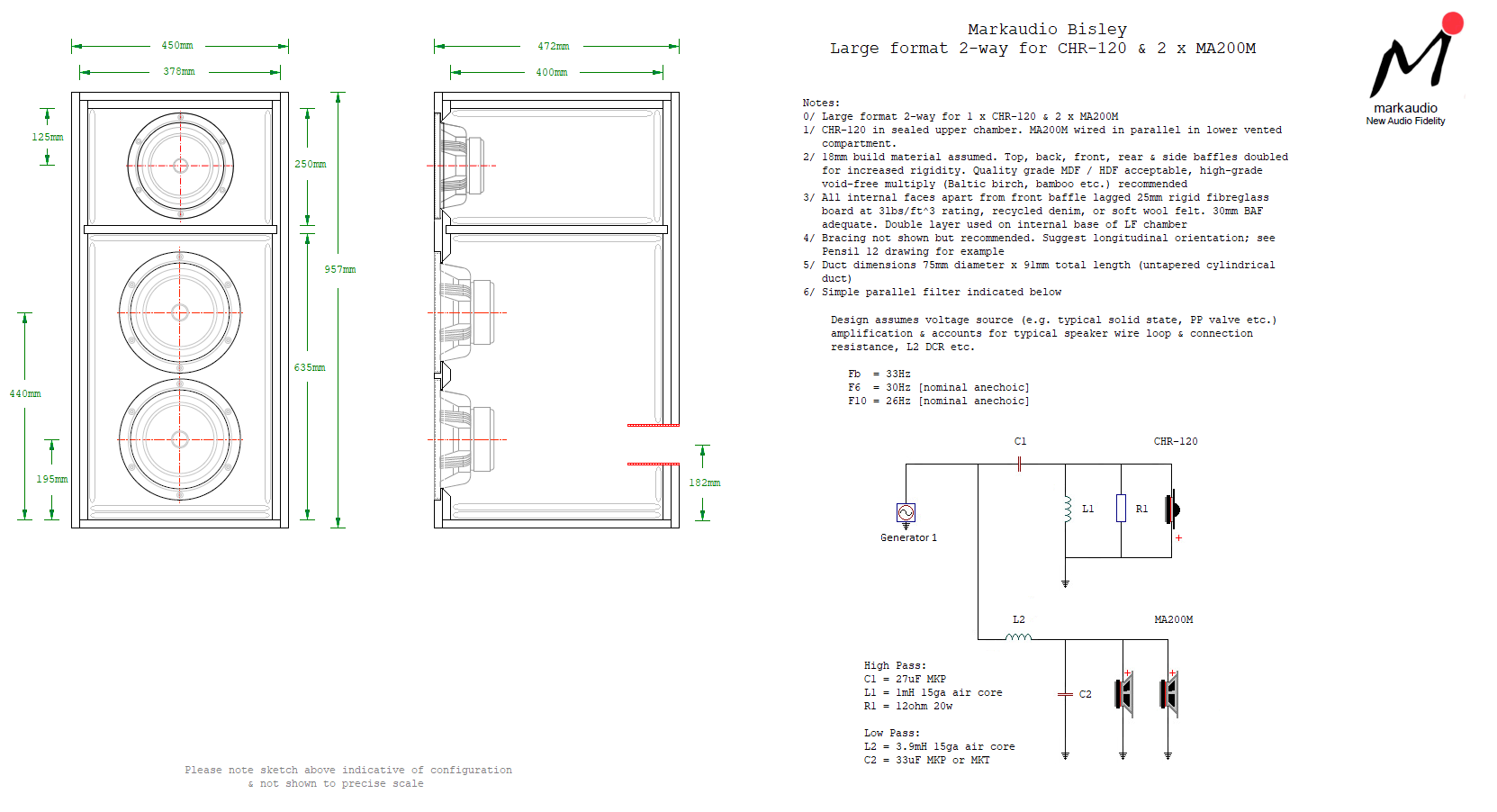

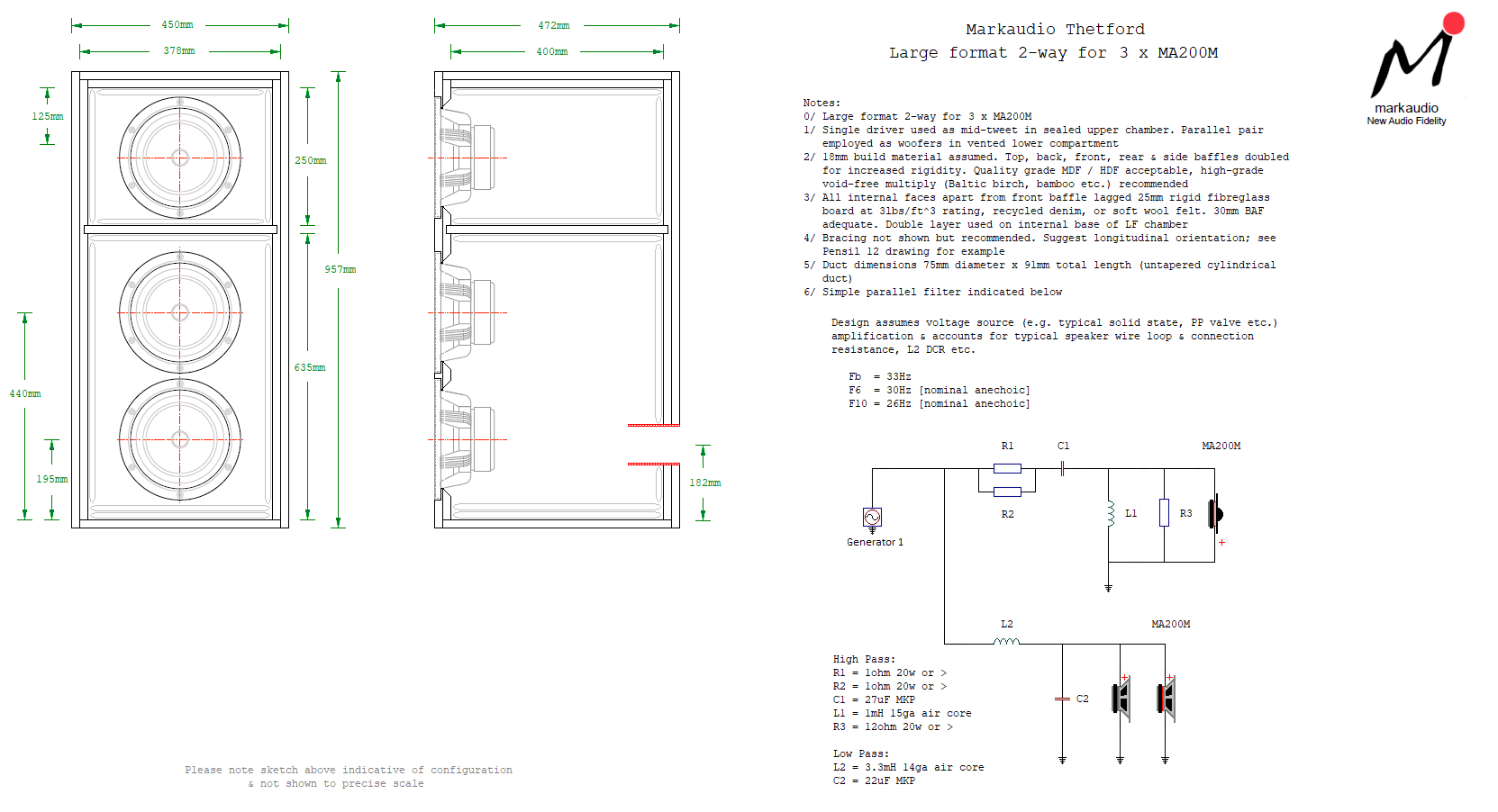

In the meantime: three simple larger format MA 2-ways for grins. Same enclosure used for each, different response balance (more LF-biased with CHR-120, roughly neutral with Alpair 12P, lurking somewhere in between but closer to the latter with MA200). Named for UK MOD artillery ranges & vaguely inspired by the evergreen Tannoy Buckingham. Amongst others. Filtering is one of my favourite trad. solutions (since these are by intent trad. type boxes) & based on an offset 2nd order Butterworth; we're targeting power-response & a relatively rich / 'vintage' balance here, so if if your priorities lie elsewhere, other options are likely to serve you better.

Writing this as a literal explanation -it's not intended to be offensive:
These designs, per my post, are specifically intended to be a larger format type. They're meant to fulfull that role / niche / set of requirements, not something different. That's why I said: 'if your priorities lie elsewhere, other options are likely to serve you better' (and visa versa). I've already done a few of those; these three are for the people who want larger units.
