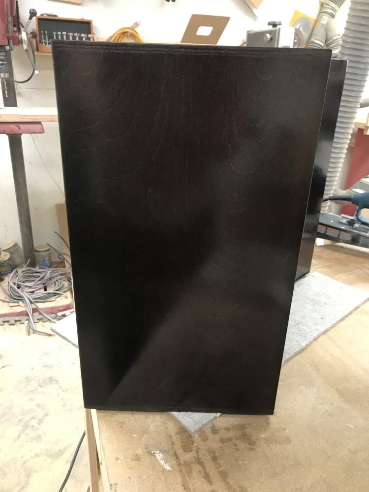

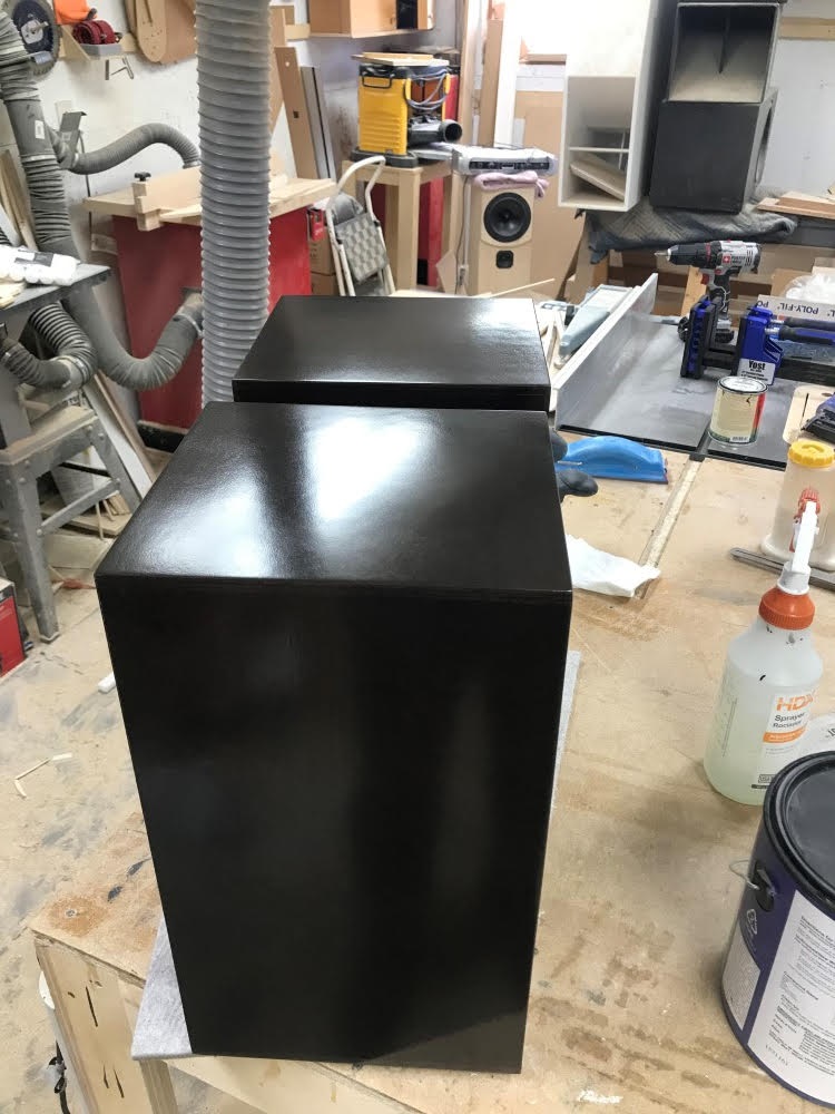

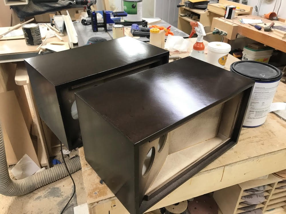

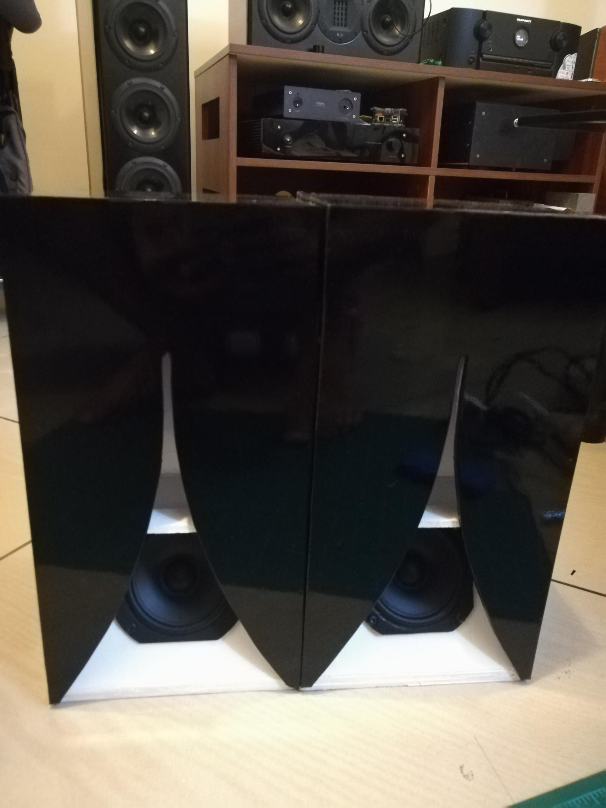

Some progress photos of my new 0.53x dual 3FE25-16 Karlsonators that I am making. Going for a deep hand-rubbed finish with espresso brown stain and 14 coats of hand-rubbed lacquer. Final coat will be satin finish though. The K-apertures will be natural blonde satin finish BB ply. These are another birthday present for my wife (the usual present from a guy who likes speakers - fourtuantely for me, she has a need for them in multiple rooms and likes the sound 🙂 ). Design is based on jhofland's plans of the set that he gave me.
X do the jhofland plans exist as plans we can copy?
Nice work, Baswamin! Those look great for foam core. How do you like the sound?
Pretty impressive gear collection you have too.
