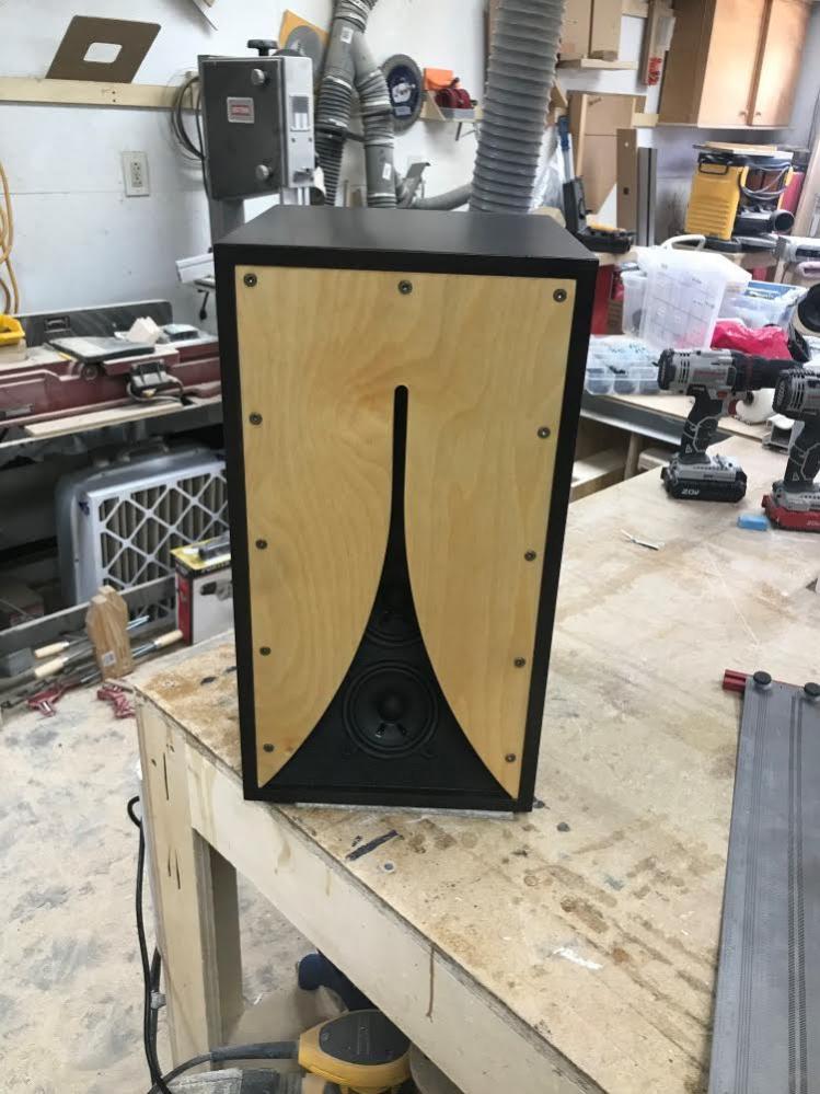

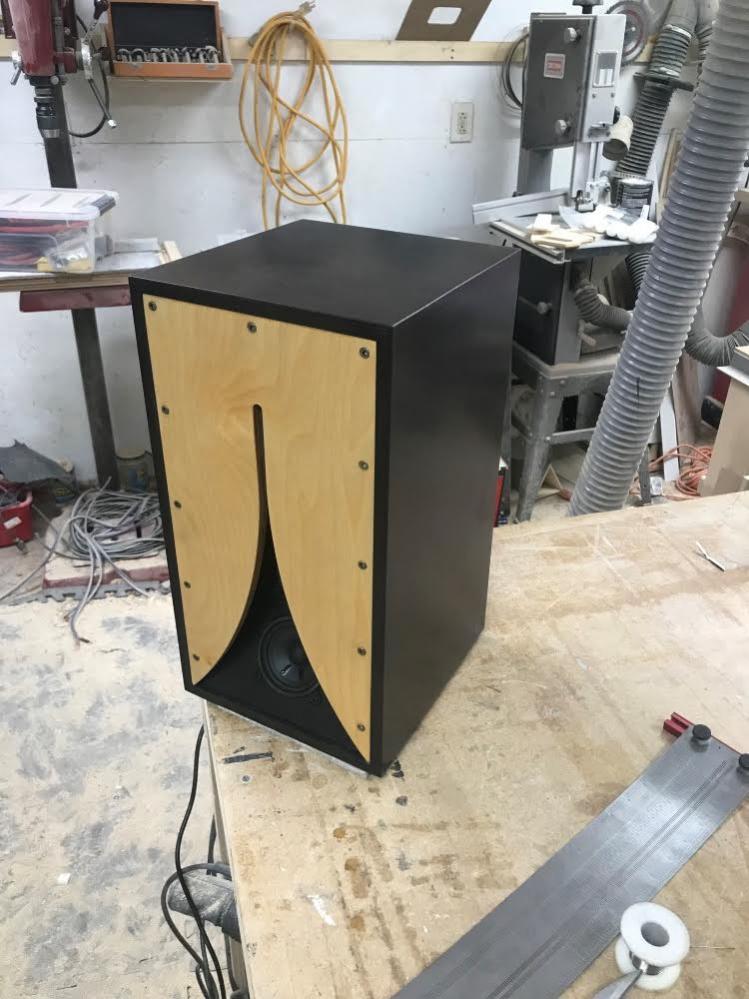

The new Karlsonators are finished. Custom tinted lacquer front apertures.
I am also getting another set of apertures made in black Duratex to allow a change of scenery, as required.
Looking great, X! Did you use the melamine sponges on the inside of the aperture? If so, could you post a pic?
The inside of aperture has a layer of foam core and inside outside chamber and inside of box has melamine sponges - just like how I did the last one. Pics already posted pages back. I forget where but it’s there - on the jhofland built speakers.
