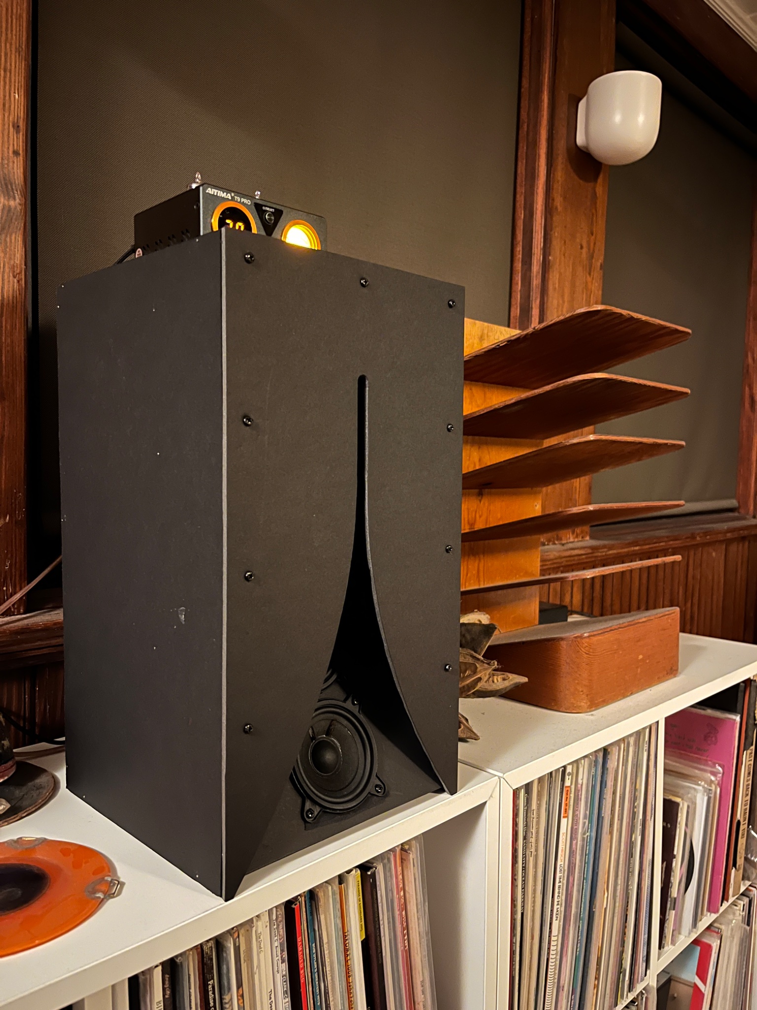

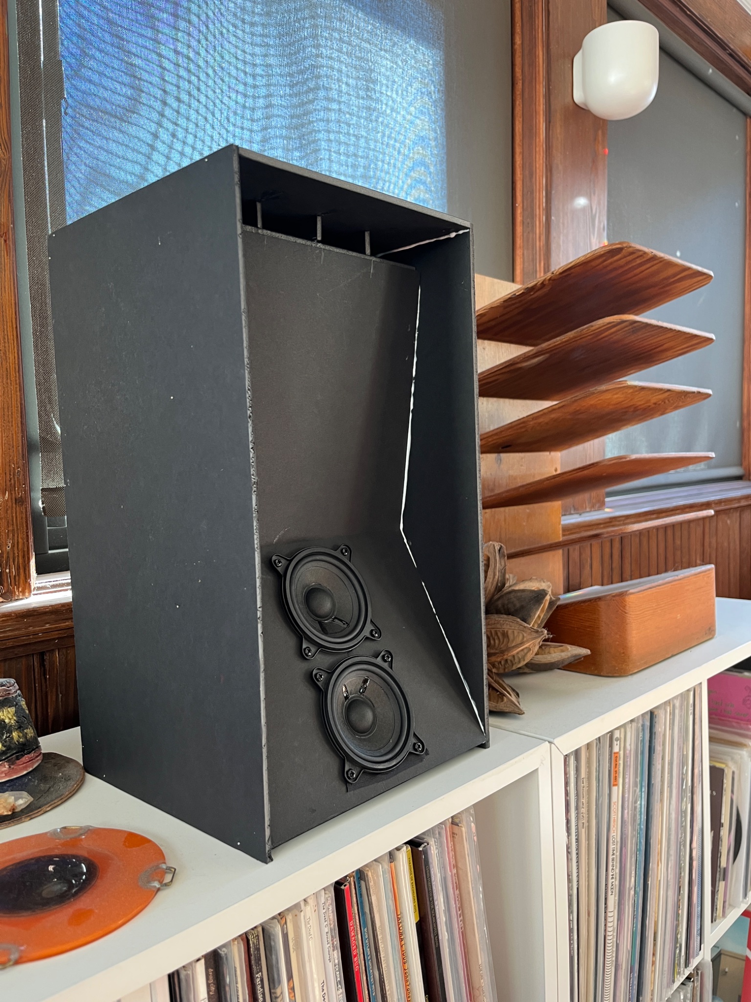

Mini Karlsonator (0.53X) with Dual TC9FDs
One fresh new 0.53 loaded with a pair of 16ohm 3FE25s. I’m debating on building an identical second or to test out a PA-130 in the second enclosure.
Boxhead Ensemble’s The Last Place to Go sounds great from the one speaker.

Enjoying the pair. Initial impressions.

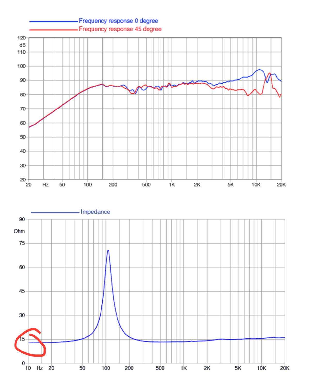

I checked the resistance of the 3FE25 drivers; they’re reading 12 instead of 16 ohms, with 6.2 ohms at the speaker terminals. Is that common? 12 seems pretty far off.
I’ve only screwed the front baffles in place. I may glue them in place since I believe I’m hearing some resonance when I’m pushing them a little bit with Daniel Villareal’s Sunset Cliffs.
I’m about ~7’ away from the speakers with an average of about 70db, hearing a wide and dynamic range easily getting down to 50hz. I’m impressed with the little Faital Pro drivers, and I’m excited to hear the difference between these and the larger Dayton drivers.

6.2 Ohms is also what I measure on mine for two drivers in parallel.

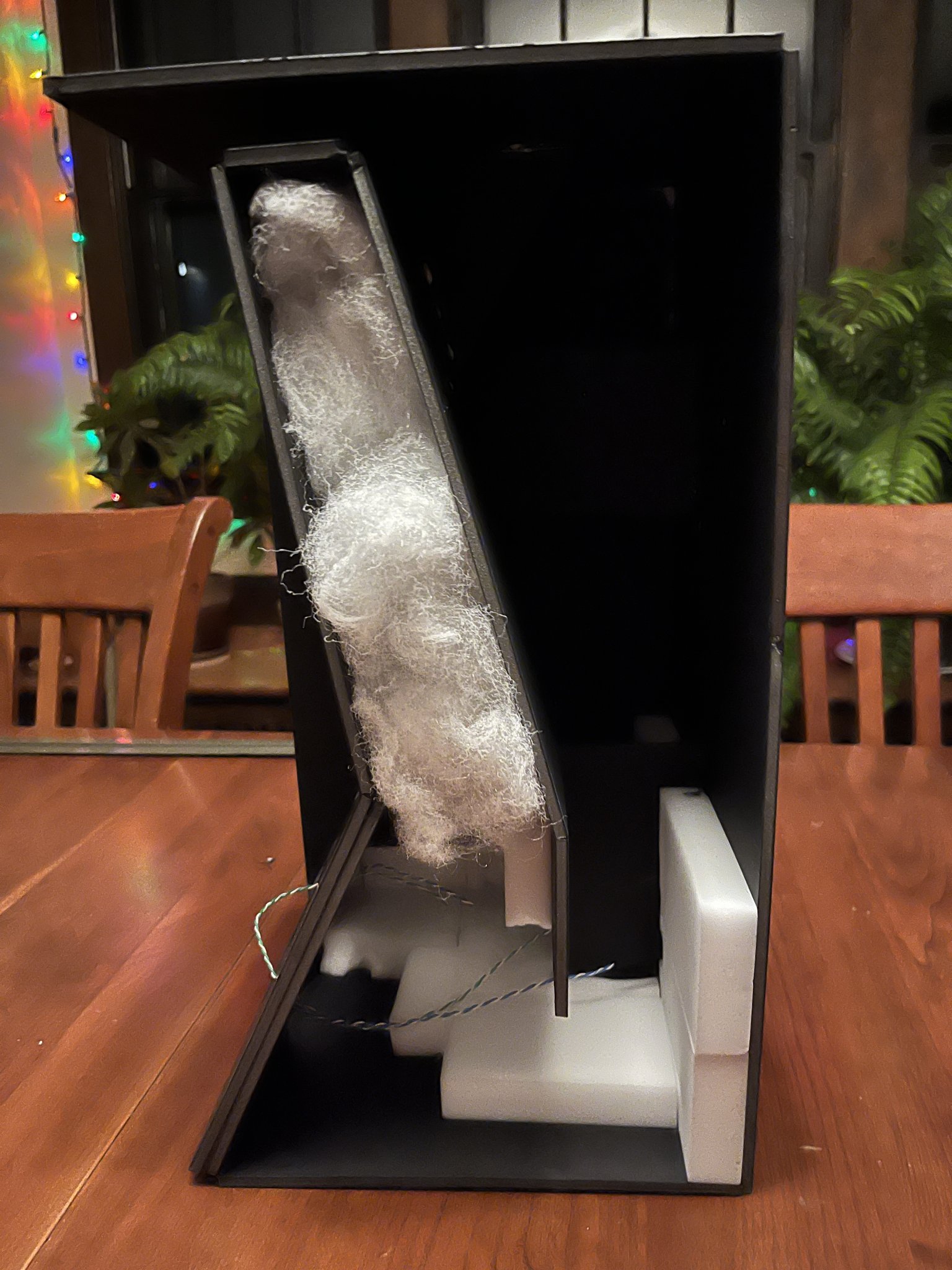

See attached picture of the finished speakers. I built them out of a mix of solid timber (side panels, front lens, top panel - ranging from about 12-15mm thickness) and 12mm hardwood plywood (everything else). They are very close to the dimensions from the plans for the 0.53x dual TC9FD version from the start of this thread - I believe I ended up about 10mm shorter and 5mm shallower due to the wood I had to hand. Stuffing was mostly as per XRK's instructions elsewhere in this thread (to help remove 'boxiness' in a wooden build) - primarily melamine sponges everywhere that faces the driver and foamcore on the back of the len, although I also put some 1/2" felt above the sponges about half way up the back cavity + on the back of the top panel, which may or may not be doing anything (I had read online that some people feel transmission lines should have materials of increasing density as you go further down the line). Stuffing of the 'stub' behind/above the driver ended up being with about 20 grams of polyfill type pillow stuffing material on each side - 'fluffed' but still packed enough that it holds itself in there and doesn't fall down.
In terms of tuning it from here, obviously I can make some changes to the internal damping (remove or add polyfill, put more sponges in), or presumably make changes to the shape of the lens - I've noticed that different Karlsonator builds people have done have slots that go higher up (sometimes all the way to the top) or are narrower or wider at the top, but I'm not sure what each of these would actually do to the sound - can anyone who has built more of these than me explain what the different lens parameters will impact?

The lens shape is a DIY tinkering option. If you make the slit go higher it will effectively reduce your TL path length so bass will not be as deep. But you will get more mods highs possibly over a wider angle. Best to okay with foamcore for the shape and then wood. Or start with cheap wood and cut away slowly until you get the sound you like. Boxy sound usually means more foam needed behind the lens. Mount melamine on back of lens and up inside the top of the outer chamber. Good luck!

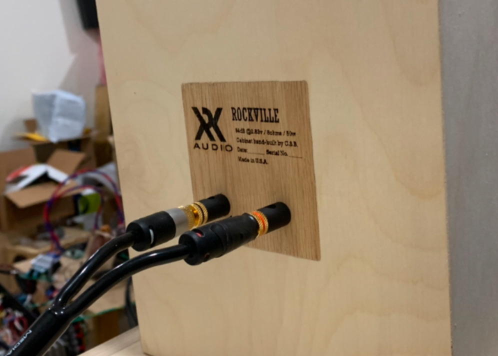

I once had a name plate for my speaker binding post plate made from antique oak timber beams from a razed Civil War era barn nearby in Rockville MD. I called the speakers the “Rockville” and later they became the commercial Galion TS Voyagers.

Re: tuning my speakers, I've since stuffed a couple of large melamine cleaning sponges up the top of the front chamber of each speaker and that seems to have further tamed the 'boxiness' (or my ear/brain is just getting used to it).
I'm not sure if you missed the further question I snuck into the middle paragraph of my previous message, re: the theoretical effects of other changes to the lens shape (slit width, lens radius, amount of driver exposed by the lens, etc.) I'm pretty happy with how things sound now so probably won't make any changes, but am curious as to how the lens actually shapes the sound.
There definitely is an effect to the shape of the lens. You can try various shapes with easy to cut double layer of foamcore etc. basic idea is that a wider opening will sound closer to the bare driver (highs and mids increased) but dispersion angle width decreased. The concept is same as why tweeters or mid ranges have wider dispersion. It’s inversely proportional to radiator diameter. So it is a balance. I have to admit, sometimes it sounds best on some drivers without an aperture. And that’s when you arrive at a folded TL with a single driver speaker. Part of the fun is to experiment. Some drivers that have a lot of in you face screech (some expensive British full ranges with whizzer cones cones to mind) can be tamed quite nicely with a K aperture to flatten that excessive midrange and steeply rising response. In well behaved drivers that are already flat, you will be depressing the response so they might be fine bare.
