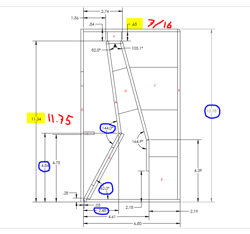

@xrk971 I am trying my first 0.4 build for TC9FD18 and while putting it together, I think I ran into some problems with the schematic. I triple checked all my
measurements and angles (circled blue). The highlighted measurements are what don't add up. I put the measurements I get in red scrawl. Am I the only one getting it wrong?
Don’t fret - you are close enough and it will be good enough to sound great. It’s quite forgiving dimensionally.

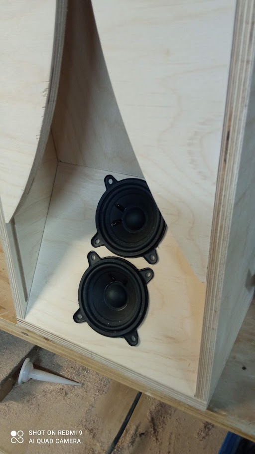

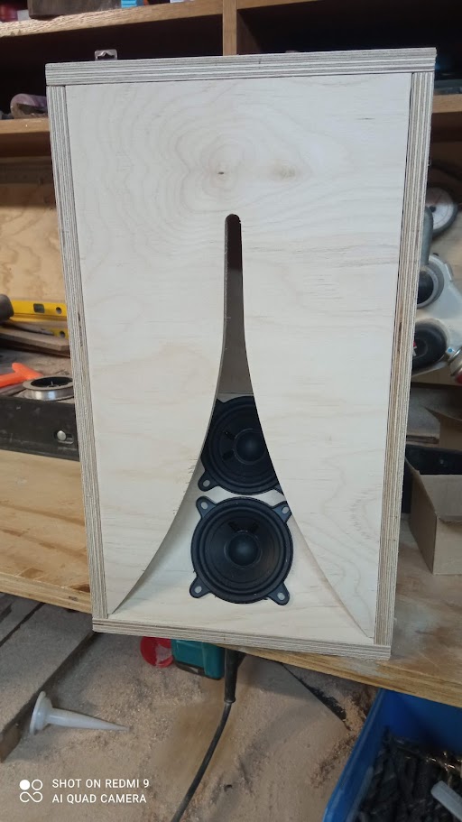

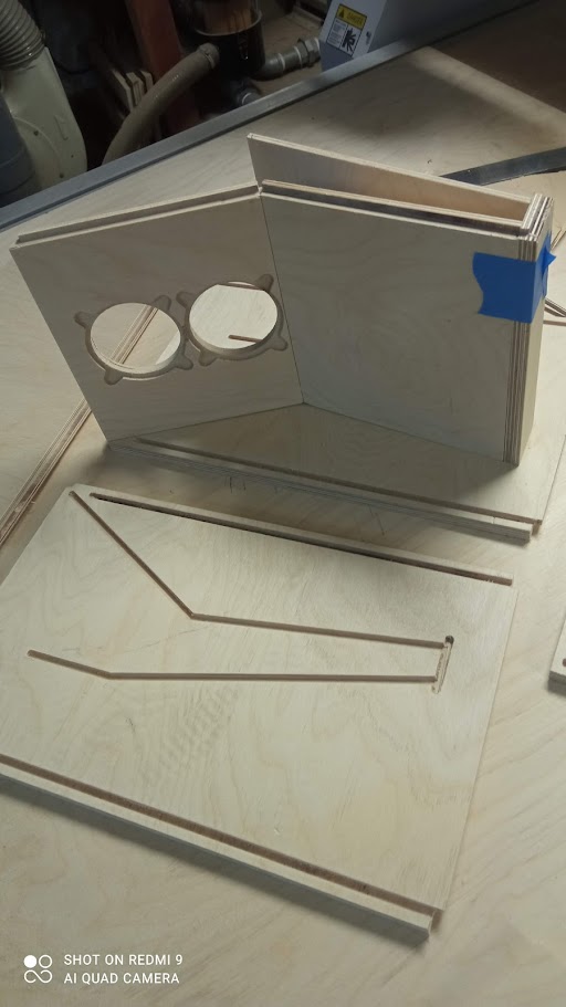

Stealing a little time from my work, I have managed to machine the box, now start experimenting with the foam and after gluing, the top cover and the front will be screwed together for possible modifications... thank you all for the inspiration.

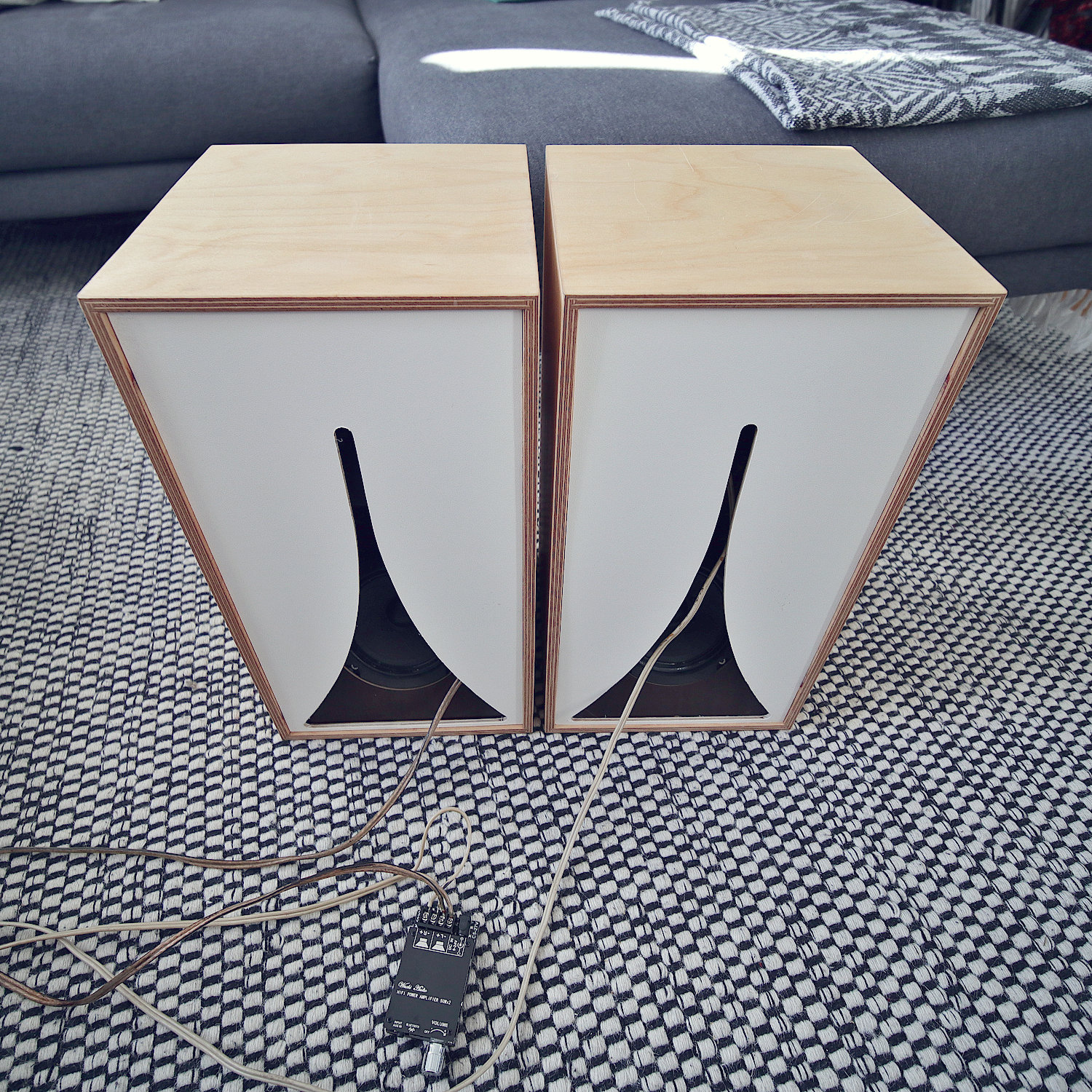

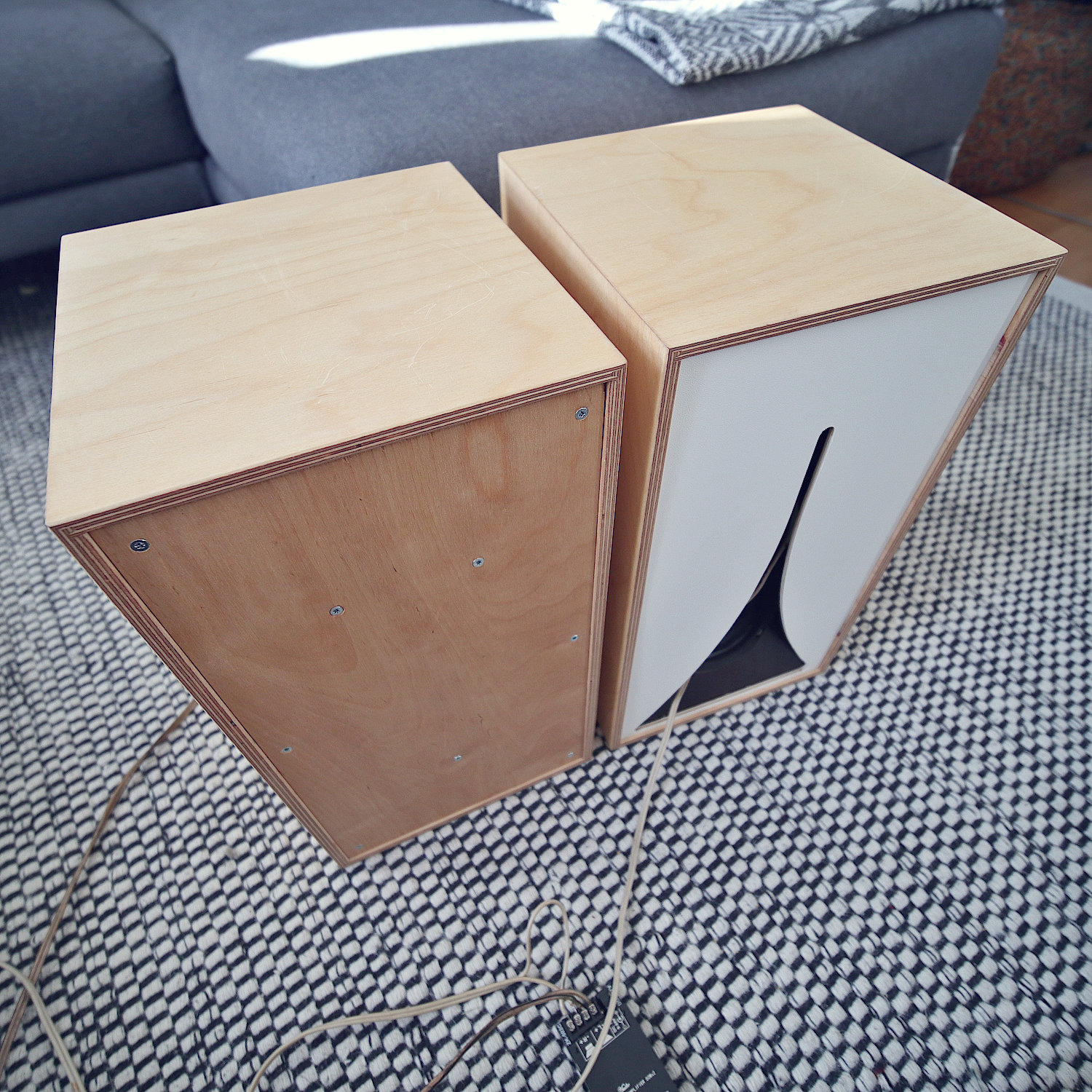

I would like to share some photos of my 0.53x Karlsonator build with PA130-8 (Faitals are not easily available in Finland). Boxes are made of 13 mm Baltic birch plywood scrap pieces. As a part time hobby, it took over a half year to construct and it still lacks some finishing.
Now, I have listened it some months and would say it is suprisingly good sounding speaker. Without any electric filter it works well with most music. Subjectively said the bass response is as good as in my Genelec 8030C studio monitors. It has its own special nature and with some audio material it feels much bigger speaker. I wouldn´t use it as only one reference studio monitor but in living room HIFI, small PA and as instrument speaker it is worth of every money and effort. Even my wife have accepted its sound quality though she regards it little bit extraordinary-looking.
Thank you very much for the idea, drawings and instructions.
