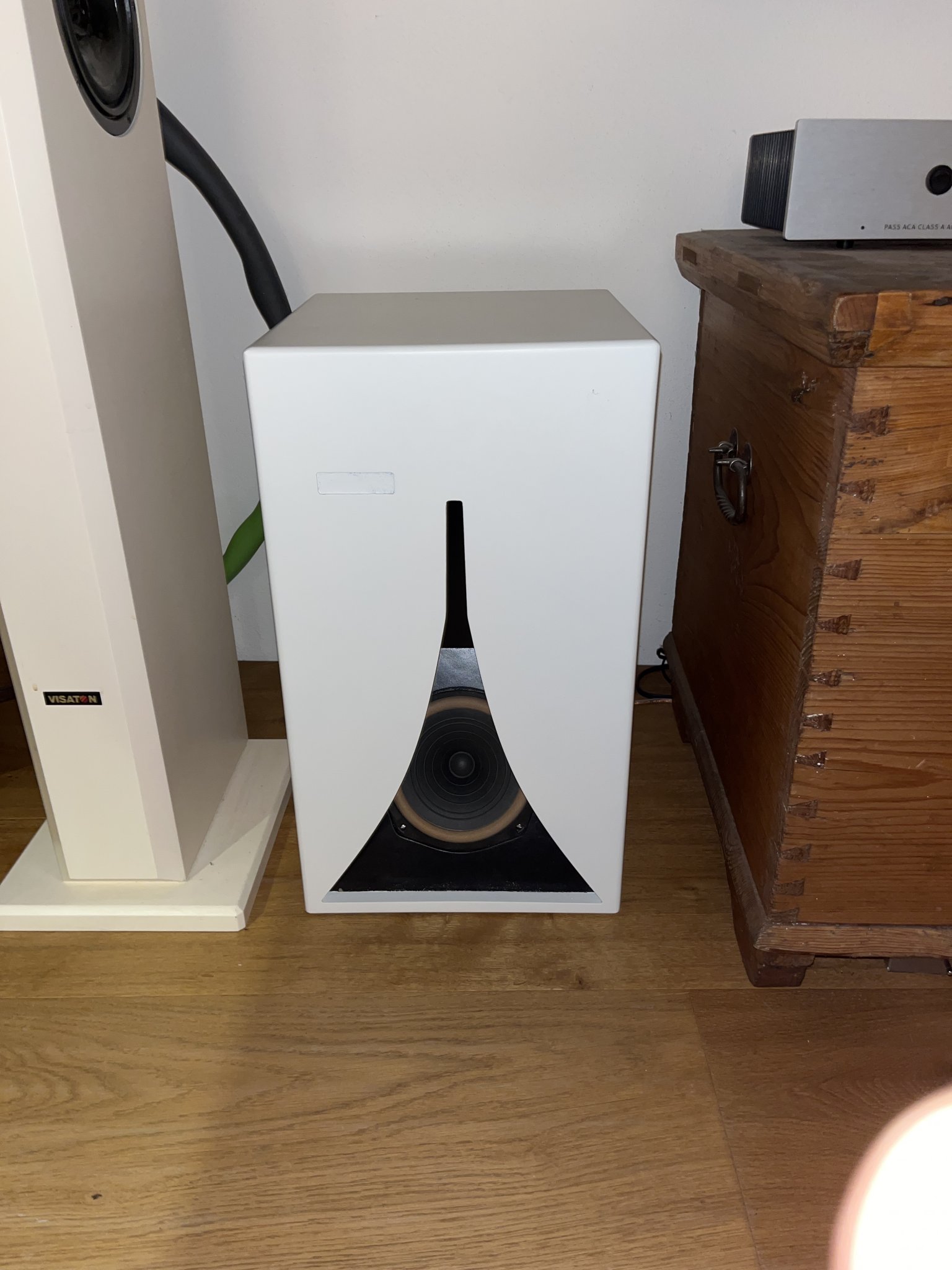

Hi Vitorio,

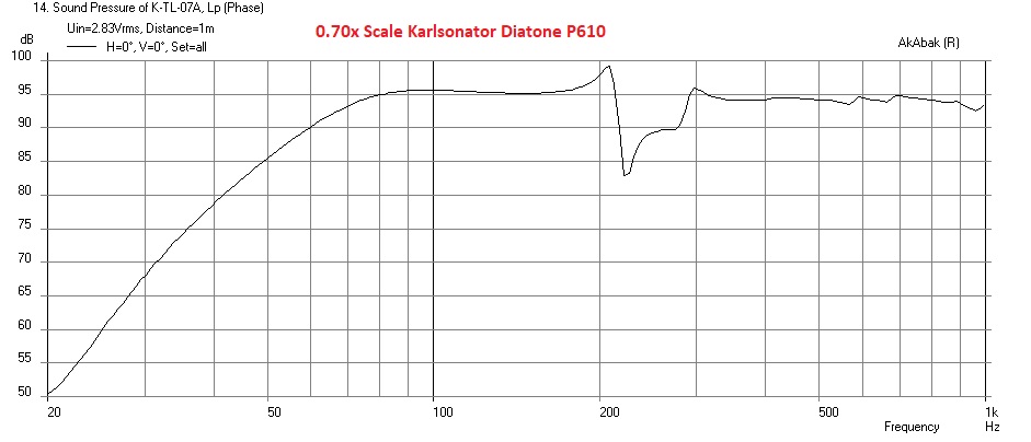

The P610 has a very soft suspension and large Vas - so requires a large cabinet to reach its full bass extension. It can work in a rather large Karlsonator and even at 0.70x scale, the -3dB is around 67Hz. The response is very smooth though and more like a "PA" response with 95dB sensitivity at 2.83v. It might be very good if assisted with a sub.
It took some time to finish and not really tested by now. Had these china p610 because some crazy horn idea, but then I saw the karlsonator and switch to that design (just build it because I liked the name 🤣).
First test was in living room with B1 + ACA… sound nice - Solti+Wagner sounded good to me…
Thanks for the design idea!
Best regards
F
Flotschi,
Very nice build and great to see a high sensitivity variant. Can you give us the link on the driver you used? If you can record some music played with your phone and upload a video on YT that would be great.
Thanks and enjoy your creation.
X
X

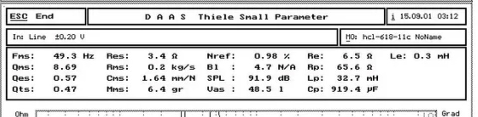

I purchased this
https://es.aliexpress.com/i/562617608.html?gatewayAdapt=glo2esp
The TSP on the picture are something different from what I measured with REW. But both speakers similar values. I remember…
I will try to make a movie and upload it to YT tonight.
Best
F

Hello xrk971, this speaker would be good on which scale of the Karlsonator?
qes 1,158
qms 3,916
qts 0,894
fs 85,46
vas 6,89L
mms 3,9
bl 2,47442
re 3,419
sd 73,5
cms 0,8981 mm/n
dd 96,8
rms 0,52960 ns/m
no 0,3610
spl 87,73
getting 59hz -10db is already great, that's what I currently get with an 8 liter bass reflex box

It looks like circa 5in driver with largish Qts of 0.894 and 8L Vas. Anything from 0.44x to 0.53x will work.
