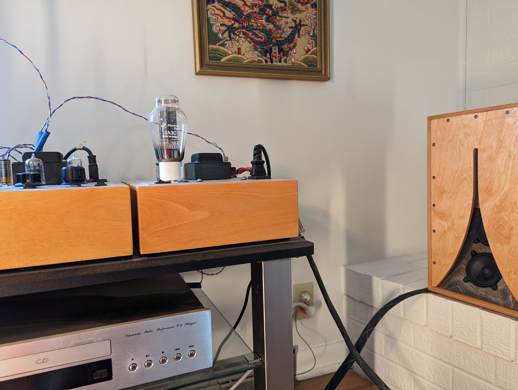

Thanks to GregB, xrk971, and jhofland for the opportunity to build a great pair of speakers. These mini-Ks with Faital Pro 3FE25-16s are an easy load for my 2A3 SE amps, and their sensitivity allows 3.5 watts per channel to drive them plenty loud enough for me. No BSC needed to get nice bass. Damping is mostly as suggested by xrk971, but I used thin melamine pad (a few mm thick) on the back of the front panel and about 75-80 percent of the interior surface, all attached using Titebond melamine glue for wood. I also used 1/4-inch by 1/16-inch foam weather stripping to seal the driver baffle as well as the back. I only put about 25 gm of polyfill above the speakers, completely teased out before placement. I've listened to YoYo Ma, Queen, Tony Rice, Miles Davis, and Ella Fitzgerald. So far everything sounds wonderful.
Thanks. I can solder wire to tabs and goober finish on wood, but the real skill was in the original design, your modeling and scaling, and jhofland's construction. The boxes were a steal at the price. I think a search for magic eraser sheets on Amazon will bring up the thin melamine I used to line these.

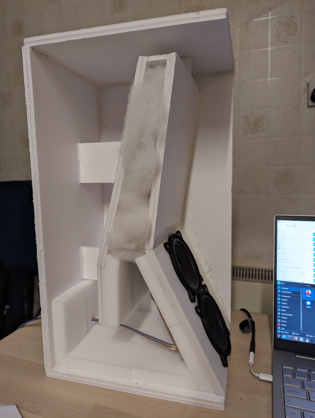

Anyone else built these with double 4FE35-8? I built a prototype with foamboard. Slightly disappointed compared with the double PA130-8 XKi's I built a few years back. Roll off quite sharply below 70 Hz and sound a little harsh. Probably over stuffed, too. I'll see if they break in and play around with the stuffing. The XKi's had chest thumping base down to the 40s.
No, I have not built with 4FE35’s. I have only used 3FE25 and 3FE22. Sorry that the bass is not as good as PA130 but a 5.25in driver will usually have better bass than a 4in driver. Your construction looks good.
70Hz sounds about right for a 4in driver though. Maybe 60Hz if you make the final vent either longer or smaller (the narrow channel section at the top). This will come at expense of lower SPL. So maybe add 0.5mH and 4.7ohm (5W) resistor as baffle step compensation. This might balance sound and make it more pleasing overall.
Thanks for the suggestions. I have narrowed to vent and it brought the bass up somewhat. I am going to build a 2nd with less stuffing to see whether that improves the sound. Considering making an xki but the Qts of the 4FE35 is high (0.83).
I tried reducing the vent height from 25 to 15 mm but it didn't extend the bass noticeably and reduced the volume significantly. I reduced the polyfill stuffing density in the tapered section to 0.7 lbs/cu ft. I calculate the volume at 2.35L or 0.083 cu ft, giving a mass of 25g or 1 oz of polyfill. I added melamine foam to both sides of the front chamber and this has taken away the hollow sound. I tried with a narrower aperture at the top (12 mm) but more punch with 15mm. Sounding a lot better.
