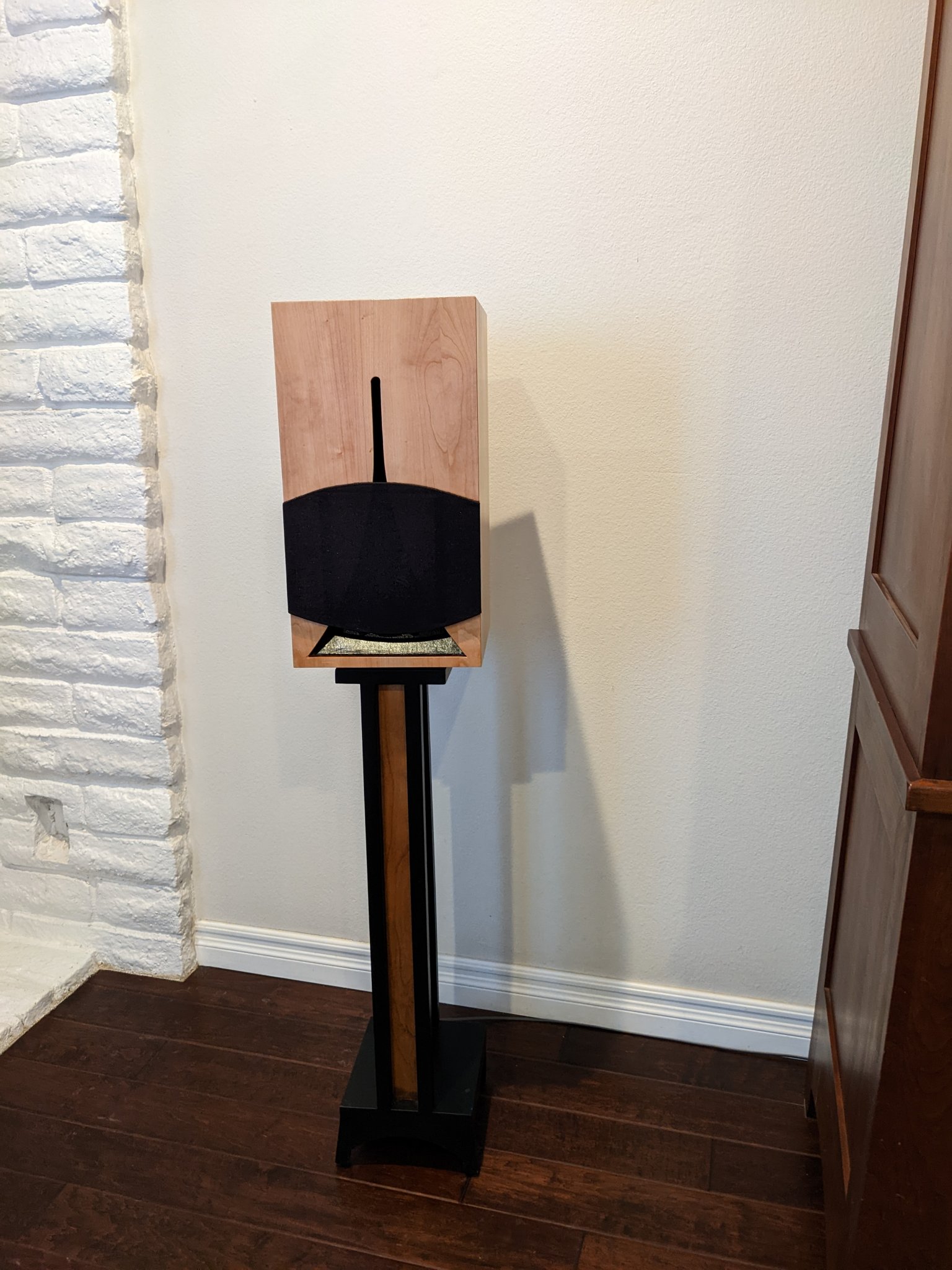

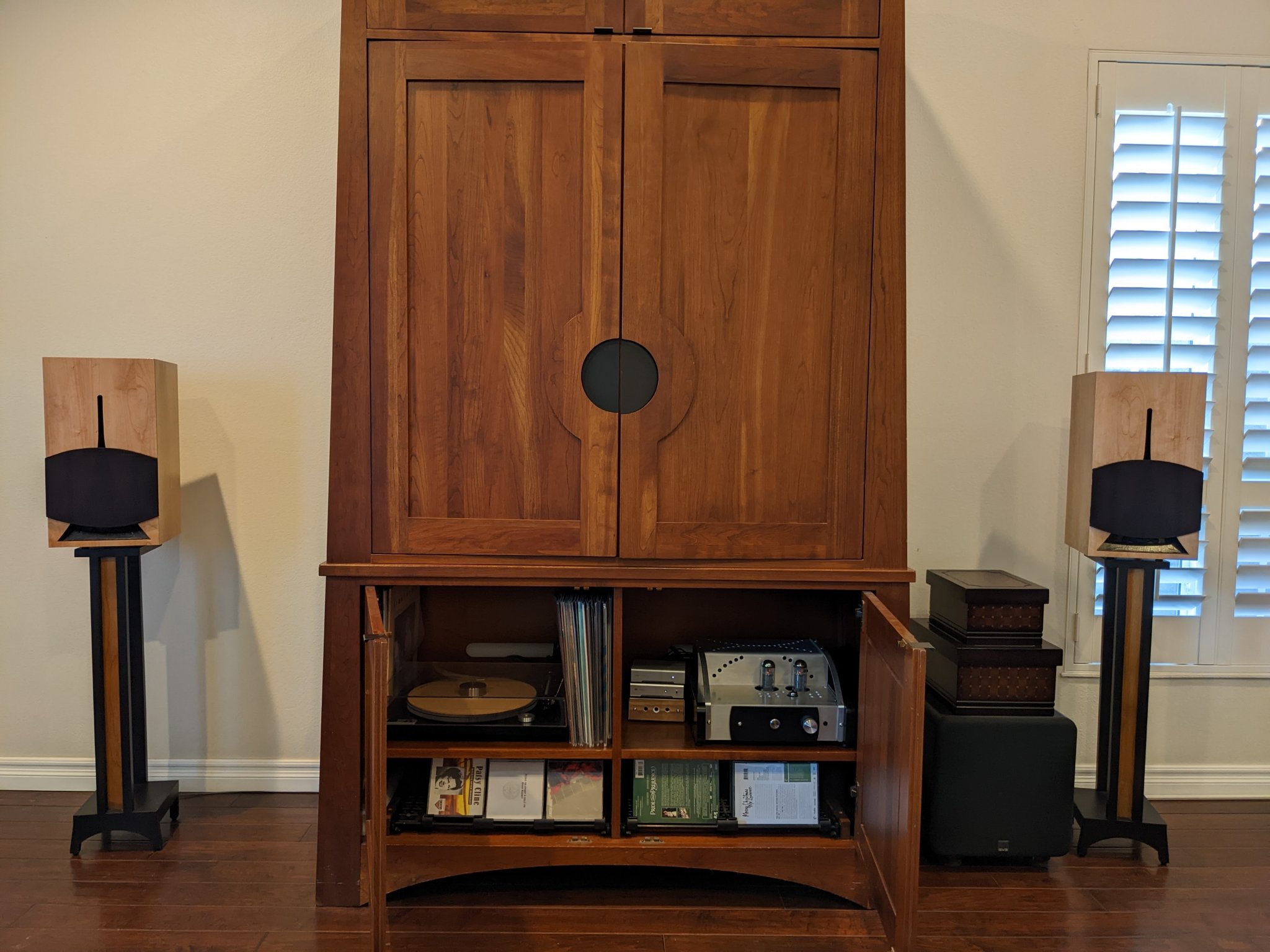

Another pair of 3FE25 Karlsonators in the wild. Thanks x for the design and jhofland for the flat pack. They are being driven by a Tubelad SSE and supplemented by a sub. Time to give them a good listen 🙂
Very nice work Spiggs! Interesting shape for the cloth grille. Really breaks up the traditional aperture shape visually. Let us know how it sounds. These are probably 93dB sensitive so should be a good match for the Tubelab amp.
Thanks x. I wanted to retain the funkiness of the apeture but felt the front with just the veneer was a bit too much. I'll report back after getting them dialed in.
If these do the job in my living room I have a set of the Fane 12-250tc that I will try in a karlsonator next.
